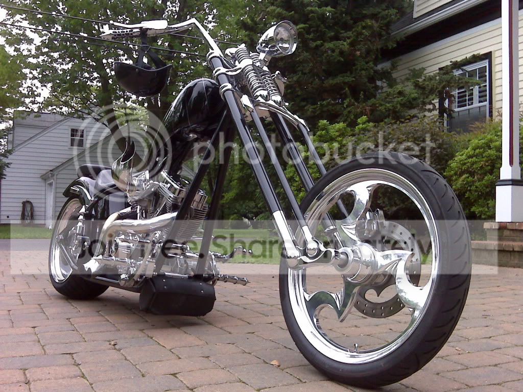

I got the handling all sorted out. Before I took it on a road test, I checked and double checked every bolt on the bike to make sure nothing would fall off. Well, what I didn't check is my tire pressure. My rear was dead flat, like 5 lbs in there, and the front was about 20. The scary thing is that my dumb ass took the thing to 70 MPH like that! Anyway, after putting air in the tires, it handles great. It does occilate at speeds over 70, but not a wobble, just a little rocking back and forth. I fixed a few little leaks and sorted out some loose wires behind the coils, and everything has been running great. I tried to get a HIEM for the front brake bracket, but they won't fit, there isn't enough clearance for the head. I'm going to keep an eye on it, and if it gets fishy, I'll make a bracket that bolts up to the brake so the HIEM will fit. Here's a pic I took today:

Fantastic front end, looks the bizzzzzzzzz. But where did you get that cool looking air intake.

Stainless Creations Intake. Runs like shit unless you take the filter out and run it open. I've heard rotating it to point forward will fix the problem, but I never tried.

Damn...that's my dream front end Moe. Nice work. The only reason I've held back is people complaining about handling and the reliability of the American Dragon Suspension. I like to take my dog on loooong walks and so far I have no issues with my bike at all...I'm afraid I will open a pandora's box if I mess with the front end. Would you do it again?

No problems on handling, springers are very neutral if you set them up right, no matter what your rake. Al had a problem with the brake bracket failing, and unfortuantely the way it's setup there is no room to use a proper HIEM so I'm keeping a close eye on it. It really looks sharp though and I'd do it again in a second. Electrical is great, beats the shit out of the EHC and mess of wires that BD uses stock. I like simple it's so much easier to work on and troubleshoot. Only thing I'd do different is I'd goto 50 degrees of rake, 46 wasn't enough!

Looks good moe, frame looks pretty level. You should pick up some of those chrome saber covers for the fork legs, would look good with the black mamba finish.

The one pictured on the website is for the inverted front end but as shown on mine they do make them for the springer, just call Ted up.
