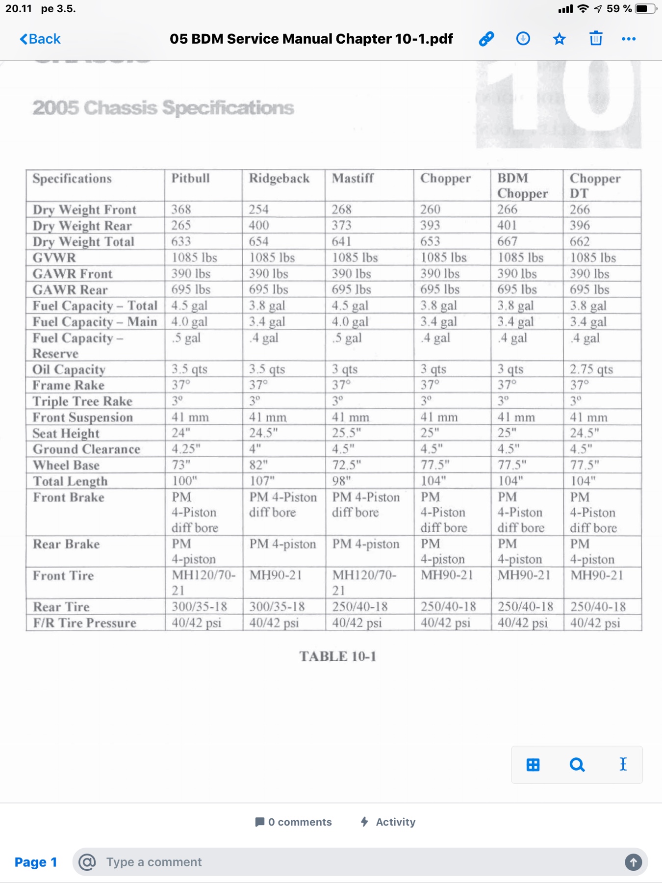

Looking my manual you are somewhat upside downFWIW, I just had to go out and measure my 2008 Ridgeback distance to the bottom of the frame standing straight up and nobody sitting on it and it was about 4.5 inches. This matches the owners manual frame height of 4.5 inches.
It also listed the frame height for a mastiff of 4 inches.
2007 give 4” too... I thought they have same frame 06 and 07. Maybe the jig was “bit tired” by 2007I was looking at the 2008 specs which are right side up!![]()

Same frame different swing arm. 2006 had the 250 rear tire and in 2007 they went to the 300 rear tire.2007 give 4” too... I thought they have same frame 06 and 07. Maybe the jig was “bit tired” by 2007![]()
