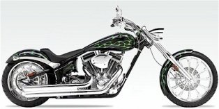

Took some more pictures and went to a website that told ke the height difference just in tire size. The 21 inch wheel on my bagger is running a 120-70 the 23 on the mastiff is running a 130-60. The site says theres a 1.53 inch difference in just the height of the tire. And here are some more photos to so the difference in how the bike is. 20190503_165003.jpg 20190503_164947.jpg 20190503_164928.jpg 20190503_164842.jpg 20190503_164811.jpg 20190503_165003.jpg 20190503_165003.jpg 20190503_164947.jpg 20190503_164928.jpg 20190503_164842.jpg 20190503_164811.jpg 20190503_164649.jpg

So bigger tire rises the front axle about 0.8” forks are more or less 45 degree angle, that means triple tree rises about 0.5”?
It the shop installed 2” shorter tubes the front should be lower than original. ...Your pic says it 1” higher. Is Mastiff frame supposed to be horizontally even? If yes my logic says someone is bullshitting someone. You sure they didn’t install 2” longer tubes?

I'm thinking the shop left original fork tubes on installed the 23 inch wheel with this tire raised the rear shocks to make the bike ride level and gave it back to me even tho they say they compensated for the wheel.

This is gonna be hard to explain, but you actually only lifted the front of your bike 3/4 of an inch. That's why something else is wrong. The shop put longer tubes on or something. The first number is the width of your tire in millimeters. The second number is the profile aspect. It's a percentage of the width. So your original mastiff tire, which is the same tire on my pitbull and your bagger is (120÷25.4)×.7=3.3 inches high. You 23" tire is (130÷25.4)×.6=3.07 inches high. Yes, the 23" tire is 1.5" taller because 3.07+3.07+23=29.14. Your original tire is 3.3+3.3+21=27.6. But you only gained half of this in heighth, because it's from the axle to the ground. You gained 1" from the rim, but lost 1/4" in tire profile.

I understand what your saying there. I know the mastiffs came with +2 inch tubes originally. So you're thinking I now have +4 inch tubes?

I'm not sure. As I said in an earlier post, I put a 1" block under my front tire and it made very little difference to me. You only gained 3/4" so there should not have been much difference with the original tubes.
My question is what do I need to do to get the bike back to the original ride heigth. And what is the orginal ride heigth.
You will really need to just take the tubes apart and measure them. Then we should be able to help you with the math. I think what we need to know is what tubes the guy used, he said they were right, but obviously not.
It's overall a pretty easy and not very expensive fix just will take some time. New tubes will only be about $150. Will need new fork seals too as you gotta take the lowers apart to measure the tubes.
If you don't measure the tubes, we will just be guessing what ones to order. And maybe just going back to stock tubes will be your best option because if you go with 2" less tubes it will be even lower than stock height. You can get custom tubes made but obviously would cost a bit more.
You could also fairly easy just cut the tubes you have down with a pipe cutter. That may be a great option at this point. Saves money and then you'll know for future reference.

Manual says ground clearance is 4.5” on pic your bike is leaning left, so its hard to say what you have. Not far from that it looks like.
Looking at pic
it does kind of look like there is bit more ground clearance in front...
I wouldn’t do anything to the bike. But take it for a spin and show everyone, “look my new big wheel”. You’ll get used to more like 0.5” difference in 2 miles. I would think. Or start burning money, your pick.
You can always put a 2by4 on floor and rise rear tire 2” look how that looks. I suppose that more or less equals 3.5” shorter front tubes. Or you have 1” whatever use that. Should be pretty close.
I’m too lazy to start playing with geometry... but frame angle is 37 deg, neck is 3 deg.=40 degrees. You’d still need total length from neck to axle to make precise calculations...

Well as you can see in the picture of the kickstand the whole frame is sitting higher. The bagger and Mastiffs kickstand both should be at the same height when the bikes are being stood up but yet you can tell there is a big difference in them. Even if I were to lower just the rear of the mastiff then the bike would seem to be riding up hill.

There also are different length kickstands.. measure the frame bike standing up. Is it 4.5 at lowest point?
