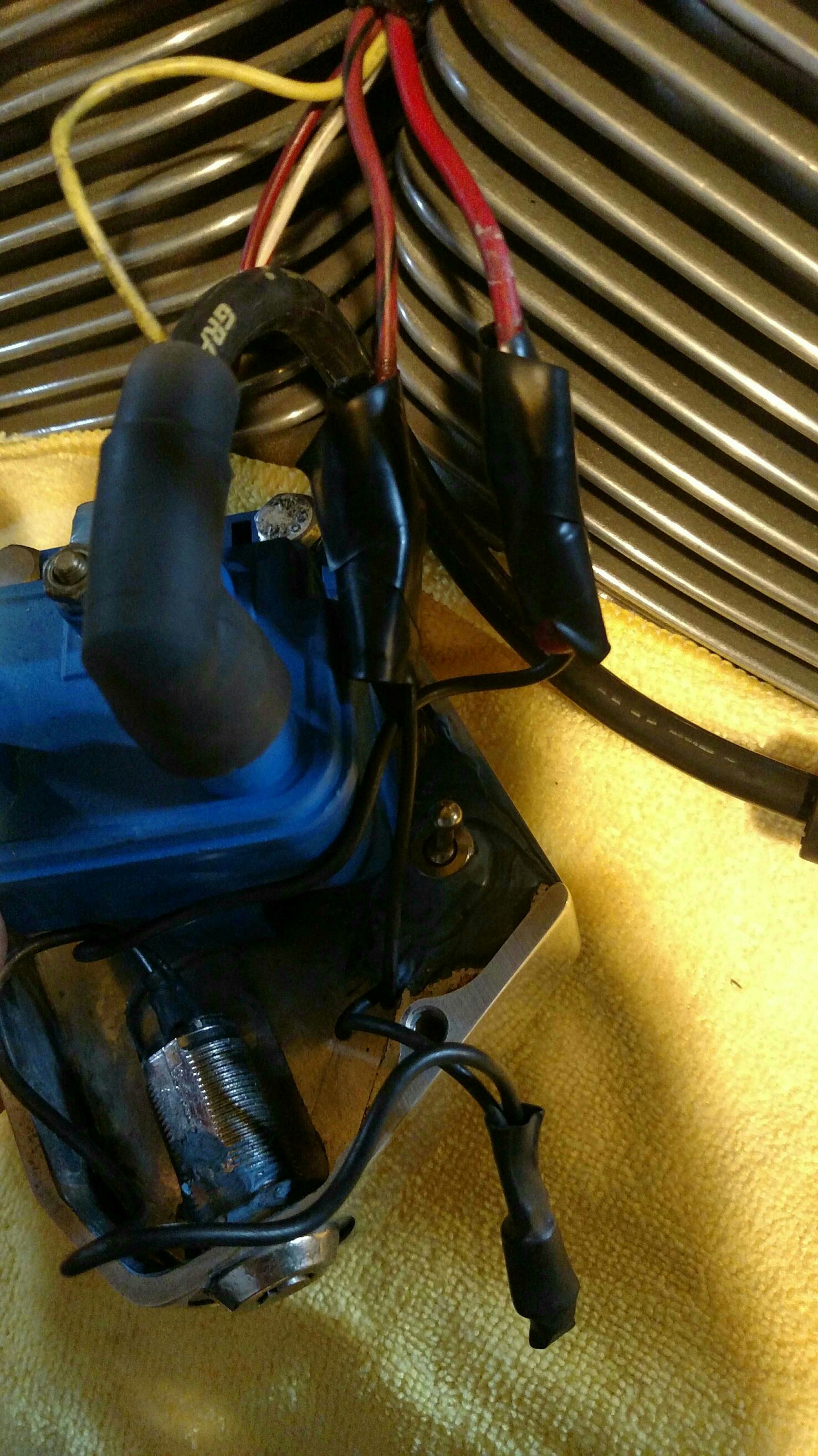

Just curious what are those ground wires going to under the ignition box?

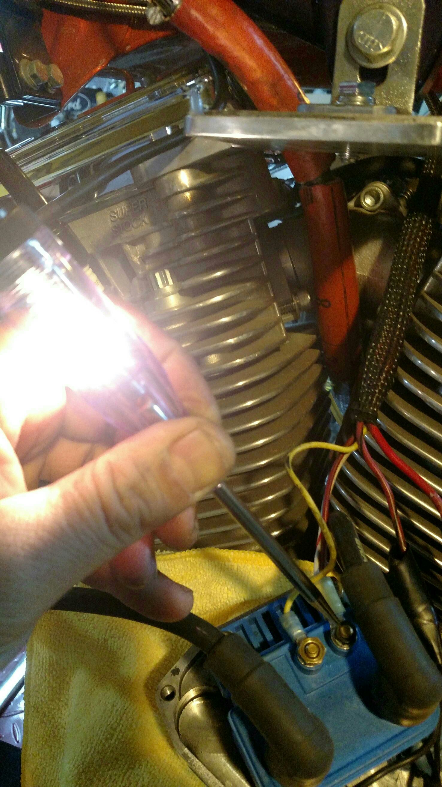

Grab your trusty multi meter and unhook the power to your ignition box and see if you have +12v when the handlebar is in the RUN position. Put the meter on the red hot wire coming in and the dedicated black ground wire. Lets see what you got there.
Honestly, what you have for an ignition setup is extremely reliable. You are welcome to put a new one in but I betcha what you go works. Loose wire or connection somewhere.

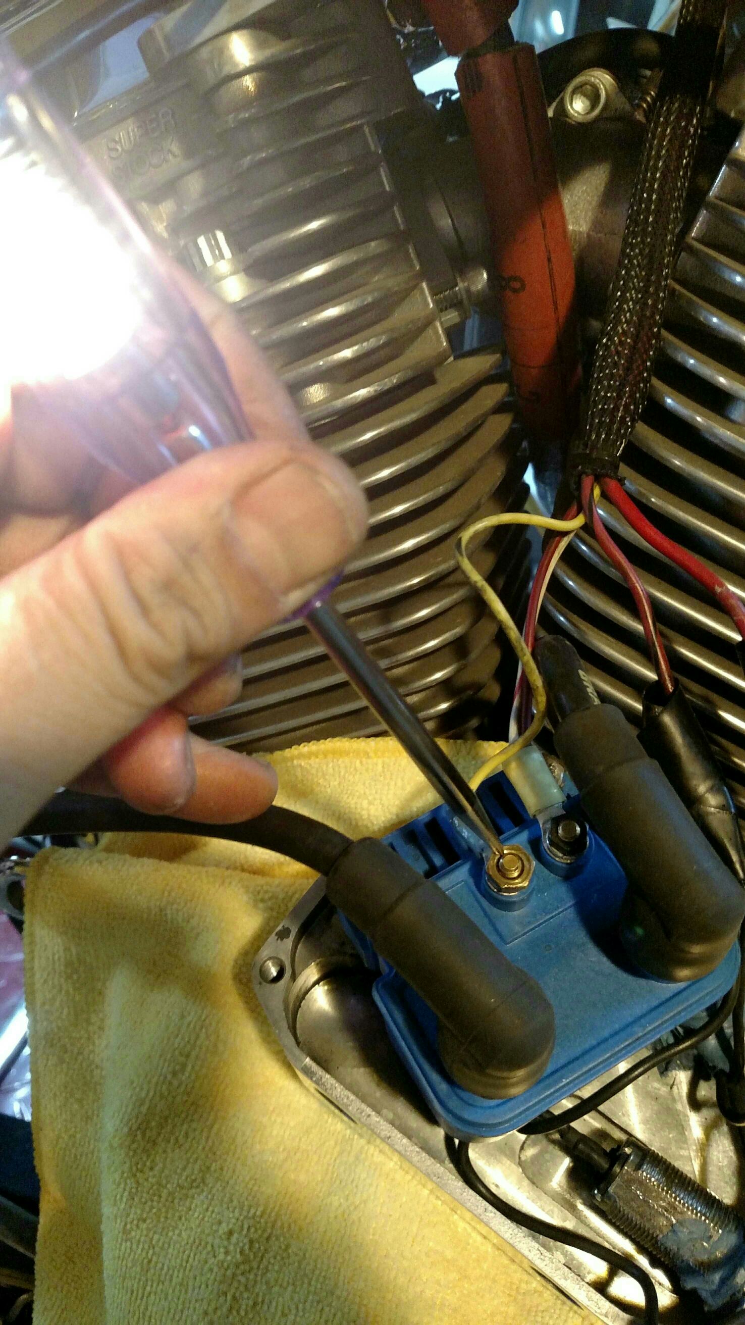

Ok what I have is power on both terminals with the ignition is on.
My red light is still not on but I do now have spark
I changed the wires around on the coil and we're get spark on both cylinders

Those wires are a bypass from the key and to a switch.
No key.

Yes my run switch gives power to the two wires on the coil as
Pictured

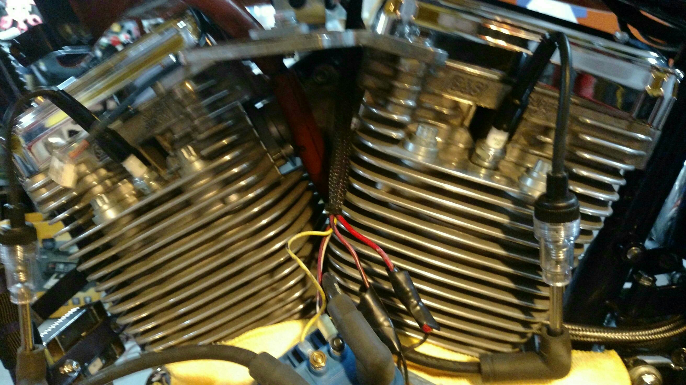

Yeah copy I checked those connections there soldered and twist capped on.
I used heat shrink they're good now.
