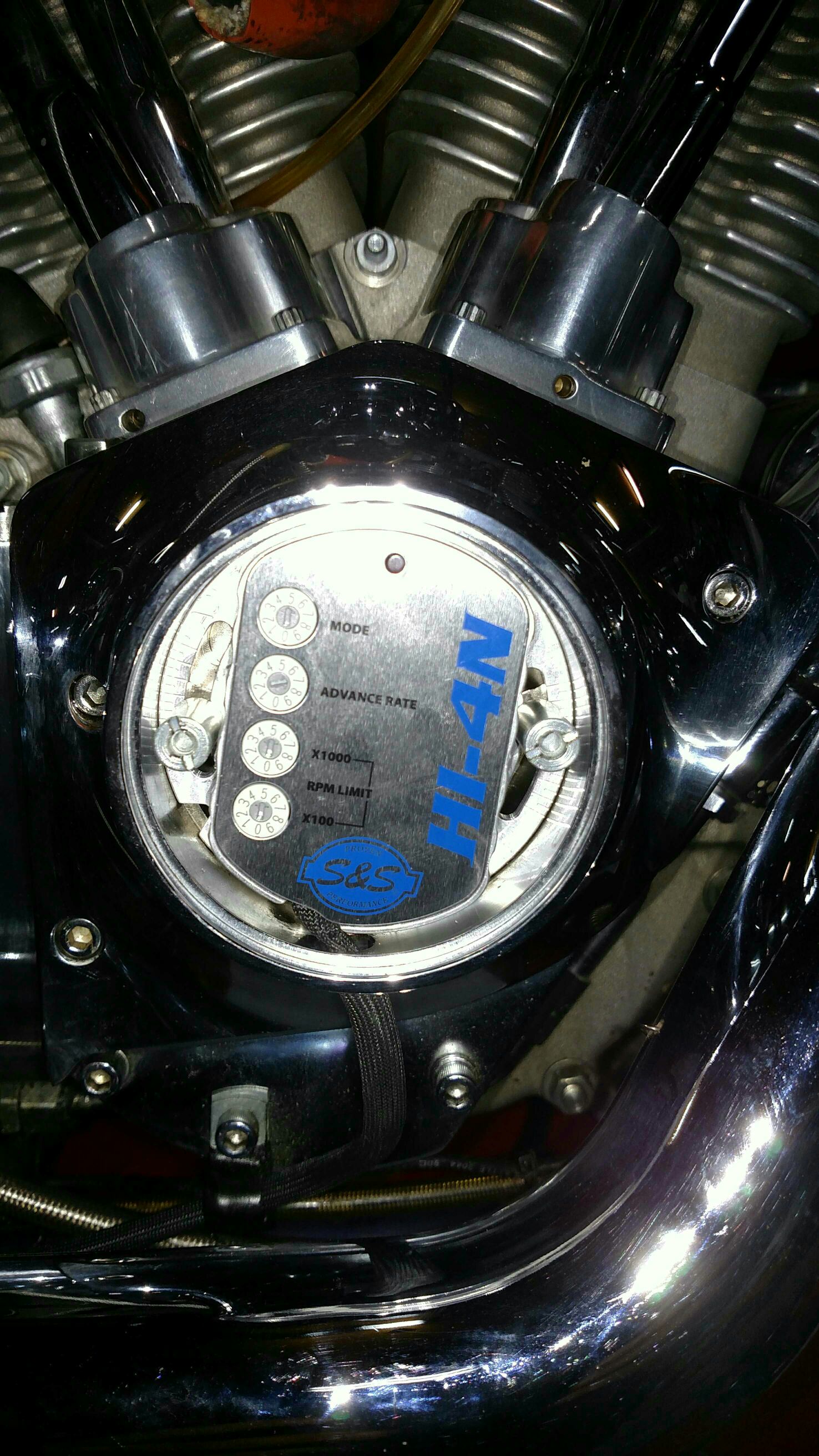

I'd like to know more about how it sets the timing electronically. So you don't need to move the Cam plate to set timing? My 107 will be getting a face lift next

It's a 107 S&S
The settings I got on the HI-4N
Mode 5
Advance rate 7
Rev limit 5500
Any suggestions?![]()

I thought that was too easy so I went and moved the module again. Did the same thing but it was in a Different place
And it still ajusted it's self.
I just made sure the light came on solid then locked the module down.
And then made sure it went out when the engine was turning over
And flashing while running.
Adjusted the mixture and it seems better then anything.
if I'm doing something wrong tell me.
After all this trying to get it running again, it turned out to either be two things one the cam pos sensor or the ignition., And ended changing both out in one fowel swoop ,,,,,, finally.
