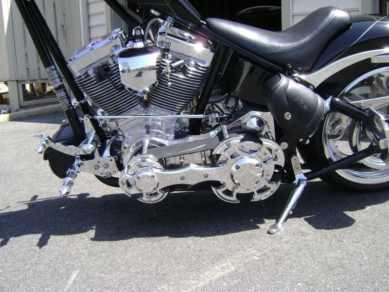

Not the best of Pic's but here's the Karata 4" on a limited edition. The reason I suggest the 4" is besides the torque and looks - it aligns extremly with the pegs and foot levers - a profile look....will post a pic showing that later...

Staffy, question? Have you ever had your pants leg or chaps caught in that Karata. Hell has anyone else for that matter. Got to ask cause I ain't ever rode with an open belt.
Moespeeds
I've had no issues with my Ultima, and it gets a lot of comments. The guy who made mine uses an Ultima clutch basket and custom machines the rest. He can do any offset. My buddy got his pant leg caught when riding mine one night and it tore up his jeans. I have little clips on my boots that keep my pant leg from flapping around. I also have extended forward controls which helps a lot.
Staffy
Ron,
I have not had any trouble with pants/chaps. Have heard similar concerns before but that's a myth to me (so far):lol: :lol:
Just appears "dangerous" but in my opinion its perfectly safe - just don't drink and drive :lol: :lol:
