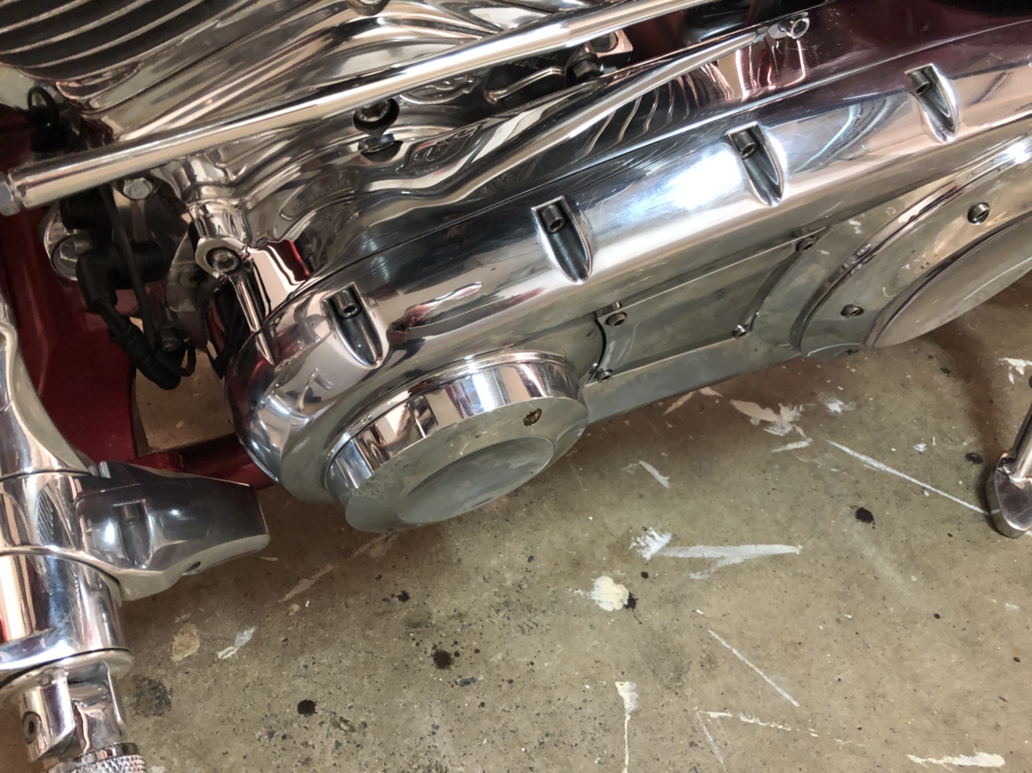

Here are some pictures of all the parts needed for the compensator. First of all you need to make a hole in the outer primary cover as shown in the picture. Then the new derby cover with o-ring needs to be mounted with six allen head screws and loctite of course. Then you just need to take off the big nut on the motor axel and remove the chain and the old 29 teeth gear. Then the new compensator mounts right on together with the chain and red loctite on the new nut. Torque is the same as the old one and you can find it in the service manual.
We had to buy 30 compensator kits and we have probably about 10 left now. In Europe we sell them for 350 Euros plus shipping. If there would be anyone interested in US we can sell it to forum members for 340 US Dollars + shipping. I would suggest that the best would be if there is a couple interested to send one package from Sweden to US and then you guys ship internally in US because it would save a lot of shipping costs.
In Europe we have offered the service to the customers to send their outer primary cover and we would then take it to the machine shop and have it made and then we would ship it back together with the compensator. But this option would be too expensive to do with primarys from US.
You can actually make the holes yourself if you are handy and I can give the exact measurments in that case. It's also easy to measure on the new derby cover.
I hope everyone understands that the purpose of the compensator is mainly to save the clutch and transmission. Some guys ride these bikes very hard with a lot of fast acceleration 0-80 mph and that puts a lot of pressure on the clutch and transmission. Because when you release the clutch lever you have all those horsepower from the motoraxel grabbing the clutch basket ant the transmission. But you get another benefit from it and that is you don't have to switch between gears that often anymore. With the compensator you can easily just pull the throttle even if you are one gear too high.
Ok I hope this gives all an idea about the compensator and what it does. If you guys have any questions just post it and I will try to anser.

Hi Cesad....I have taken the clutch out of my K9 several times and never seen a compensator, mostly because 2007 K9's don't have them. Note below how the primary chain goes directly from the crankshaft pulley (41) to the clutch (not shown).
Harley uses compensator pulleys as a vibration damper--I'm sure some clever guy could devise one for Big Dogs, but I've never seen an example.
Save your Euros--- the Bandit is a very good clutch, but expensive enough, right?View attachment 59863

my 2010 Bulldog Bagger has a compensator, it came that way. I would think you should be able to order that here in the US.
Mr. Wright
Knows some things
If you look at your bagger and compare it to other bikes prior to 2010, the front part where the compensator is does not bulge out like yours does. You have to get a whole outer case to put a compensator and a Slimline primary
