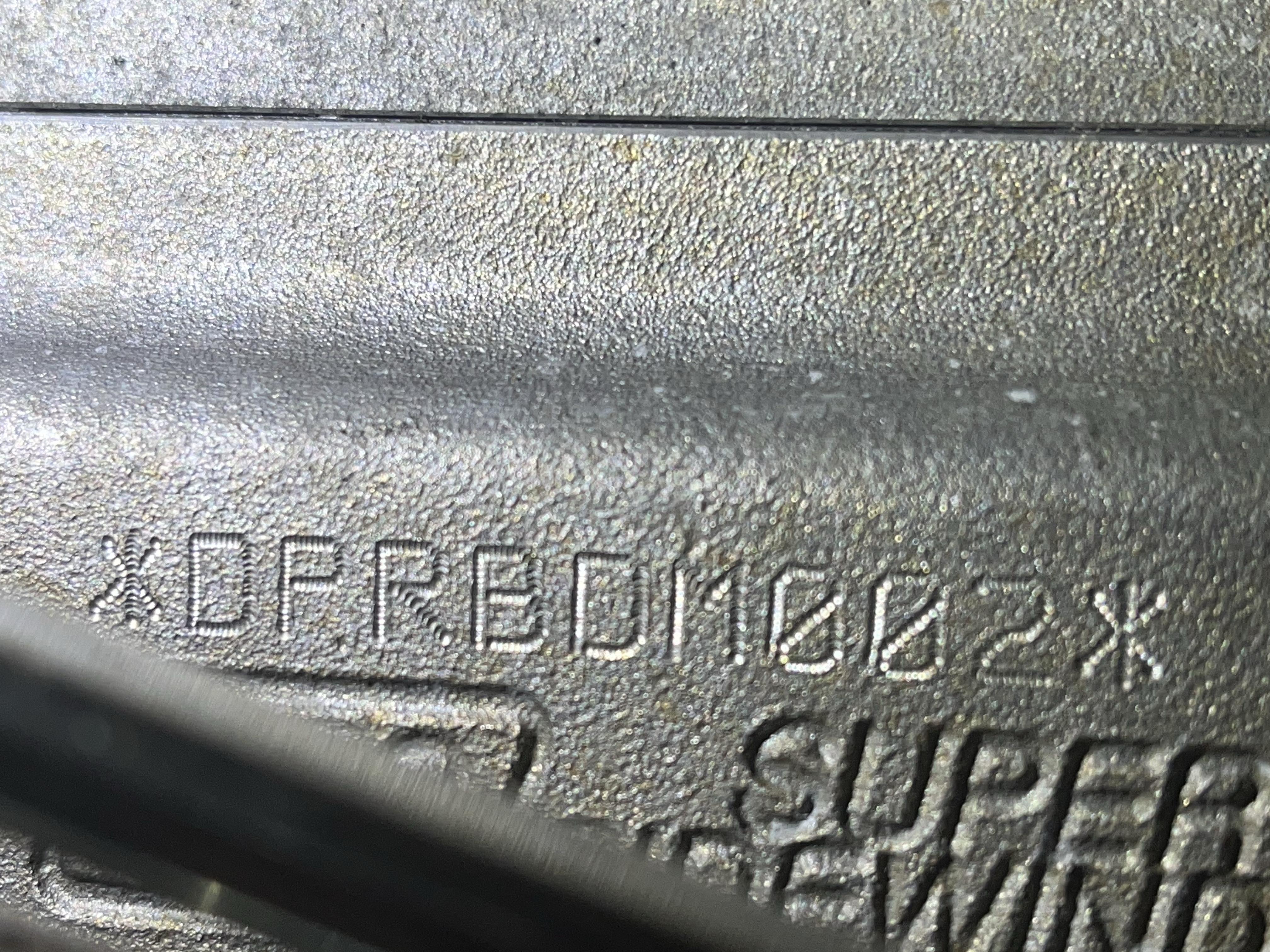

Mikeinjersey
I looked up that the Engine # on S&S
117"COMP,4-1/8",(NATL)SSW | 31-9172 117" COMPLETE V2 LB, NATURAL | *** ASSEMBLE ENGINE COMPONENTS *** | 33-5058 600 CAMSHAFT, V2 84-99 BT | 11-0459-ASM CARB KIT,G,(SSW)-ASM | 90-4105-ASM ROCKER COVER,POLISHED DIE CAST(ASM) | 31-6208-ASM OIL PUMP KIT,BIL.,UNI(HVHP)-ASM | ***SELECT CORRECT PINION BEARING*** | BEARING COLOR_____________________________________ | 90-4915-ASM KIT, COMPR. RELS (ELEC)01/24/2003
I think I did this previously and it was carb setup originally… just didn’t want to look for it again! :oldhardlaugh:
So he lied it’s all the 2003. I have half the mind to go beat his face in. But I need to keep it cool would freak my wife out now days and make her worse from worry. It will all work out, karma
