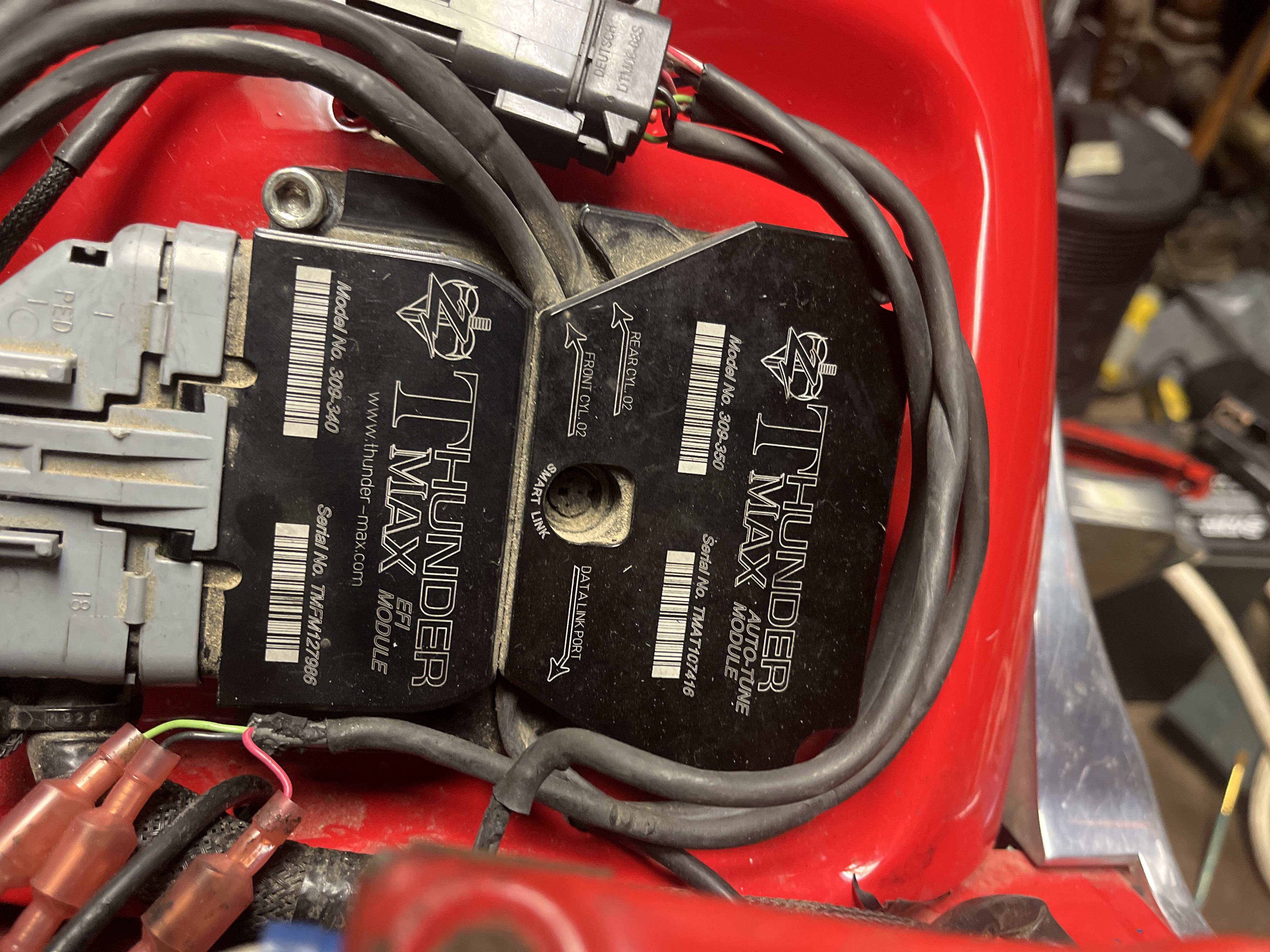

Not a lot making sense here. How do you have “spark” when not cranking.
If it’s truly an EFI, you can simply apply 12V to the battery feed and ignition terminal and it will run. No need to convert it. Depending on the brand (S&S was OEM) there should be diagnostic software that goes with it.
Post a pic of the module.

Ok, most certainly is EFI. I see a data port connection so the very first thing I would do is contact Thunderheart to see about diagnostic software.
I still don’t understand the comment “power to the plugs”. Are you saying you are measuring 12V at the plug wires? That woul not make sense. There should only be a high voltage pulse at the plug while cranking and running
