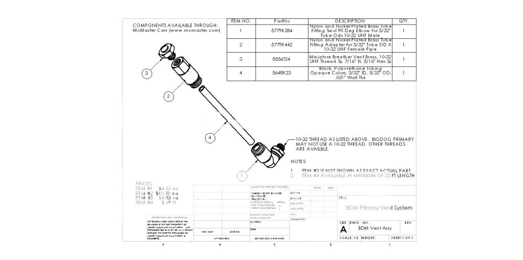

It's an assembly of actual parts I put together in Solidworks 3D CAD.
NO DRILLING...NO MESS INSTALLATION (If 10-32 is the correct thread).
The swivel elbow has a 10-32 thread with an O-ring. The fittings are quick-release type which allows the tubing to be easily pushed in and removed.
The tubing is 5/32" OD with about .1" ID, flexible and oil resistant. The venting capacity with this hose is more than enough to provide for any air expansion in the primary area as it slowly warms up.
Nobody has answered my earlier question yet on what thread type and size the BDM primary vent is. If it's a 10-32 then this setup can be screwed into the BDM vent hole and the new breather vent can be remotely located away from dirt and water clogging.

Anyone determine the thread size of the stock vent hole yet?
Marky-Marc
Original thread size of breather vent on back of primary according to BDM part number is: 10-32" if anyone is still looking.....:D

Did you use the exact parts from the write up?
Where did you run the tube and vent to? How long?
Thanks,
Marc
Actually looking at it again, I did not use the exact set up. I did not include the screened bolt on the end (because it had been lost), I just ran out a hose zip tied to my swing arm. It ends behind the brake caliper
