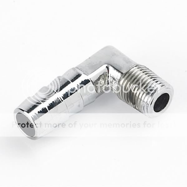

What I suggest is the next time you have the primary cover removed is to do this. Install a stainless steel barbed pipe tube by drilling out and tapping the hole where the factory vent is located. Use something like this
Then running a clear plastic hose/braded hose to vent it to the atmosphere with a small screen filter.
Easy to do with simple tools, keeps the bike clean, and you can make sure that the filter is not clogged.

What size and type thread is the current vent hole?
How does one correctly insert a 1/8" (tapered) NPT thread elbow into a tapered thread hole that I assume was tapped from the open primary side.
The taper on the thread would be in the wrong direction, unless the hole could be tapped from the trans side.

Agree with BigDogBro1, wouldn't it have to be tapped from the trans side? I like the idea though since the stock breather seems kinda flaky. Maybe it's not though.
This might be a dumb question, but if this 90 degree barb fitting is installed, should it be left pointing up with the hose and screen attached. Just seems if it was pointing down that some primary fluid would make its way into it, and leak out. Or is the amount that makes its way into it a non-issue?
Thanks for any help.

Im not sure of the exact size of the stock one but I would say around 10/32? I plan on going up to a 1/4 or 3/8 size barbed fitting. So I know it will vent well and not get clogged.
Yes, it would have to be tapped from the trans side to make it work. A common drill will not fit in from that side to enlarge the hole so when you take off the primary cover it would be very easy to drill that side to enlage the hole plus you need to take it off anyway to remove the metal shavings.
A tap can be placed on the end of a extension to tap it from the trans side. That is how I did my own before I switched over to a Katara belt drive dry primary. Only I used the factory style button at that time. I still had leaks after a long ride and the factory style vent button would weep oil until it would clog then I would get a leak. This may even help to keep oil out of the starter by not letting pressure build until it pushes past the o-ring.
I would suggest it be pointed upward just to make it a little harder for oil residue etc to travel up the 90deg bend..the location of the vent is pretty high in the primary so it should not take in much and you will have a vent tube to take any oil residue away from the bike. Similar to a vent on a automotive transmission or rear end.
