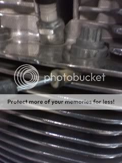

Rain.....so you got the 1/4 inch ones...are those the hand held felt polishing sticks that you got? for like $6.00
No Dave, you need to get the ones that go onto a dremel. This is what I baughtDia 1/4, Medium, Shank Dia.1/8, Cylinder Bob Belt [7Y1.4mp] - $7.20 : www.feltbobs.com, Just the Felt Bobs and Wheels!
They fit perfectly in between the fins. After polishing the fin with some polish, all you need to do is go over with andother bob. It gets the motor nice and shiny. I think this is the easiest way to detail the motor.

I found a new way to polish your motor and the in between the fins. I baught some 1/4 inch felt bobs from ebay for a dremel. It fit's right between the fin and works really well. I haven't finished, but when I do I'll post some pics. You can use larger bobs to do the open areas and the end of the fins.
