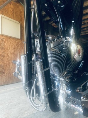

Basically, you just remove the oil filter from the engine block, fit the New 2 port adapter in place where the oil filter was removed From and reinstall the oil filter on to that Adapter..
Then the Oil Cooler pipes go into THAT Adaptor.

If the feed line goes from the oil pump to the filter, and the return line goes to the oil tank, what would be your guess? I would hope that you would put the return line from the filter to the cooler/s, and from the cooler/s back to the tank.

Just wanted to know if it mattered before or after. Thanks for the ca
The don't come with that adapter no more. It only comes with this now. If I had that adapter that hooks to the oil filter I wouldn't have asked these questions. Wish I had it.

No wonder your having problems!
This is where I bought the Cooler kit..
He's still selling the kit with that Adapter.. He may sell the adapter separately..

I sent him a message. We will see Thanks.
It's hooked up to the outlet on the oil filter housing. It cools the oil after it's run through the engine and filtered.
It's cooled then coupling is used on the return line to get the cooler oil back to the tank.
The adapter isn't needed.

Thank you!!!!
