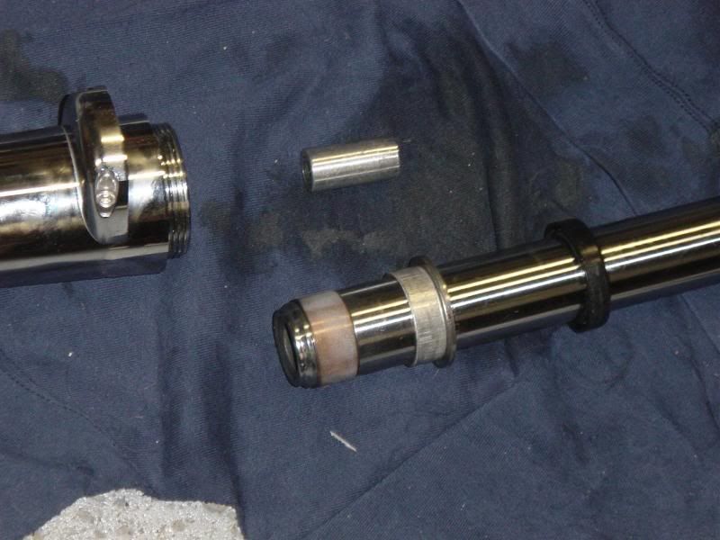

great how to! i'm down to the removing the dust caps and can't get the fuckers off! any ideas?
The bushing at the bottom of the fork tube slides inside the lower fork leg. The other bushing (next to the washer and seal) presses into the lower fork leg and slides on the fork yube.just so i have it right, as i'm looking at that picture the bushing is the white/grey band at the end of the fork tube, then the spacer is a little to the right, then the washer then the seal. what does that bushing do? make a tight fit for the fork tube in the lower leg? it sounds like the vibration is all the way at the top of the fork tube by the upper tree..
