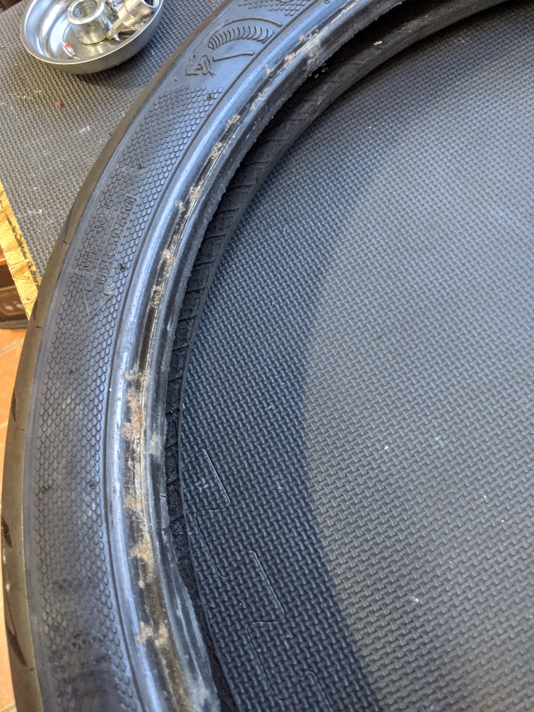

Slime and ride in do not work on bead leaks, which I verified is where it's leaking. And the shop that remounted it last claimed they cleaned it. Obviously I'm sure it could be cleaned better, but at least one pass has been made.

Honestly Brent i would try to clean both wheel and tire very very good and try to see then if it will hold air before i would put a tube in it...some is a real ass to seal at times....i know you frustrated trust me i have had this happen several times but once i got it perfectly clean my problem was solved...only way it wont fix it is if your wheel is bent but i doubt your wheel is bent or you would proably already saw it.....have to be a noticeable flat spot in the rim for it to leak honestly

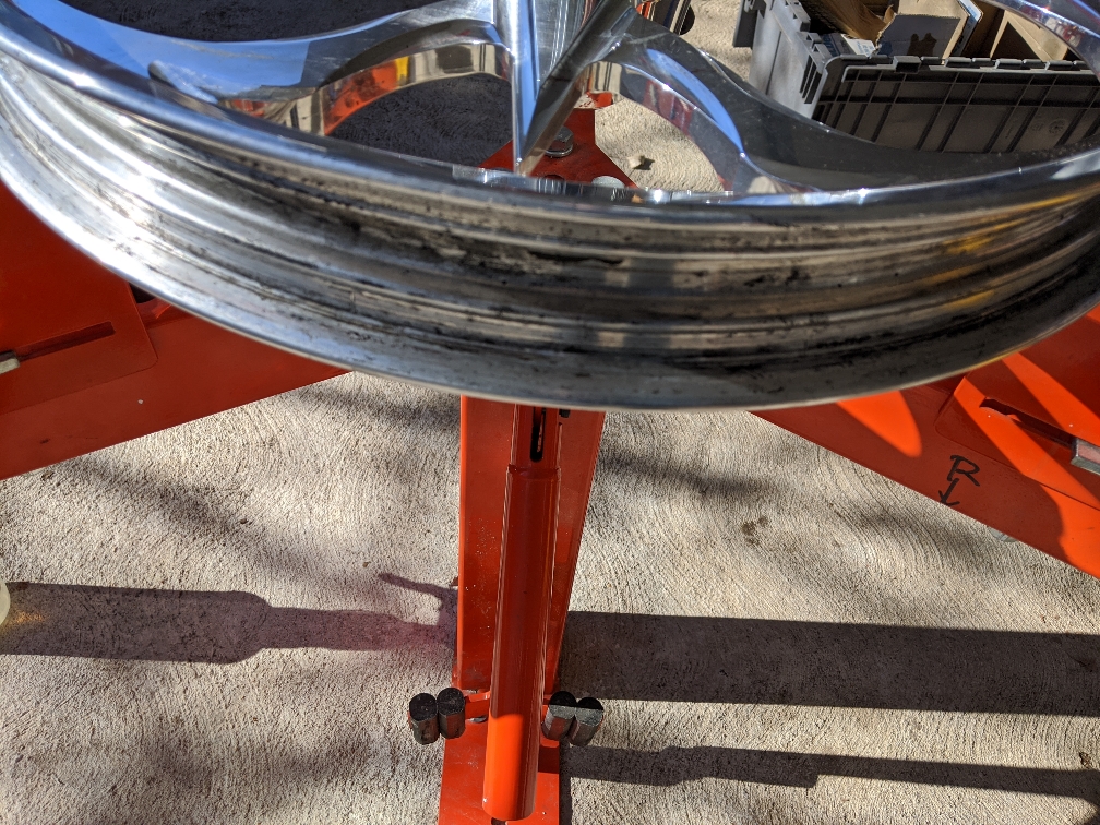

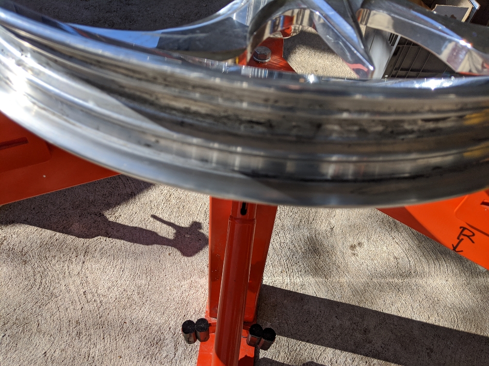

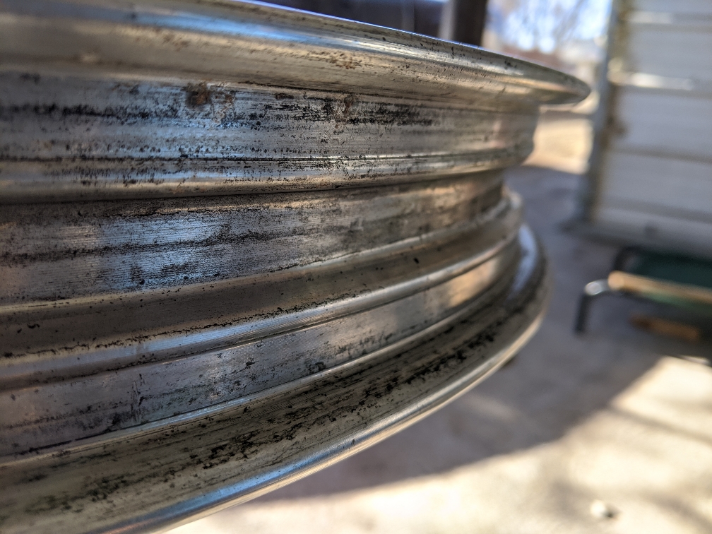

Update - I took it to the same shop that re-mounted it last time, about 4 - 5 months ago. They didn't want to use the tube, but then agreed they'd look at it first and then go from there. They took it apart and showed me pictures of HUGE corrosion. They also showed me "after" pictures where they said they'd spent 1 1/2 hours cleaning, and even polishing, the rim, and cleaning the tire. They also used bead sealer, so they were confident it would work. I couldn't believe they did not charge me a dime.
We speculated the corrosion was exacerbated by moisture from my air compressor, since I had been re-inflating the tire so often. But I found the drain plug on it when I got home that night and not a drop came out. ???
