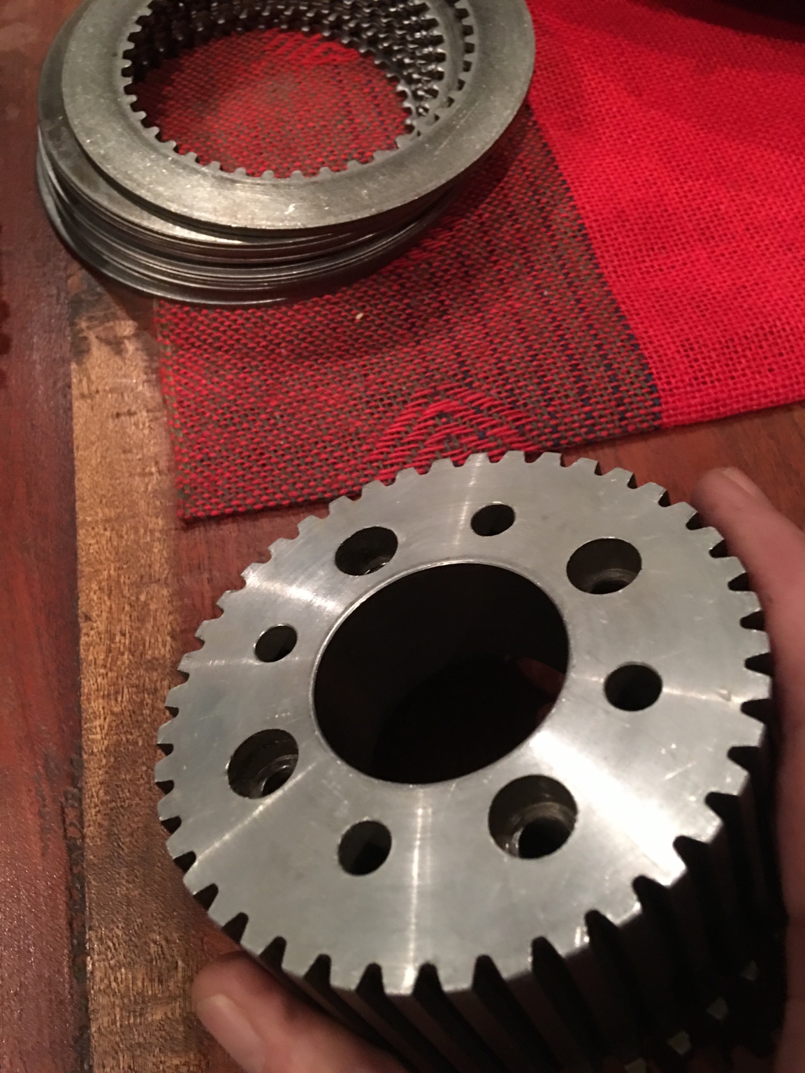

Hi Paul, fun living on the other side of the world with a BDM isn't it????????Outside part of the outer hub is a sprocket for the primary chain.
if you try to put the auto clutch on the outer hub it sits on the side of the chain.
The auto clutch needs to be smaller diameter and have the six holes closer to the center as well.

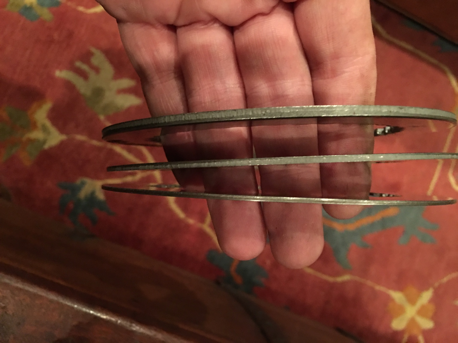

Checked all the plates for straightness, made sure all the steels are facing the same way, measured and re measured, changed the springs to )(, removed the rod, 4 x lots of oil at $15 a Quart.

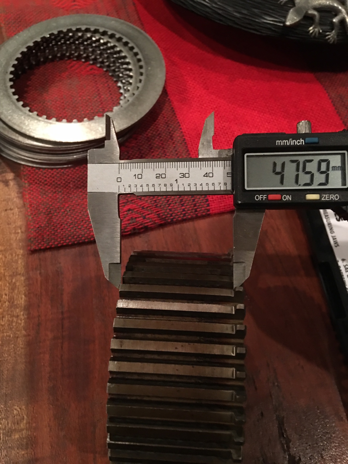

You wanted pics TapioK so here they are and yes my clutch pack is slightly lower than the center hub.

Yours look different to mine.
I don't have those ears for the bolting to the outer hub, if i were to guess i would say it is for a open primary.

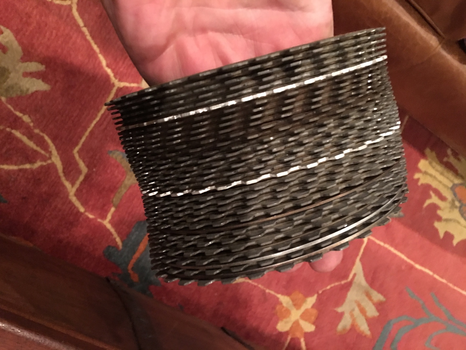

Would you be a bit closer... I once happened to find a local motherload of steels and frictions... also I think I got a new set of steels and frictions with EFM. I have 3 thickness of steels. Then Baker sent me extra set by mistake, they didn't want them backThe never ending saga continues.

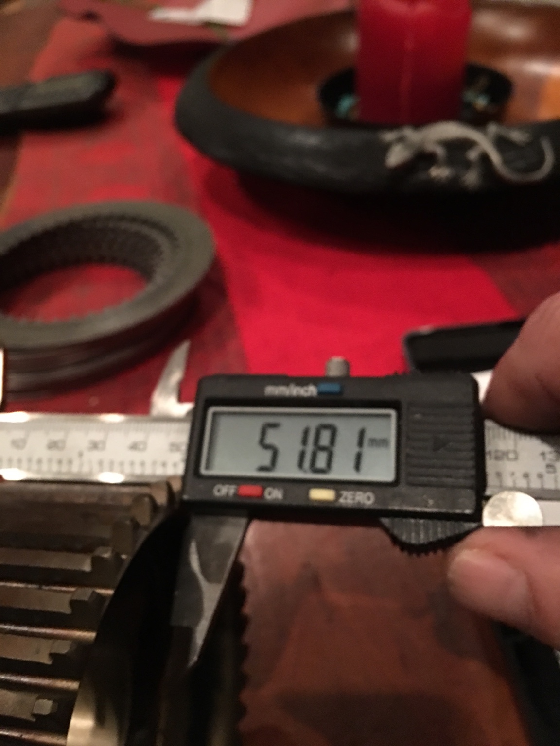

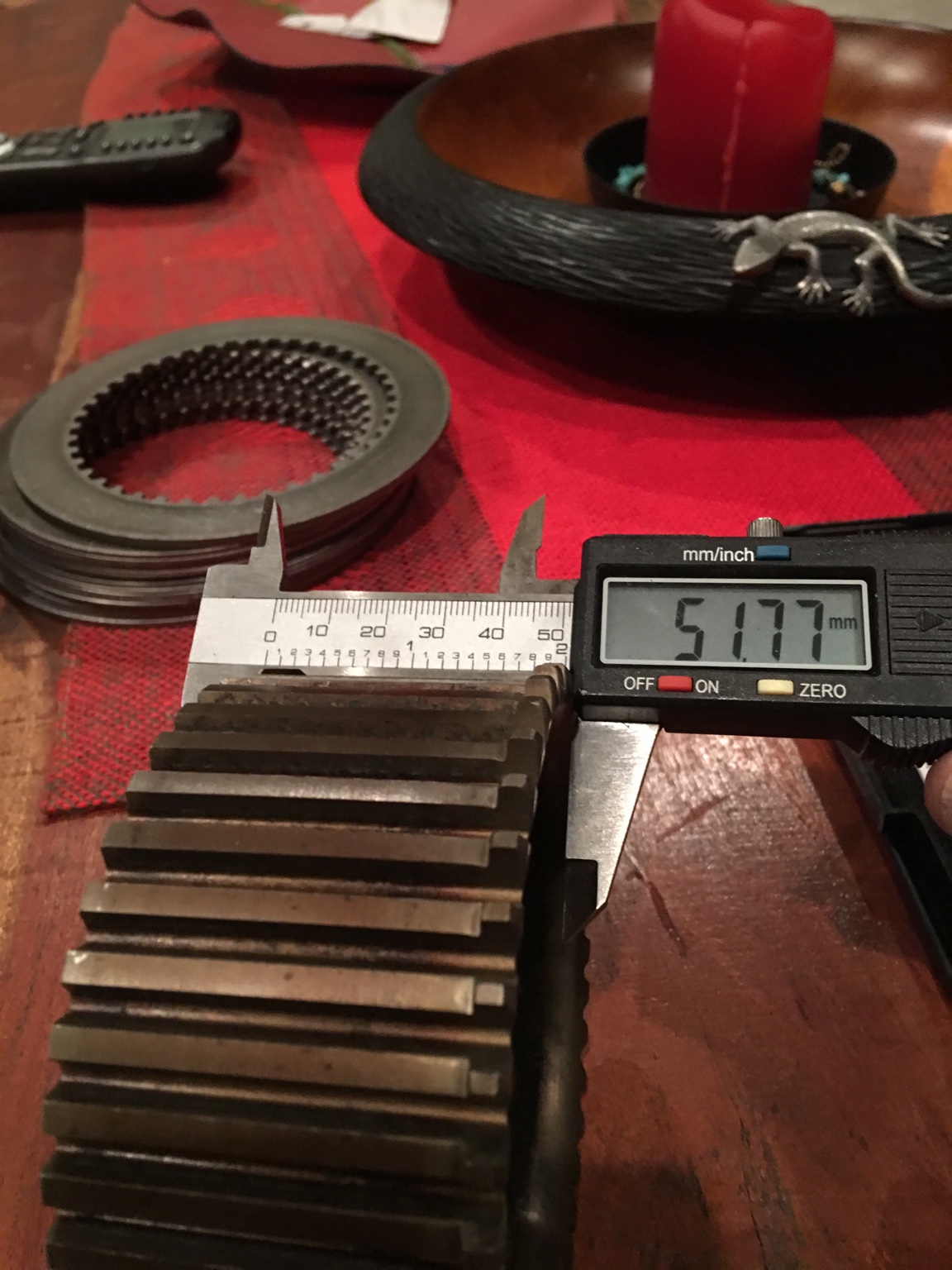

Did the measurement from the fully free to touching the friction plates, i am supposed to have .06" but i have .0885" with the EFM rubbing on the inner hub.
Get prompt reply from Garry he suggests swapping out steel plates with the ones provided in the kit.
WHAT bloody plates????????? WHAT bloody kit????
I got 6 cup springs and some foam packing and no instructions in the box ( I still have the box).
Looks like i am up shit creek again while i wait for a reply or locate some plates.
If anyone has the overall height of the inner hub so i can make up the spacers i machined off I will return to manual clutch and be able to make my club runs and not have to be someone "bitch " for the weekend.

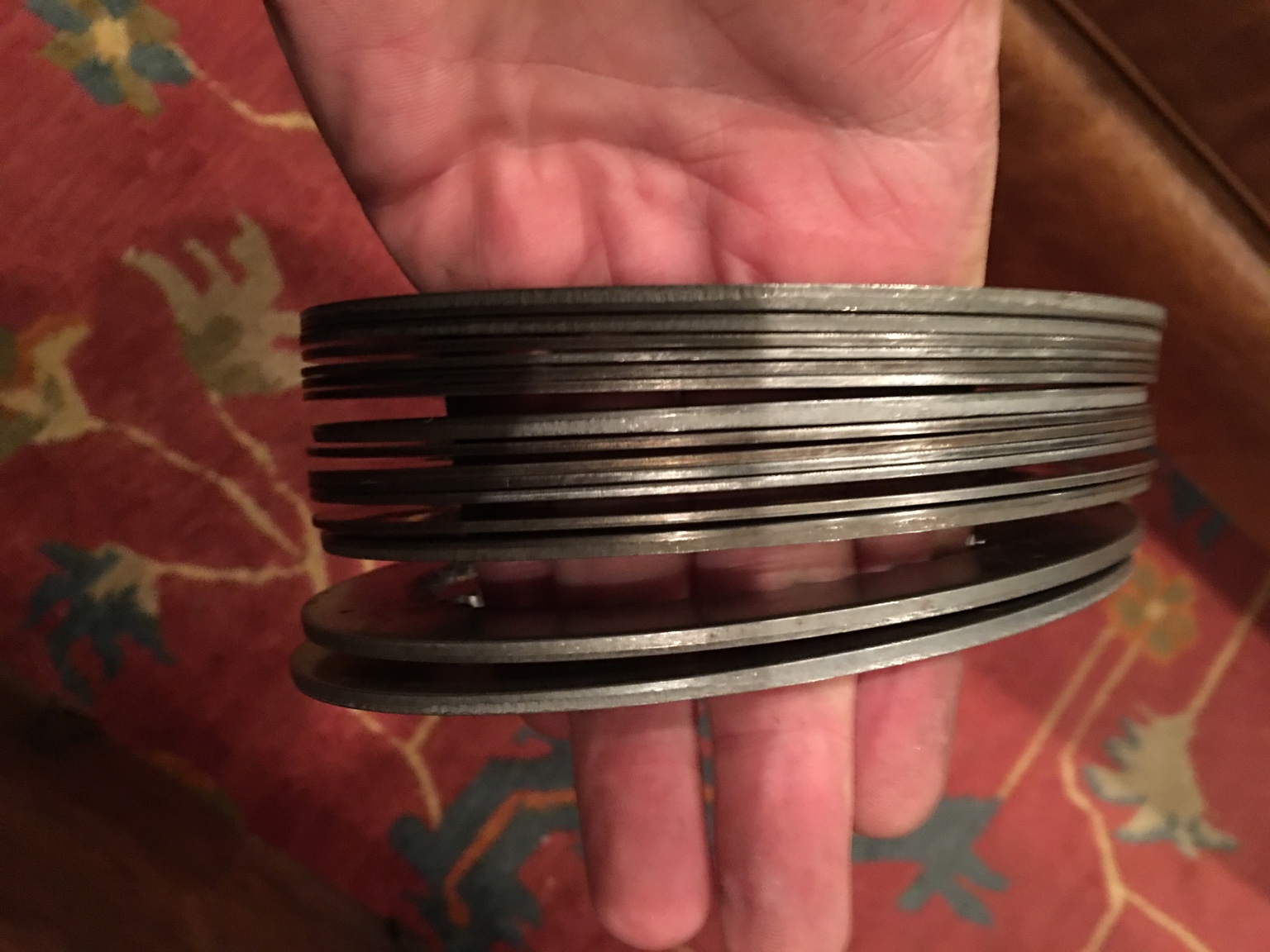

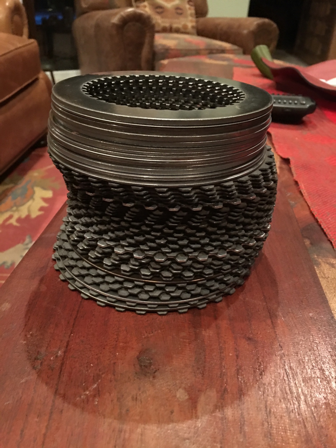

maybe because they fucked my order 3 times. So I also ended having 3 throw out bearings
Nice find got about 3 clutches there 100k plus miles easy!Would you be a bit closer... I once happened to find a local motherload of steels and frictions... also I think Ingot a new set of steels and frictions with EFM. I have 3 thickness of steels.
Send me your address and I send you a few steels, it's not like I'm running out of those
Yeah! Someone had replaced plates because steels were blue, I suppose he didn't have sandpaperNice find got about 3 clutches there 100k plus miles easy!
