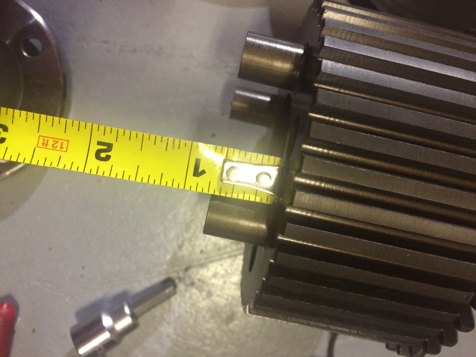

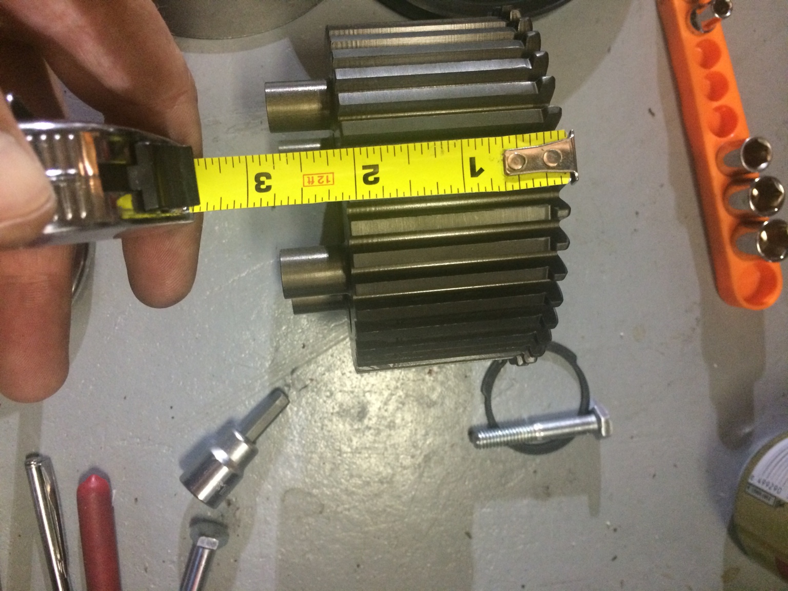

I knew I had some old pictures somewhere!
They are not great for exact measures, but best I can do for now
JeffM
Perfect, exactly what i need.
I measured my stack height exactly 50mm.
Height of my inner hub is 50.36mm.
WTF i measured all this prior to assembly.
Q. does this mean i have destroyed 1.5mm of clutch pack?
Q. Or does it mean everything settled once the oil was compressed out of the stack?
Whatever it means is that i measured incorrectly to get the height of the hub. My bad.
However this is not a bad thing as i now have to add plates and the extra height of the hub will be a good thing.
