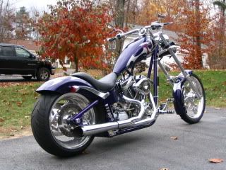

The only thing I noticed about the Ridgeback when it's wet outside there's a rhythmic squeaking and it carries over to the next morning. Not just when riding but also when the engine's off and I'm manuevering it in the carport to face the other direction.
Anyone else experience this?

Must be coming from the belt
HMAN
Just like to ride
Sounds like dreaded belt squeek. To find out for sure, take a BAR of soap and rub the inside and outside Edges of the belt. Take it for a push and see if the squeek is gone. If so you can check out SuperMax and have the rear pully relined. Or it may be a simple alignment on the rear tire that will fix it....

The squeak is gone because everything's dryed out now.
The recommended test sounds like I rub the soap while the squeak is there in order to make it go away (and in that case it's either a rear pully relined or a rear tire alignment).
Just want to make sure it's not the opposite test (the squeak isn't there and I use the soap in order to summon the squeak)?
HMAN
Just like to ride
First way was correct.
