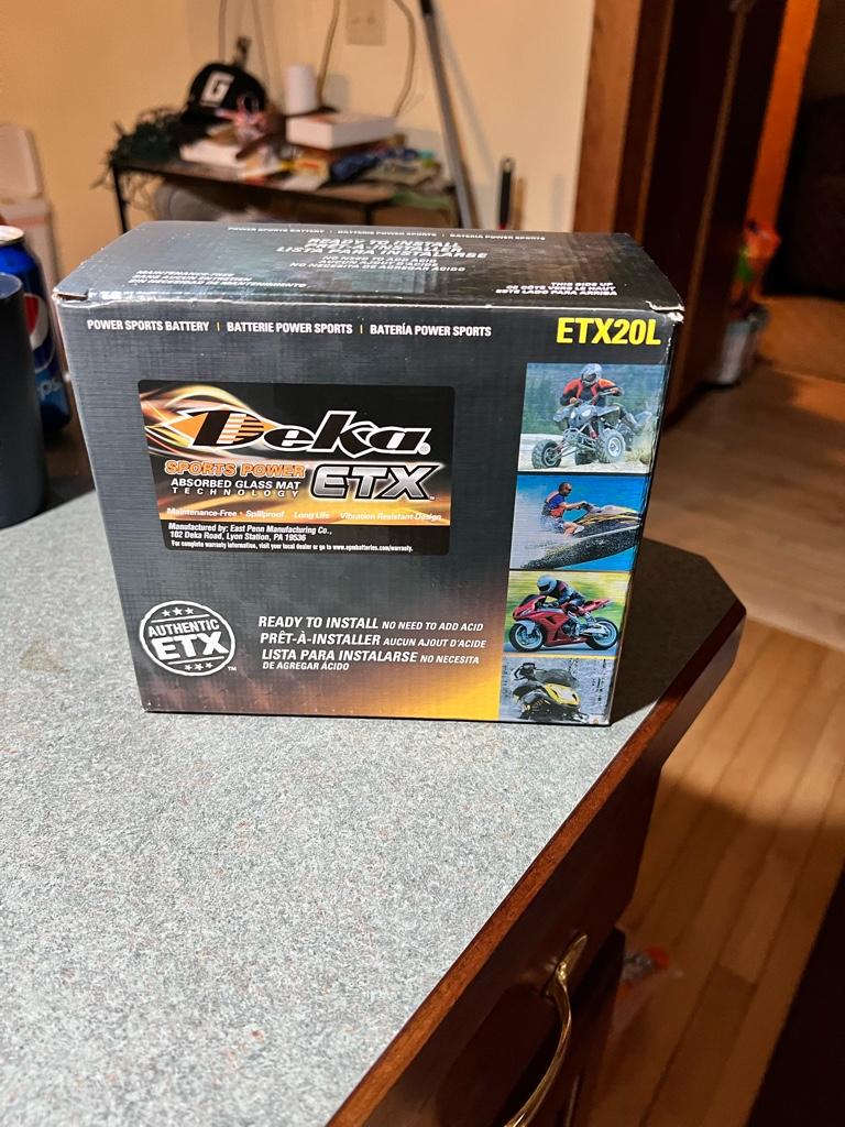

Make sure it's at least 310 ccaThis part number crossed over to the Deka, so I guess I'm ok, these little shits weigh 20lbs.
Super Start Power Sport Battery Group Size BTX20L AGM ETX20L | O'Reill (oreillyauto.com)

Yes the Harley battery is good also. It is designed to handle the vibration. It's just a little more expensive.Call me Old Fashion, I have stayed with the Harley battery because 30 years ago it was the only battery that would turn my stroker motor over.
Harley factory batteries are supplied by Deka.Yes the Harley battery is good also. It is designed to handle the vibration. It's just a little more expensive.
Yes, we know that. And it has been explained 100 times on here, how the inside of a battery is built, and how much better Deka builds their name brand batteries. And just because the numbers cross reference, doesn't mean your getting the same thing inside. And if that battery fails, how much more money they are going to spend.Harley factory batteries are supplied by Deka.

Absolutely correct and in addition it is important to not get an Asian battery.If it matters, Super Start batteries come out of the same factory that makes the Dekka batteries that everyone on here recommends. Batteries are kinda like washing machines or furnaces, in that there aren't really that many companies making them. A few companies make products that are marketed under multiple "name brands "and sold through several different outlets. I just bought a Duracell battery for my truck and it was made by East Penn batteries and marketed by a few different stores Just sayin !
