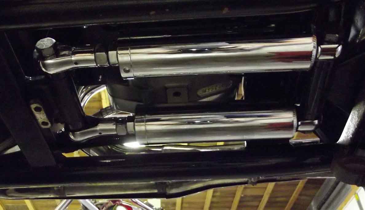

See on Facebook this guy Kevin Dunmire, he has installed the 422 on his K9 and tieribbed the oillines to the other side of the frametube......https://www.facebook.com/photo.php?fbid=449044415886962&set=pcb.1671041796372913&type=3&ifg=1&__tn__=HH-R&eid=ARCQ_QEqnJdasgLmJW5getCTSOzjE6VsUe2Adh1hr3QYRlPl2A6tHjZLQRph4IkuoIiw8Pm2dVEAD5BZ

I have a Daytec K9 frame and the 422's shocks , the primary side shock hits the frame support and cant be mounted..... a simple option before anyone decides to chop up the frame, and compromise any of the transmission support brackets, is to run the 422 shock on the exhaust side and another smaller chrome cylinder shock on the primary side...... Those who have factory air ride systems on there bike know what i mean.....the factory setup has one large air cylinder shock and one small stock shock... for the smaller diameter chrome shocks, you can check that company called WIld Steed Worx...... the owner is a big guy, I think his name is Curtis.
