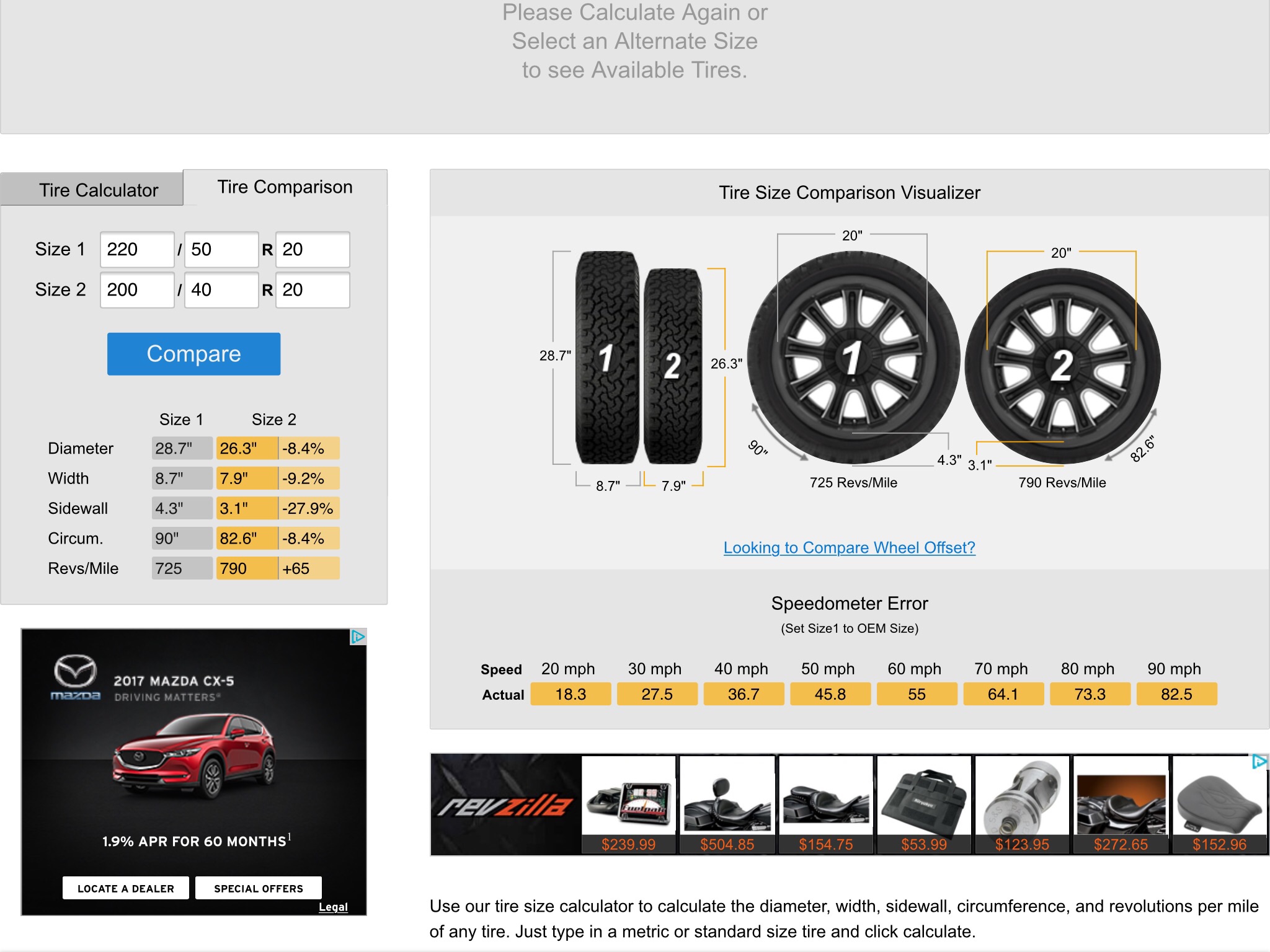

Yep. I suppose one question would be: wich is more important, the diameter of the wheel or diameter of the tire? Also how much you can drop the rear of the bike before you lose too much leaning angle or looks. Or how much bigger diameter tire you can install.

There is a Pneus Online, they have a 200/40/R20 they sell which would fit perfectly but they don't ship to the usa. Does anyone know how we could get them here in the states?
https://www.tyres-pneus-online.co.uk/
Not sure if you can call 0,8 narrower and 2,4 inch smaller diameter perfect fit, but I suppose you might use the original wheel. Or is 200 to narrow to seat right?
Do you think it will work? I know it's 2" lower side by side but the bike will only be 1" lower and I think you could gain that back in the shock adjustment. Correct me if I'm wrong please. Thanks
