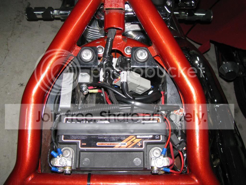

Guys u know what I don't have a fuse attached to my wire plus that's linked to my positive wires. I looked and looked and can't find a fuse linked to the positive wires. Anyone have anything to add?

Yes, add a inline fuse. I know it sounds like a smart ass answer but you have to have some protection. When I installed mine on my 07 Bulldog, I added an inline fuse.

Weird...I have a 40 amp to the Voltage regulator that you can see in my picture just to the right of the ignition module and the 30 amp spade just forward and right of the Positive terminal of the battery. I put it there for access. Maybe someone put it in a spot hidden from view and access which is just crazy. Or, you need to install one.

Okay I got some questions, the inline fuse you're talking about is the 173-000039-00 kit? Also is it being hooked up between the voltage regulator and battery? Do I have to remove the circuit breaker and replace it with this kit?
