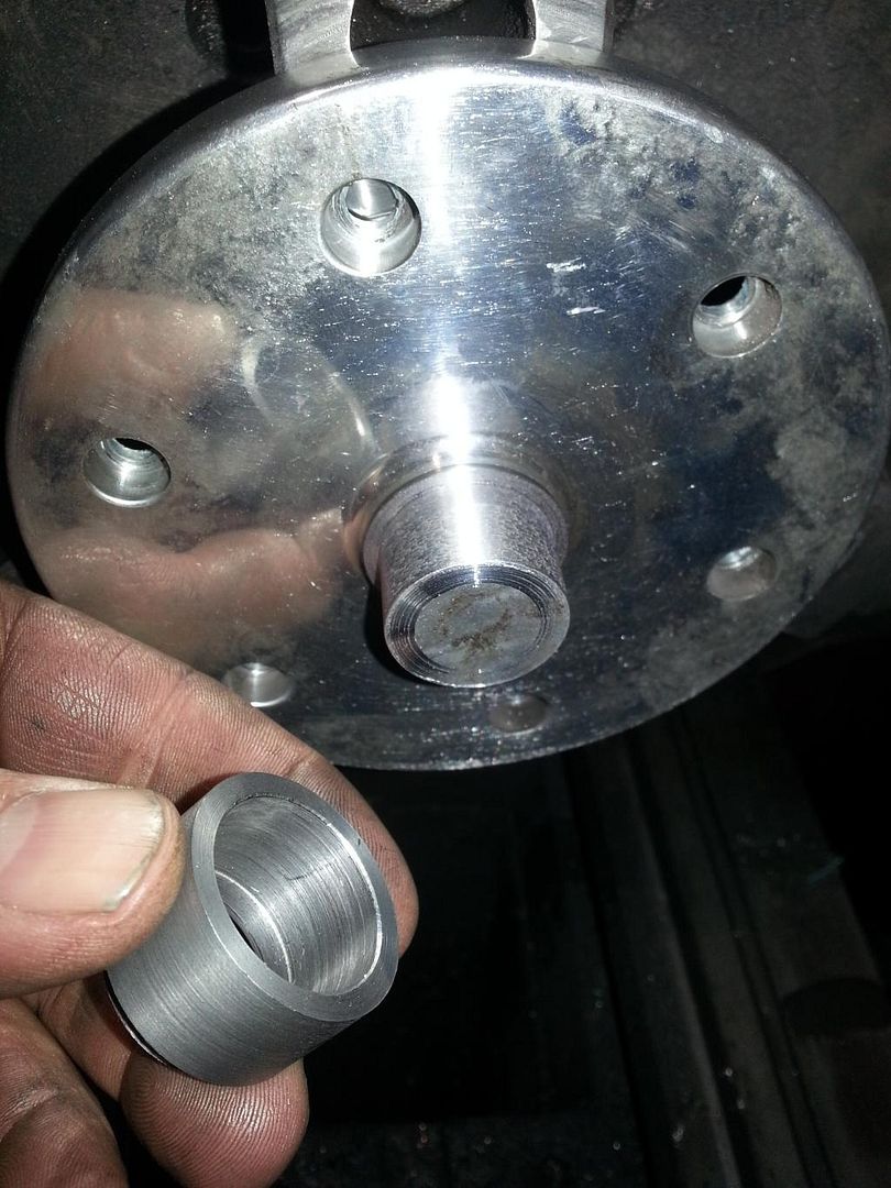

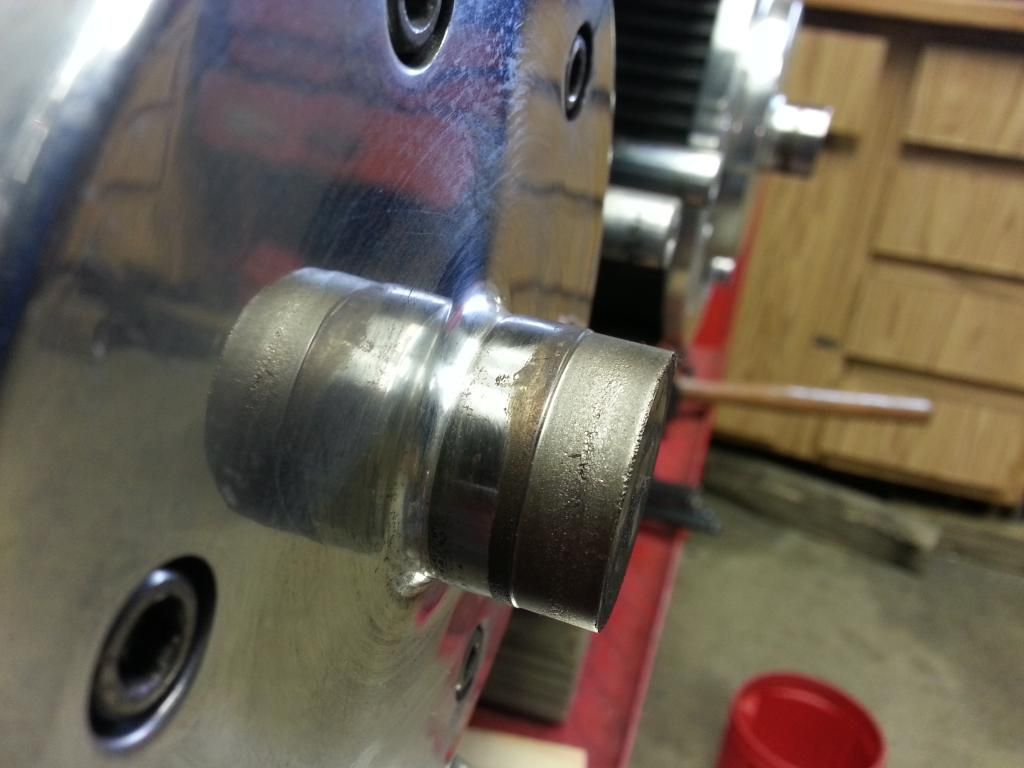

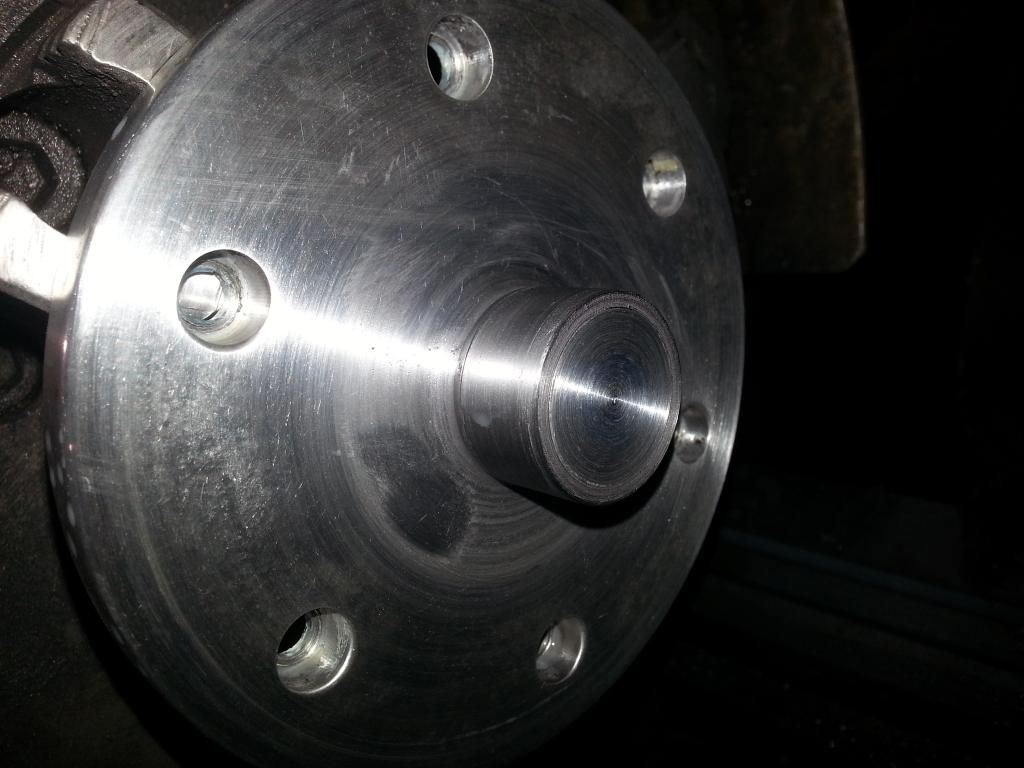

Found my squeaky rattle. Outer support bearing, on the engine hub, for the OP. I replaced this bearing once and red lock tighted in place, but it still came loose. I guess I'll have to turn it down and put a medal sleeve on it.

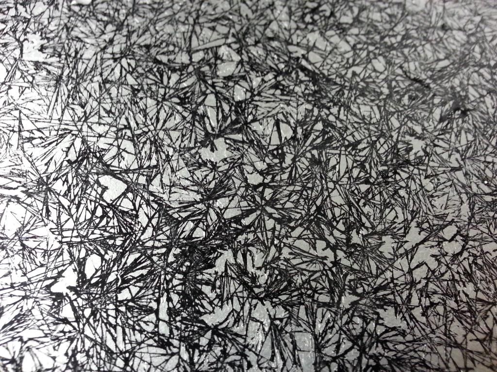

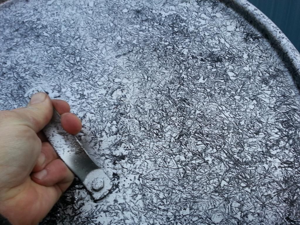

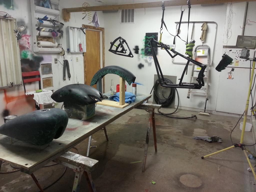

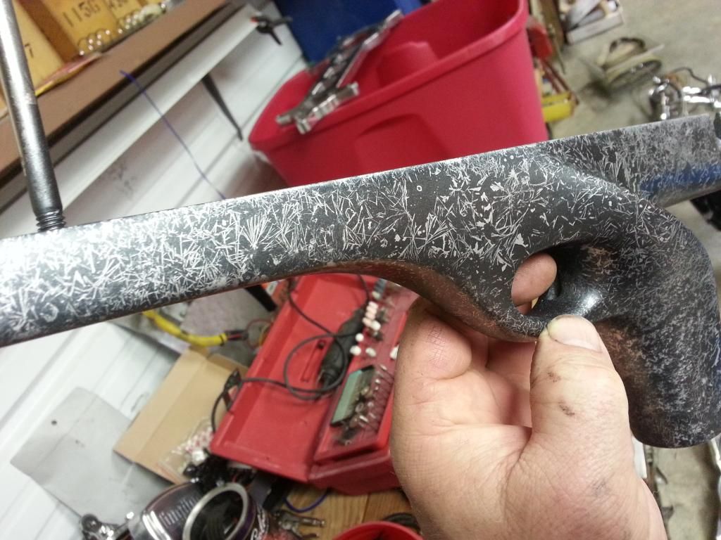

I had to shoot some silver paint today, so I decided to run a test piece to try out a new paint product I found. The bike will end up candy green, but I found away to use the black that's on there as a base color, for both the flames and the main color. So I grabbed the lid off my black trash can and gave it a whirl.
I think the candy green will look awesome over this.
Roaddawg
Very nice. Is that the Alsa Crazer you are using for that effect? Should look great under the green. Also, no, we didn't get any snow. We got some rain, but southeast and southwest of us got a little. 20 miles north received 5.5" inches and Flagstaff, which is about 100 miles north got hammered.
Mr. Wright
Knows some things
Hey Bruce, I'm originally from just south of Lake Havasu, between there and Parker. I remember as a kid it snowed there once. And I've seen it hail 2'' deep.
The effect I'm using is call Crystal FX.
All the years of trying to keep shit out of the paint, while I'm painting, Now I'm spraying salt crystals on it to make it look cool. Go figure.

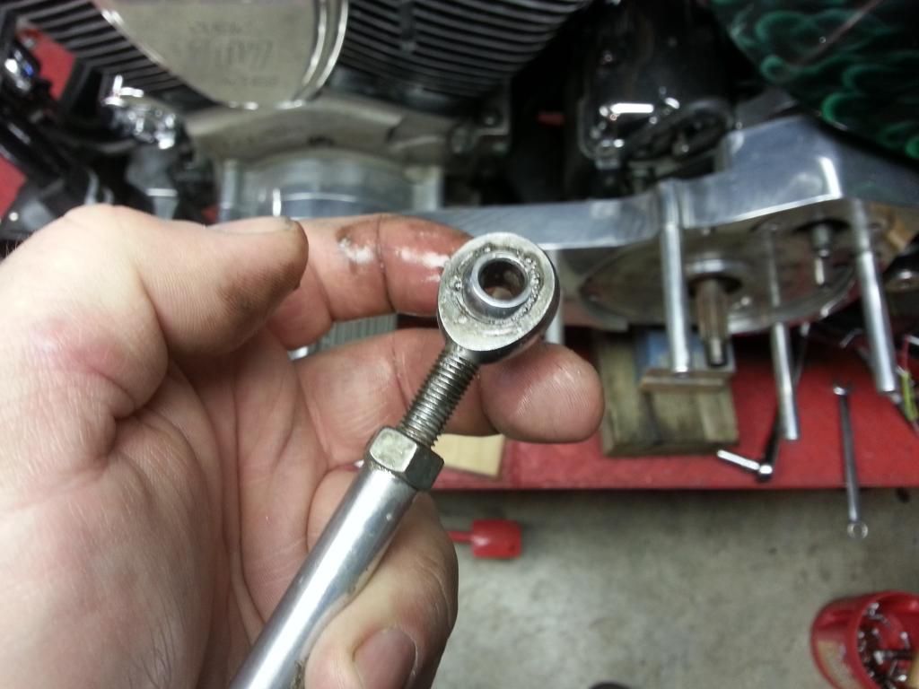

I got a little bit of time on her this morning. Here is a good reason to keep up on you maintenance. Shifter rod end was froze. had to soak it in penetrating oil to get it loose.

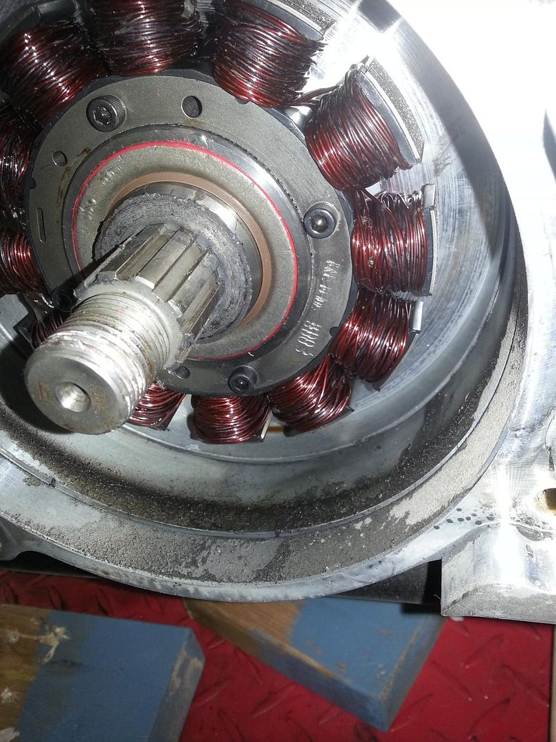

Also FYI, anyone that is going to put an OP on, remember this.
Your alternator coils are in oil. I cleaned mine with electro clean, and after my first ride, I thought my new seal went bad. So I pulled it back apart, to find the seal dry. So I cleaned the coils again. Still leaked oil. It finally quit, just remember them coils will hold a lot of oil.

Ok, if you look back about 5 pictures you will see the bearing spud, for my OP.

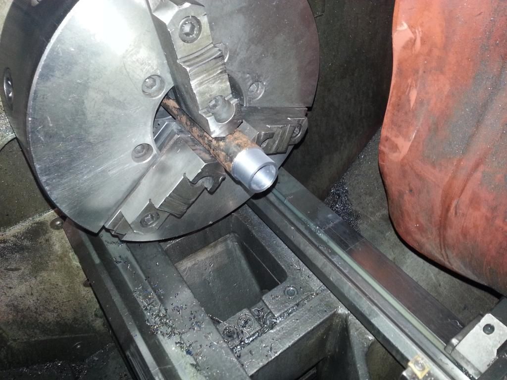

I went into the shop today and made a steel sleeve.
Then turned the spud down, and pressed the sleeve on. With some bad ass glue.
Then turned it down so the bearing will fit.

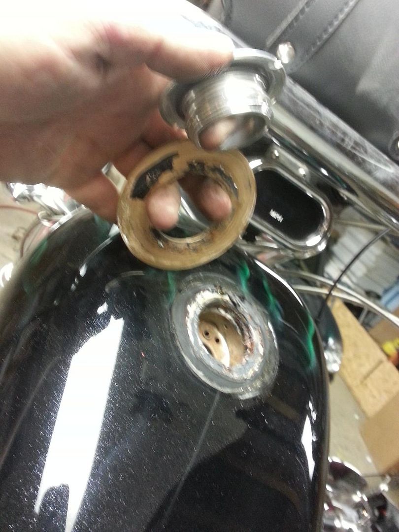

I know there is a few people that are waiting to see how my paint saver ring comes off.
The original PS unscrewed without much fuss. Then I took a long screwdriver, and pried on the inside of the ring, and it peeled right up.

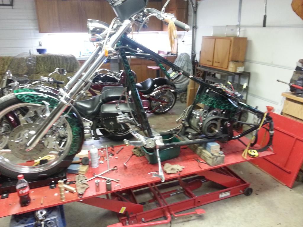

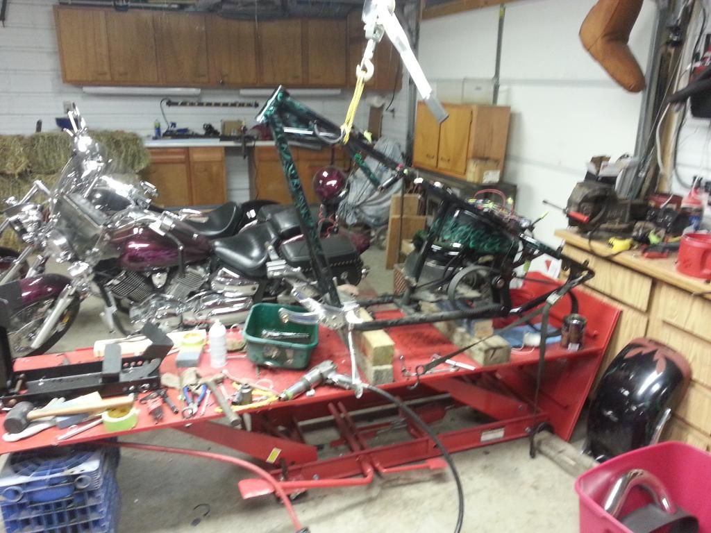

Had a busy day today, but unfortunately not on my bike. I did manage to pull the engine tonight though.

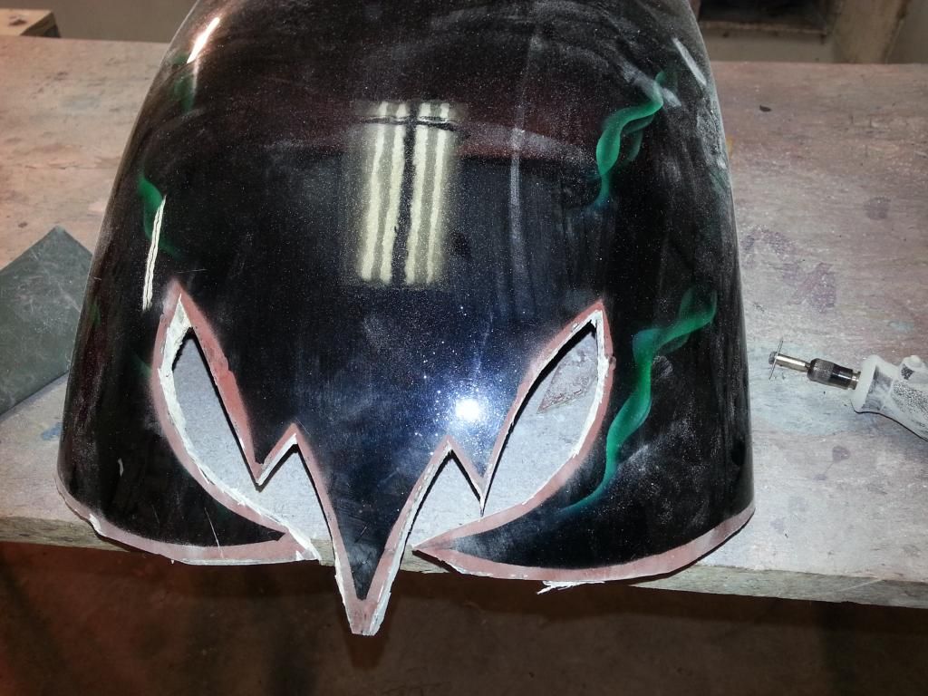

Allrighty then, here's a few pointers for those who get a wild hair, and decide to sculpt your fender.
First you need ventilation. I used my paint bay and turned the exhaust fan on. I'm sure I'm going to regret it.
Second, you need a respirator, goggles, gloves, hazardous material suit. Damn I hate fiberglass.

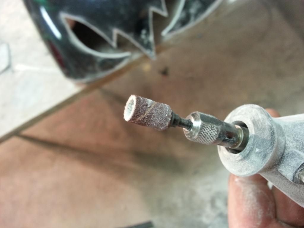

I used a diamond cut wheel for my dermal, to cut it, leaving about 3/16'' from my line.

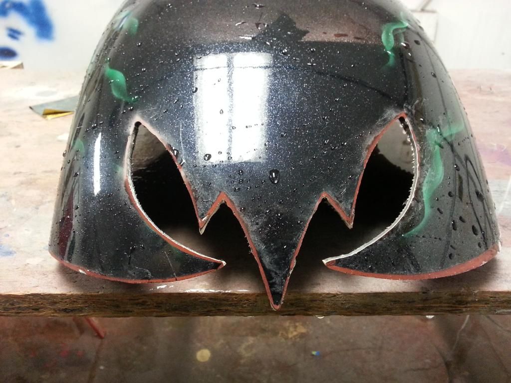

Then I used a barrel sander to take it out to the edge.
And measured it out as I went to make it even all the way around. And I use a small carbide bit to get up in the corners.
My next step will be to spread some kitty hair on the inside of the fender, to give it some strength. Then I'll come back and round all the edges.
