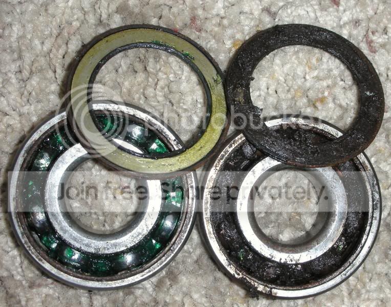

I wanted to bring this thread back up to the top since I just had to replace my tire. I would take Raywood's advice and pack these things yourselves.
The bike had the stock wheel bearings and after about 8,000 miles they were useless. I literally couldn't even turn the bearing by hand inside the hub and they had barely any grease. The tire was just completely rotating on the axle.
When I got the new replacement bearings I opened them up and repacked them myself as the grease is quite minimal in there, hopefully avoid failure at 8,000 miles. I'll see how these hold up but I don't see why you wouldn't replace them every tire change, $20 at WSW for the bearings.

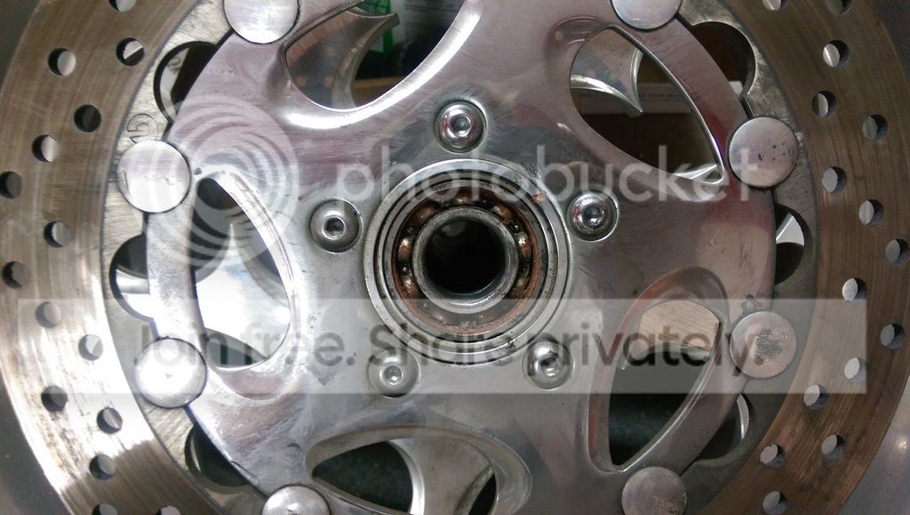

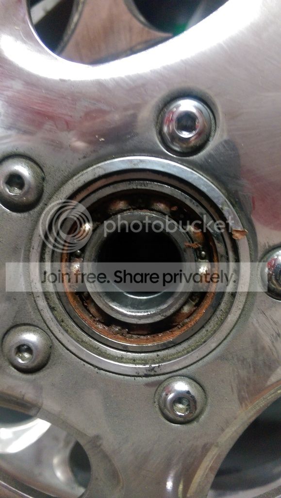

Brake side Bearings:
BadDawg Bill
Well, since BD used cheap bearings in everything you should replace them with sealed bearings and not worry about repacking them...
BWG56
Was your bike in a flood? I changed mine out at 15K and they were still greasy, one was a little rough feeling but the other 2 were smooth and I changed them anyway.

Thats a good time to do it, there cheap enough to do it at tire changes, just make sure you install the correct way, meaning press them in by the outer surface.
Haha no flood. The other side didn't look that bad. I got caught in 1 really good rainstorm for about 20 miles of a Texas downpour about a year ago and thats the only rain for the most part it has ever seen. I was surprised myself how they looked honestly. I usually don't take it out if rain is forecasted.
