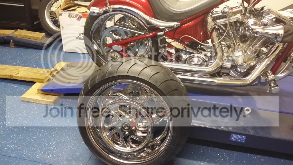

Got after it today. Hopefully get the primary on over the weekend

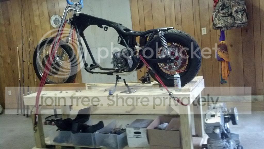

Looking at the frame, the engine and tranny are bolted together and bolted to the frame at the front of the motor and back of the tranny, is this correct? What am I missing
way the older Harleys worked:up:Looking at the frame, the engine and tranny are bolted together and bolted to the frame at the front of the motor and back of the tranny, is this correct? What am I missing![]()
You would think with the vibration it would crack the housings, I'm guessing I've lived in a boxway the older Harleys worked:up:

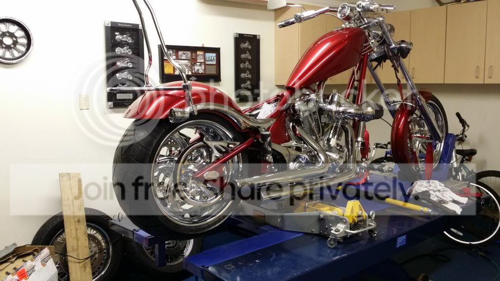

I like how the lift has a removable insert under the back tire, bike looks great, is that what you'll bring if you get to Bikeweek?
You are correct the front of the motor is bolted thru a rubber insulator that is attached to the frame. The rear of the motor is bolted to the front of the transmission. The transmission is not bolted to the frame but is attached to the frame via the swing arm pivot bolt that runs thru the frame,swing arm and rear of the transmission. That way the whole assembly is mounted in rubber and reduces vibration. There is also an adjustable support from the coil mounting plate to the frame on the top of the motor. It is not on in the pic. I am not a Harley guy but am told it is the FXR style. Not sure about it though. Here is a pic oh the transmission. You can see the boss where the long swing arm bolt goes thru.Looking at the frame, the engine and tranny are bolted together and bolted to the frame at the front of the motor and back of the tranny, is this correct? What am I missing![]()
