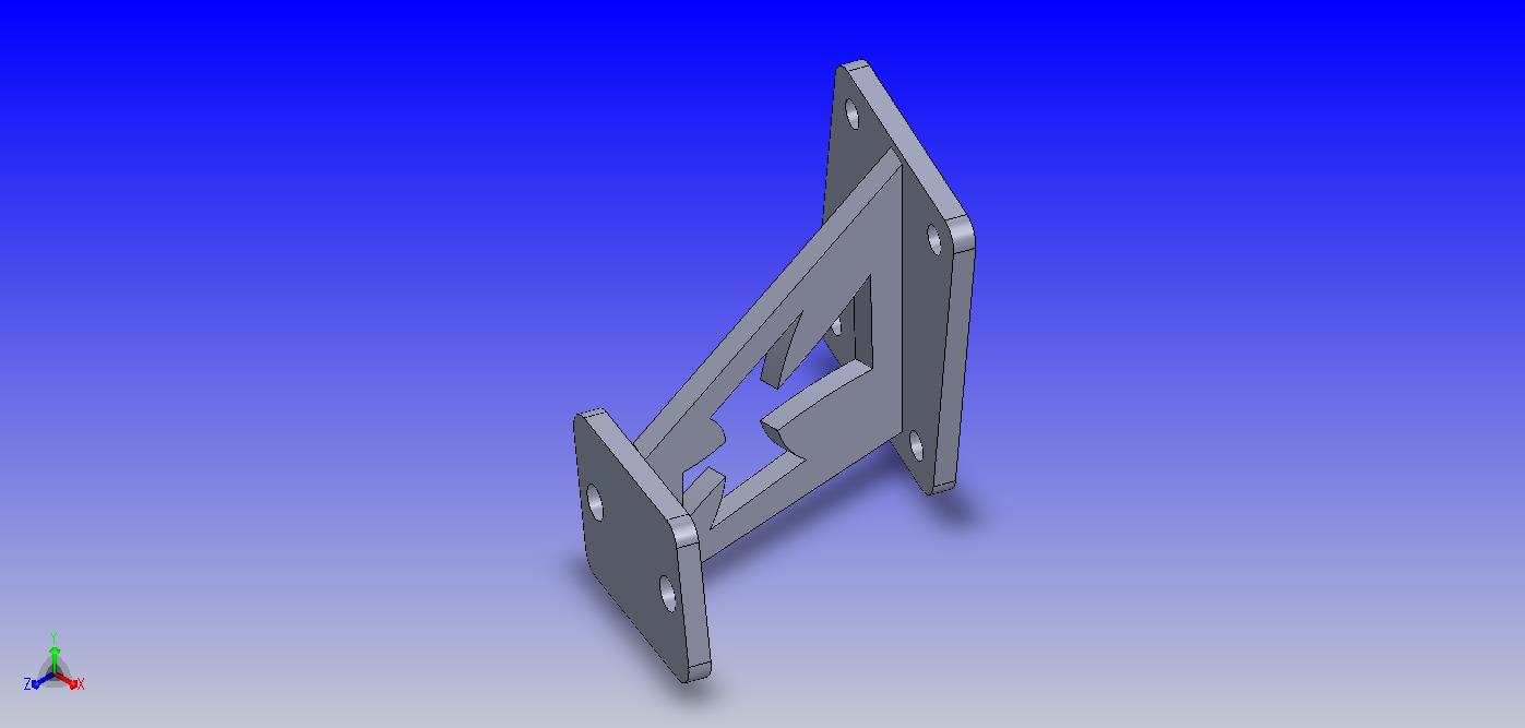

aspen874
You probably could sell quite a few if you can fabricate something better than the V&H's bracket. The bracket tends to crack at the weld, it has happened to several members. I keep a spare for just that reason.

That's a whole lot better right there..... Now, what if we take that plate with the Maltese cross, add one more plate next to it, then instead of the cross make a whole big enough for a bottle? Those two plates can also be made of aluminum and polished. Another use for the bottle could be locks (I'm going to Bikeweek and thought of that one...)...
N8KAM
Made a new one a few years ago out of aluminum... I was able to bring the pipes in and up just a bit so they wouldn't drag as often on the hard right turns.. :D
Viking
Biker
Very nice work. Adding in a closer to the frame mount is brilliant too. My lower pipe looks like crap due to scraping.
N8KAM
I first made it out of 1/2" plywood.. well maybe maybe 3 different try's :D
When i found one that worked transferred the measurements to the 1/2 " aluminum
