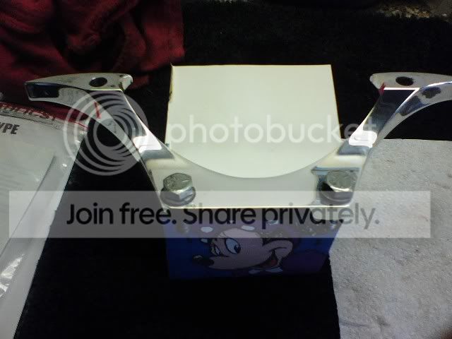

Next remove your fender and your struts from your fender
Man these bolts are ugly as hell

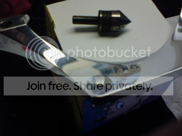

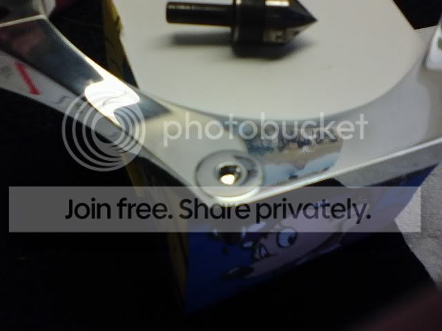

Next, using a counter sink bit and your handy cordless, countersink the existing bolt holes. Careful though you don't want to go to deep.

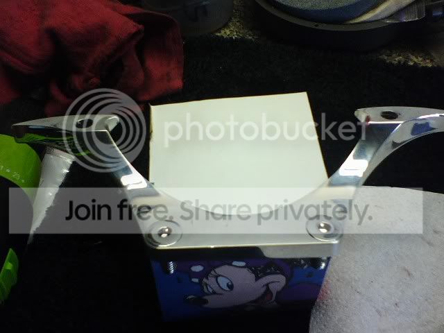

Perfect fit
Now that is more like it

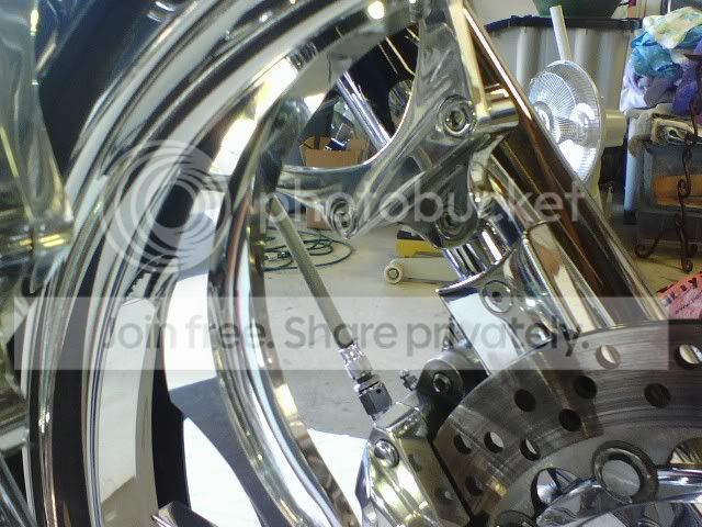

This is much nicer looking, sorry I should have taken a before photo but I forgot. Just go out and look at your BD you will see what I mean.:eek:

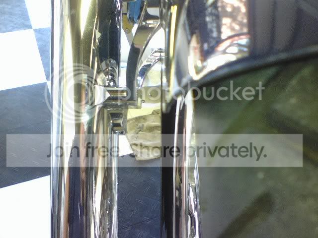

I did have to do some very minor tweaking on my fender after installation but it was very minor. I was comfortable with this because my bolt holes were almost exactly the same size as the bolts so there was virtually no adjustment to the fender anyway. Review your setup thoroughly before diving in on your ride.
