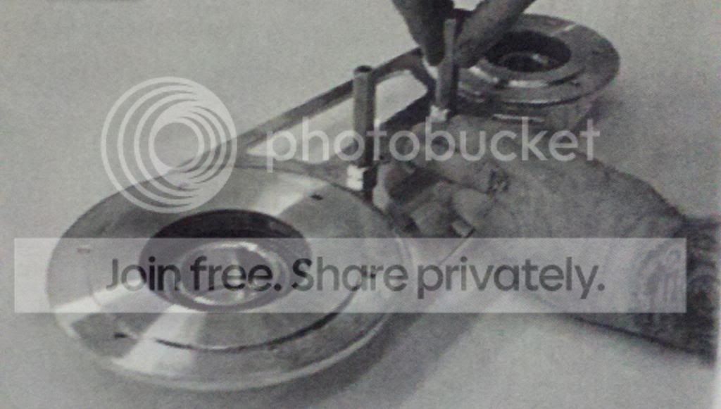

Sorry that I didn't take a photo of the interior of the outer support, but I copied the photo supplied by Baker.
Enclosed in the outer support are sealed bearings which truly support the spools. They are attached to the spools with 6 screws to each spool and it is a very rigid design. In this photo I am puttting screws through the outer support into the spools for a "trial fit"
of the dogbone and to set the standoffs length.

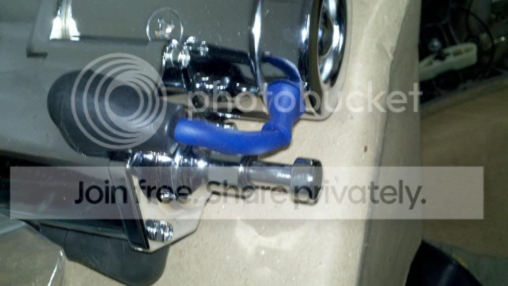

Ok, yesterday I finished the Baker Open Drive/transmission rebuild/starter upgrade project. While I had the starter on the bench, I had Curtis(Wild Steed) send me a slam button and new boots for the starter. Here is the new boots and the slam button installed(easy upgrade of rotton rubber).

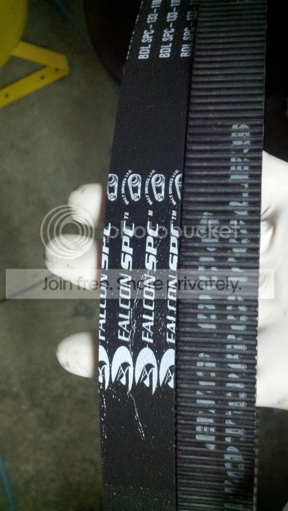

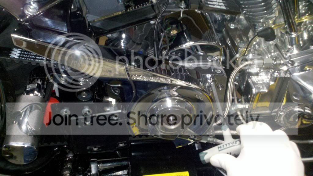

With a chunk missing on my drive belt, I had Curtis(Wild Steed) send me a Falcon drive belt. It has a shiny smooth texture on the top surface as compared to the Gates.

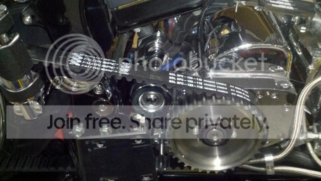

Here is the belt installed as well as the started put back in its place.

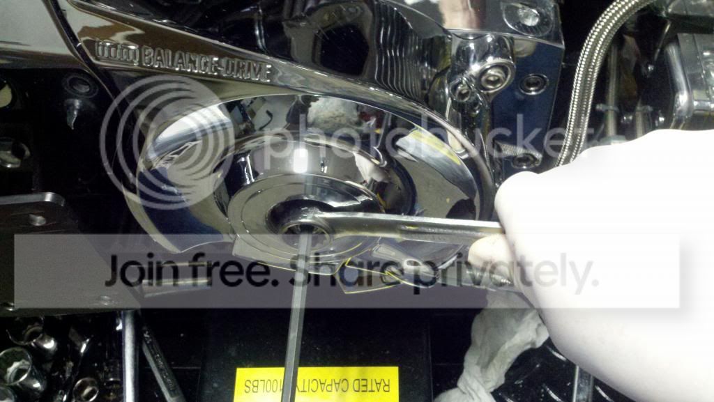

Replace the belt cover.

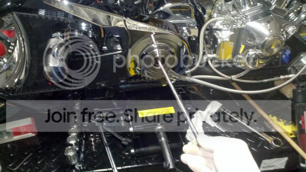

Now the clutch rod which I have well lubricated is slid back into the transmission.
Turn the rod into contact with the throw-out bearing and back off 1/3 turn and lock down with the lock nut.

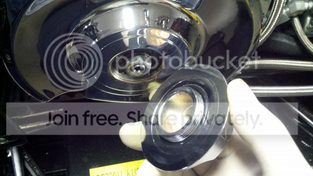

Replace the cover with a light coat of lube on the O-ring.

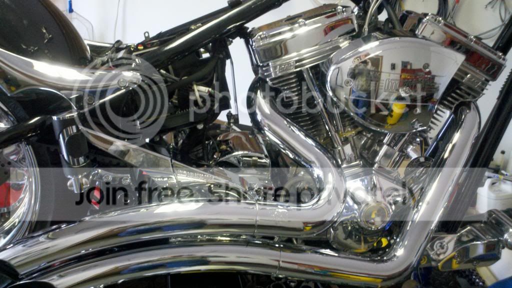

Reinstall the exhaust with new gaskets.

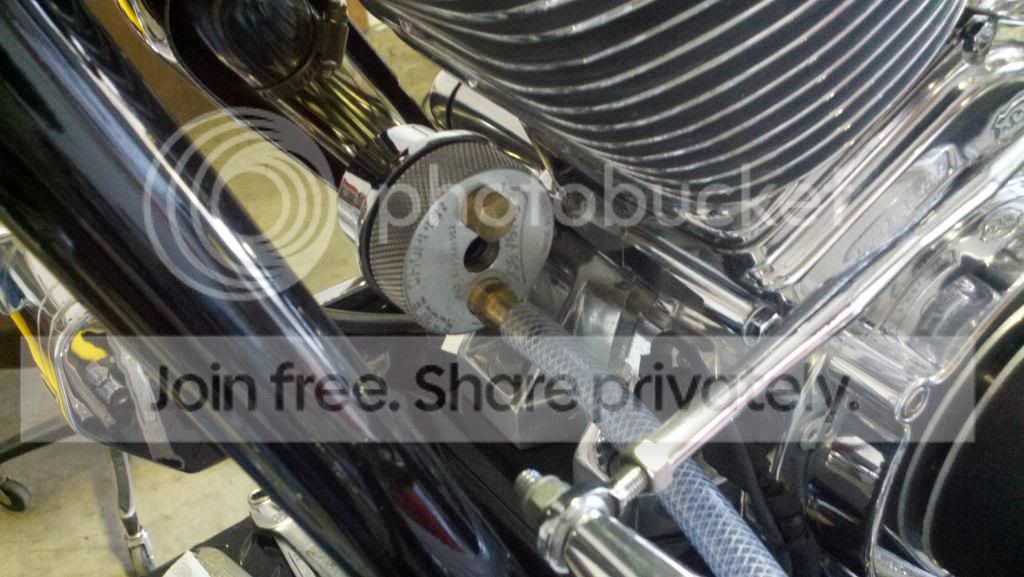

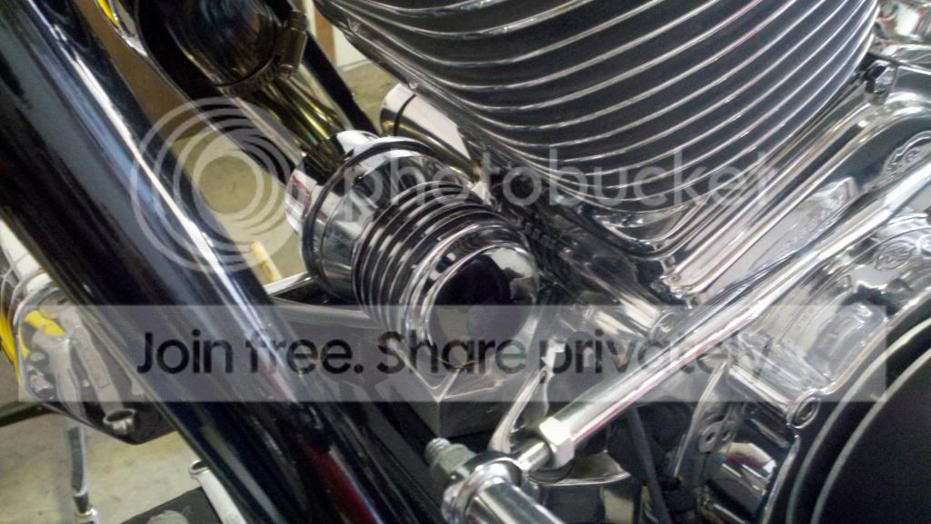

Fill the oil tank and install the Scavenger system I got from Don(Value Tech) and run the motor until clean oil shows.
Reinstall the K&P oil filter, once again from Don(Value Tech), and top of the oil tank.

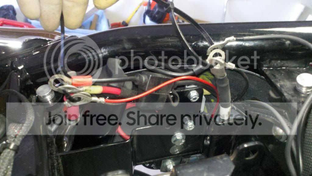

Reinstall the batter which has been sitting on the tender for the last several weeks. Notice how I zip tied the terminals as I removed them to avoid any confusion later on. This is a easy way to prevent a bad day! Coat battery terminals with dielectric grease!
