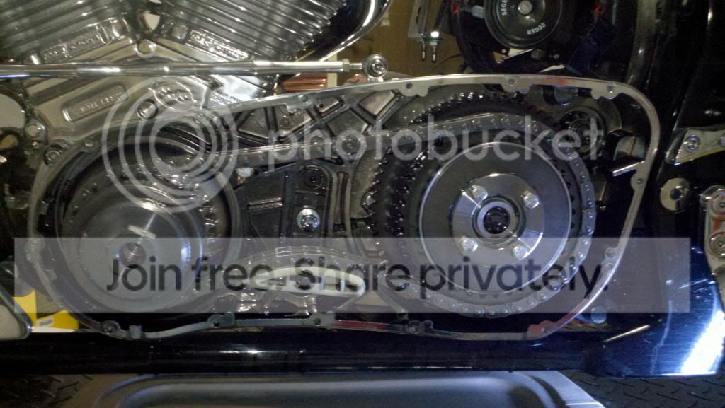

Remove the clutch, the crank sproket, and chain adjustment shoe. Then the inner primary.

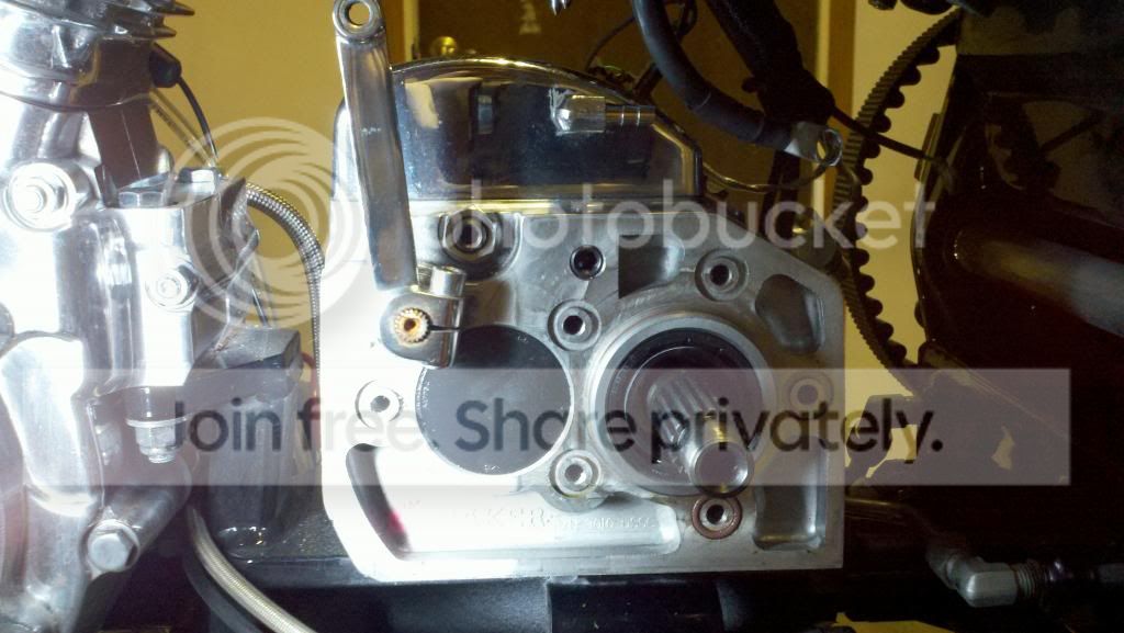

Remove the transmission and get it on the way to Andrew. By the way, I removed the bolts on the transmission from the side by using a box end wrench that allowed removal without removing the shocks.

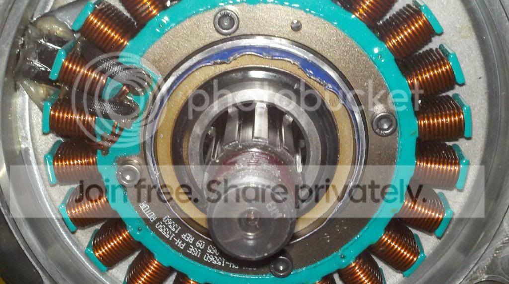

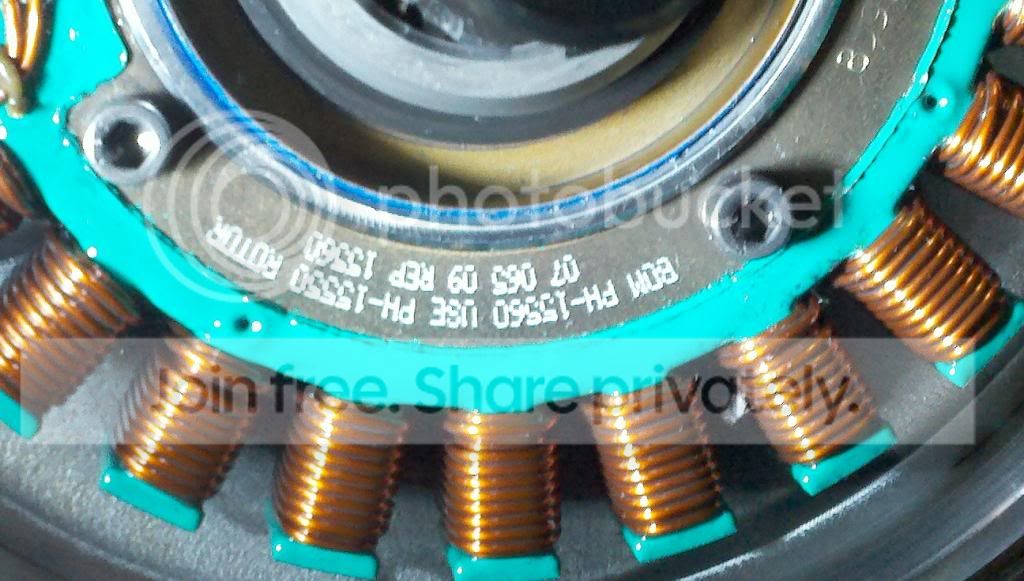

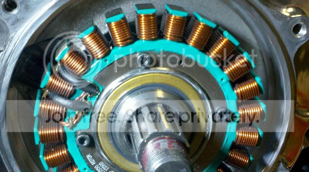

Stator cleaned and ready for new seal.
Removal of the crank seal was easy with a few taps from a sharp chisel on the rim and then a couple taps with a slide-hammer and it was out.

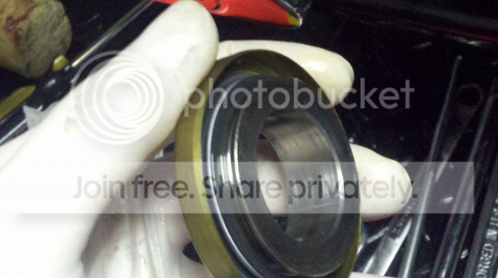

New seal(Provided by Kaptin @ Wild Steed) reversed, lubricated, and inserted onto the crankshaft bushing and slid into position.
New seal seated into place.

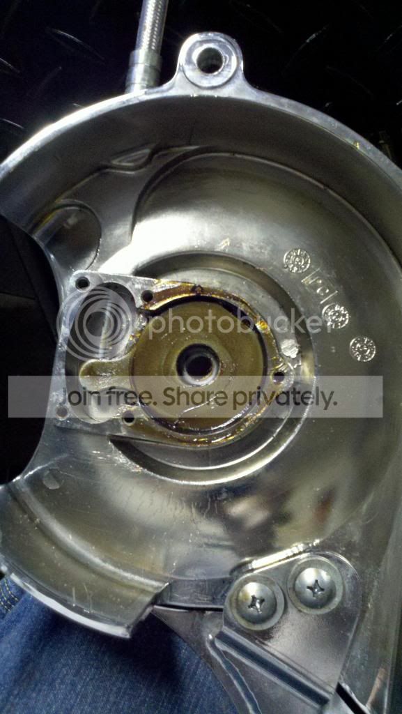

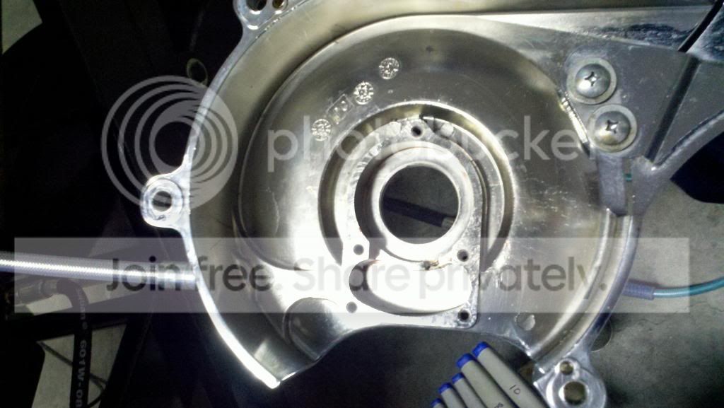

Removal of the stator cover, oil cleaned off the stator and block, cover cleaned and ready for replacement.

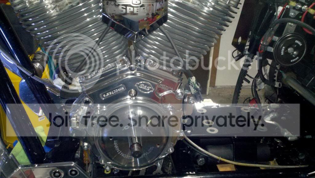

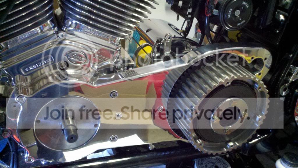

Stator cover replaced and ready for fitting of inner primary of belt drive.
Notice no transmission yet, Andrew was held up waiting on a new drive pulley from Baker. Transmission should be here Monday. Initial trial fit of the inner primary revealed a lack of clearance on the inner primary and it would not seat on the block. A little time with a Dremel tool and some careful removal of the tight spots and the inner primary is now seated on the engine.

My transmission did have shims under it but it was not sitting flat against the frame. After removing the bolts with a box end wrench form the side, I reached up to the top of the transmission and it was rocking from left to right like it was "High Centering". And as you said, Andrew is sending me some shims so that I can be sure to get it stable before torqueing the bolts down.

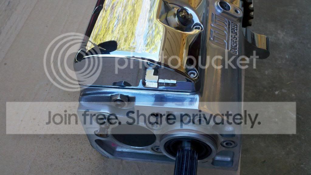

Andrew got the transmission to me on Monday as promised. I could not start the installation due to the compensator nut not working with the new drive. Ordered new nut and washer and today I got back on the project after picking up the nut yesterday.

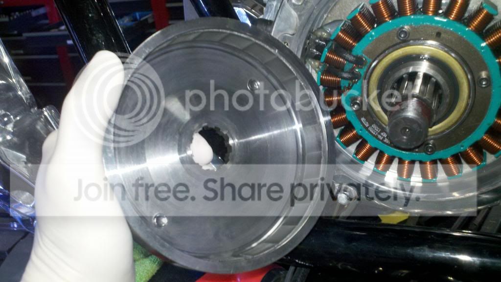

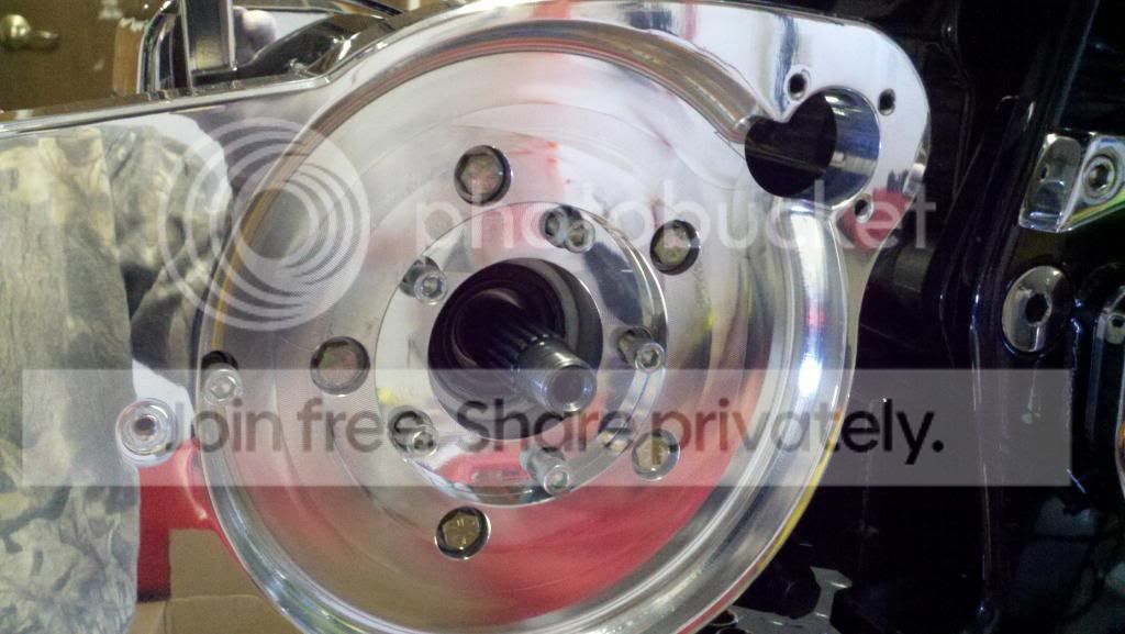

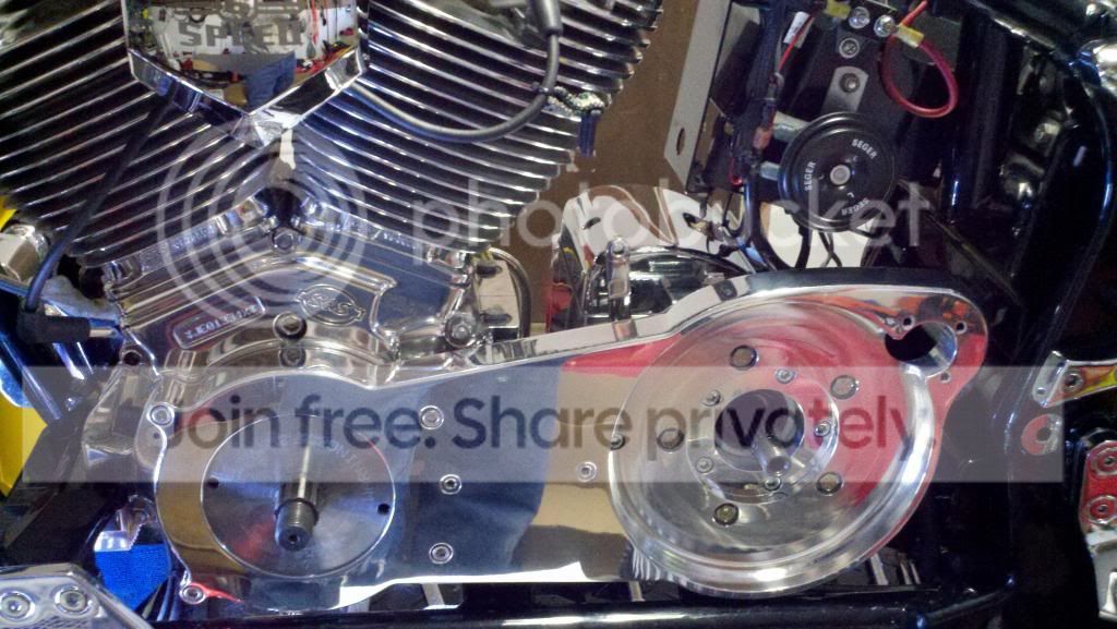

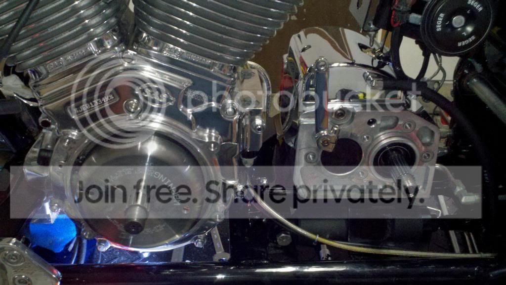

Removed the inner primary and set the transmission in the frame and loosely tightened the bolts. With the original shims removed, the transmission sat perfect in the frame.

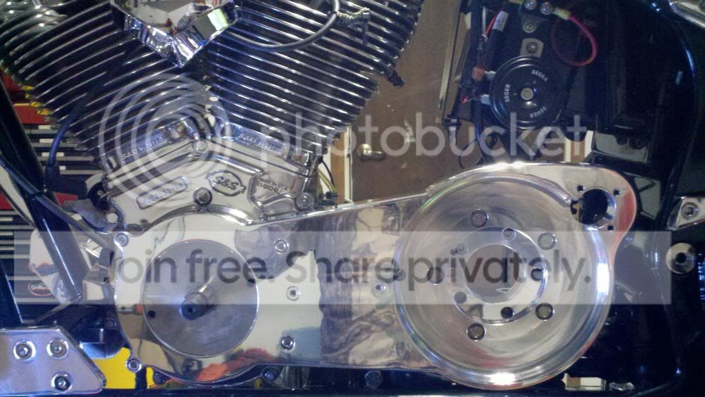

Replaced the inner primary and did a trial fit to the transmission.
Transmission tightened down and inner primary torqued to spec.

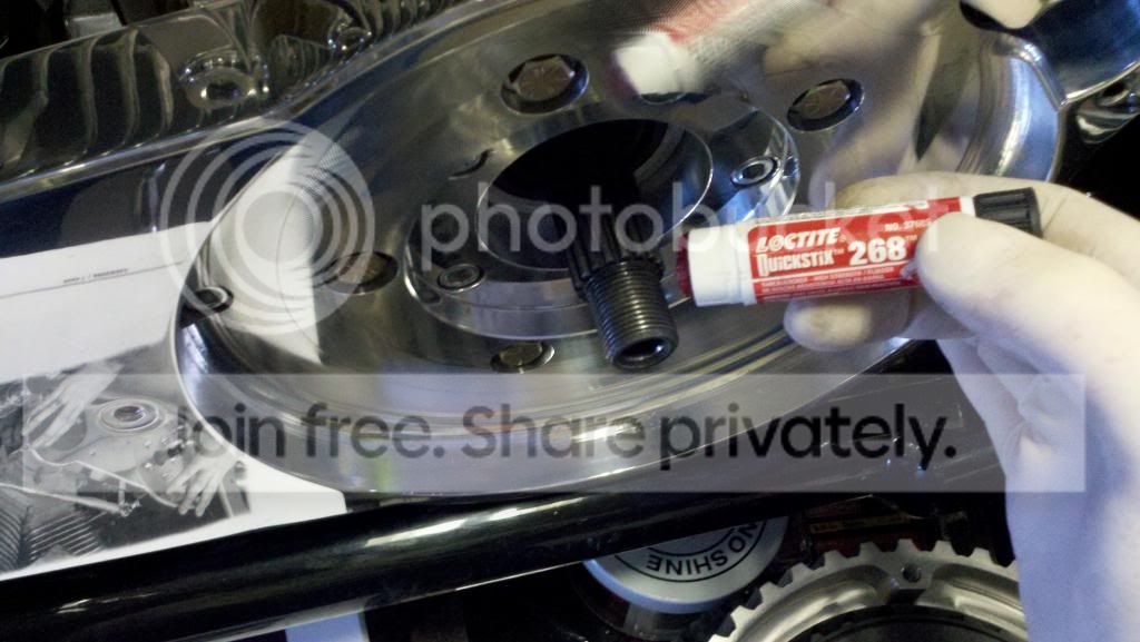

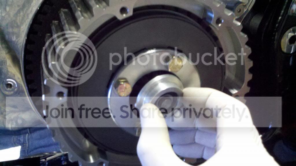

Locktite the transmission input shaft for the clutch.

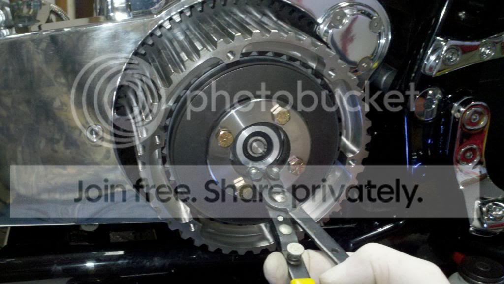

Clutch pack installed and torqued to spec.

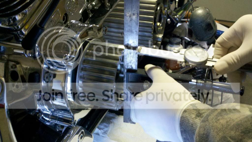

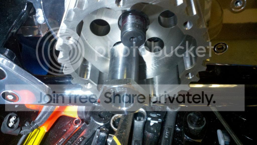

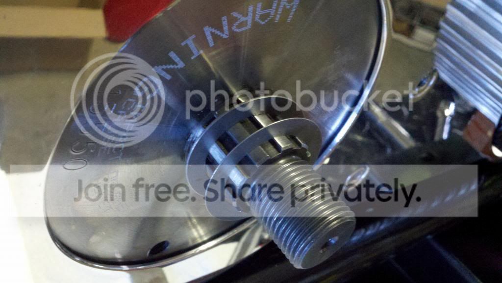

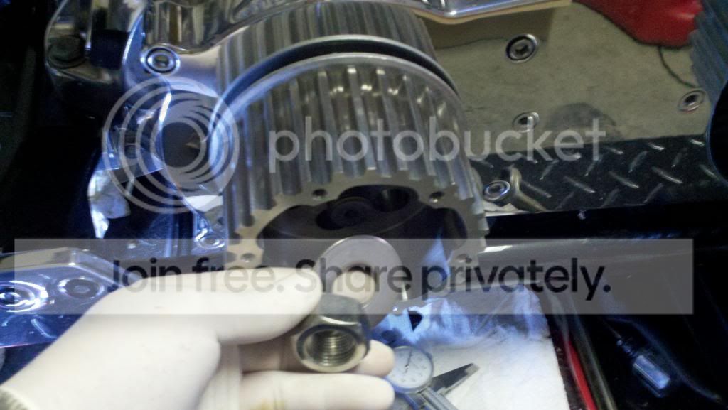

Install of front spool and measure for proper shim to align front and rear spools.
Shims selected and placed on engine crankshaft before spool torqued to 150 ft. lbs. with red locktite.
New nut and washer placed and torqued.

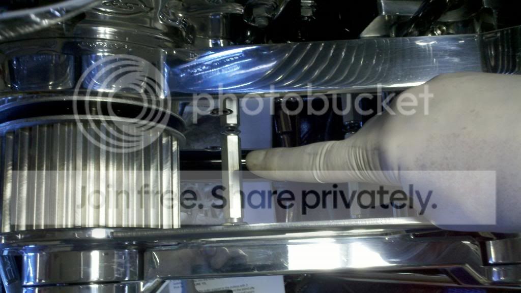

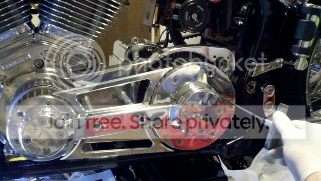

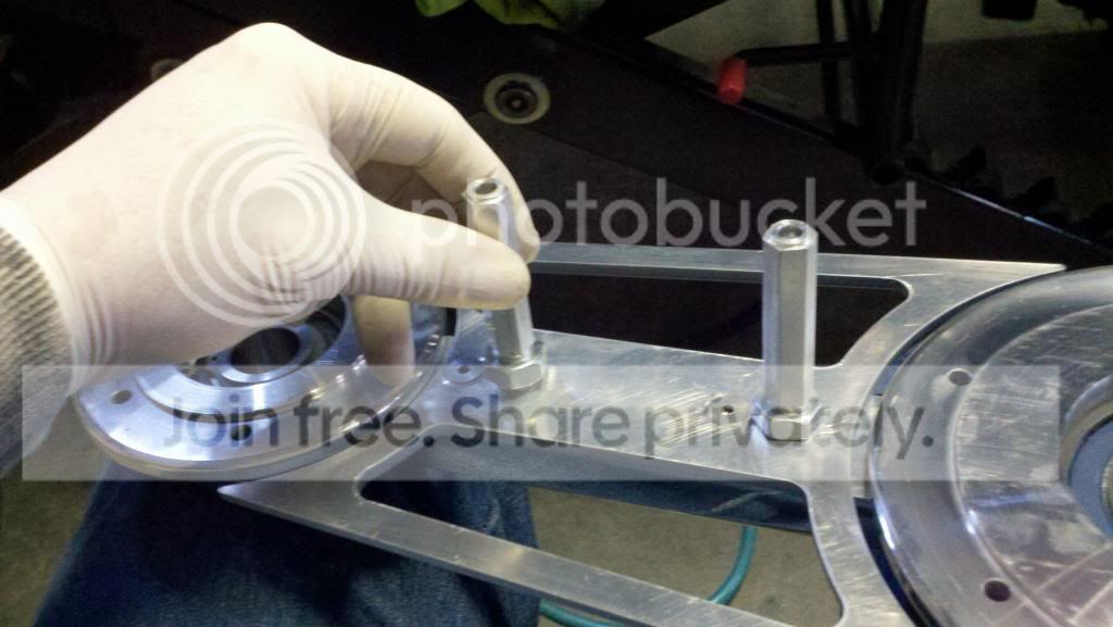

Standoffs loosely placed on outer support.
Temporarily install outer support.

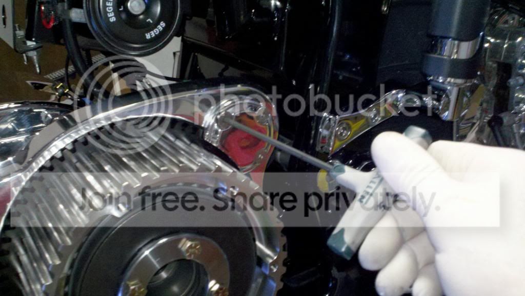

Adjust the standoffs to lightly contact the inner primary and tighten the locknuts.
Install starter pinion cover.
Install new throwout bearing.
Install the snap ring to secure the throwout bearing.

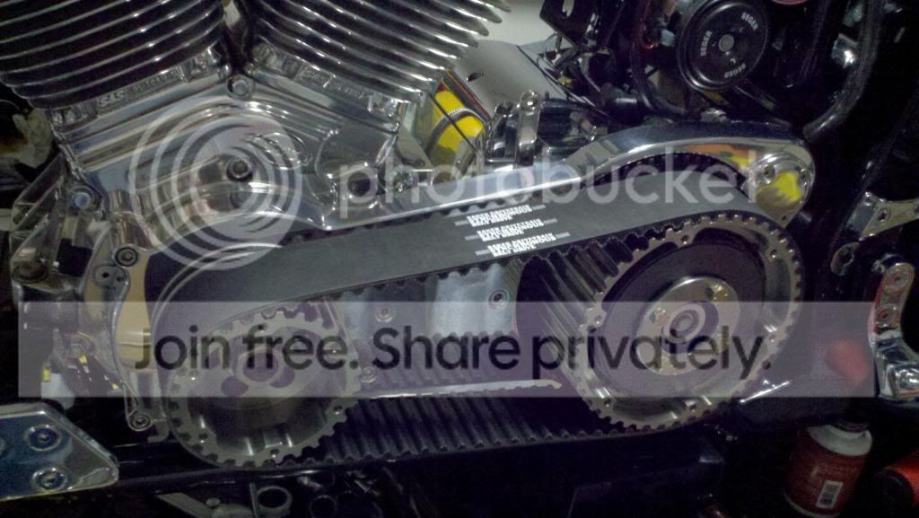

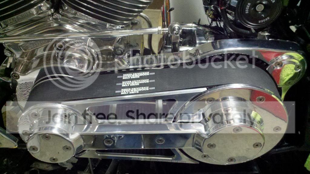

Install the drive belt.
Install the outer bearing support, and the new Baker Belt Drive is complete.

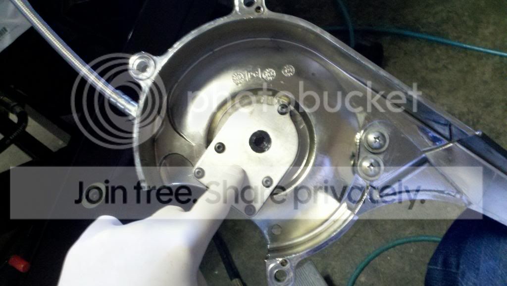

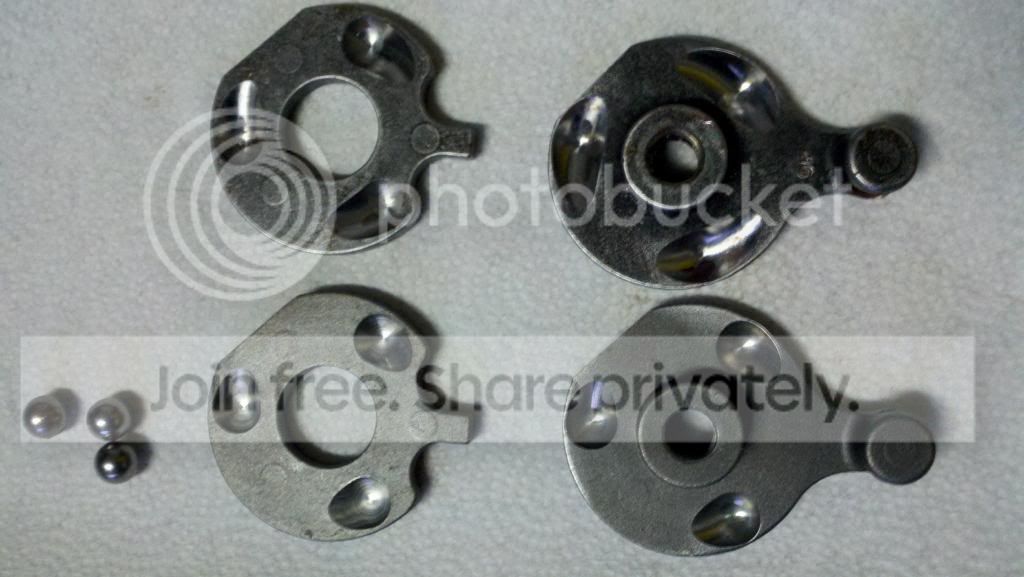

The new Baker Belt Drive comes with a new ball & ramp to properly disengage the clutch.

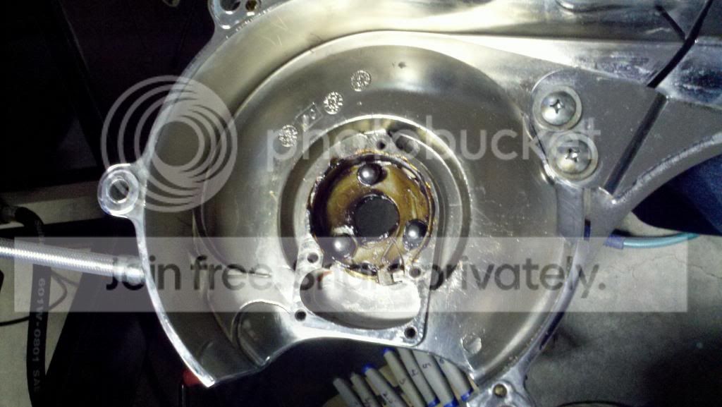

The ball and ramp are located under this cover.
After removing the cover the old ball & ramp were removed and laid out for comparison. The old parts are on top and the new parts are at the bottom. Notice the much steeper ramp for the balls, this will separate the clutch discs much faster and further apart.
Pocket cleaned and ready for the new parts.
Bottom half well lubricated and balls placed in the pockets.

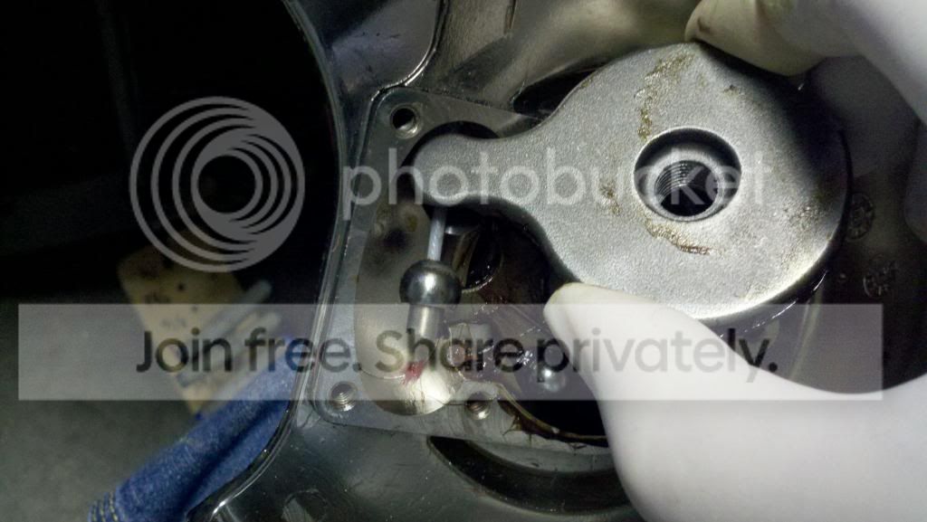

Top half lubricated and put in place with the clutch cable engaged.
Final view prior to replacing the cover.
