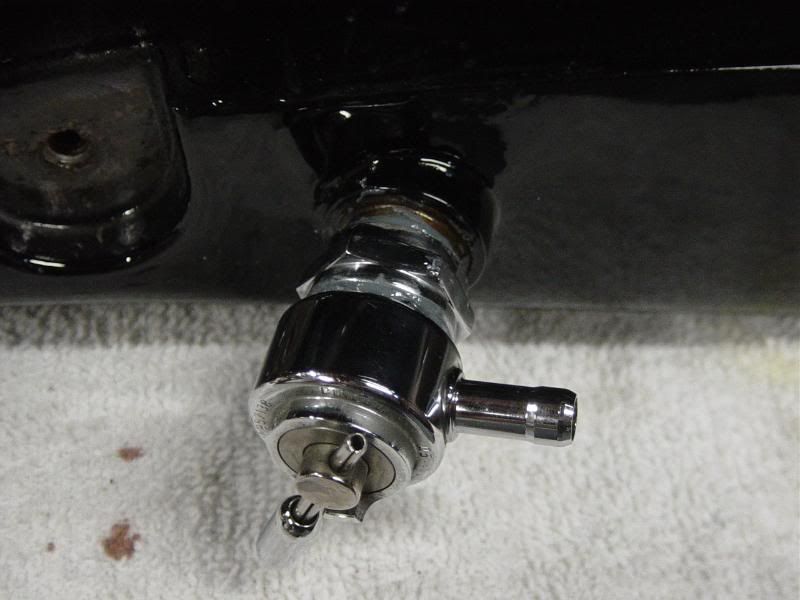

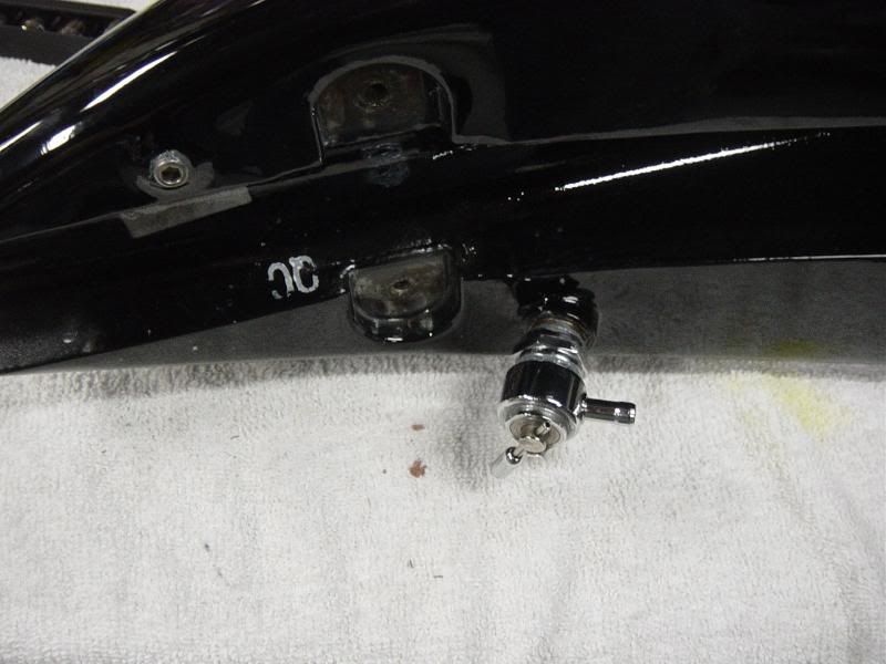

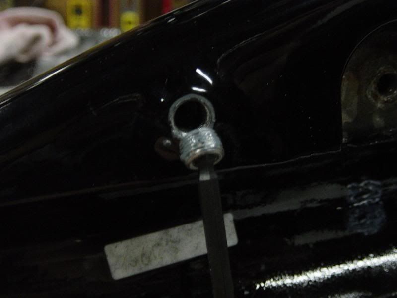

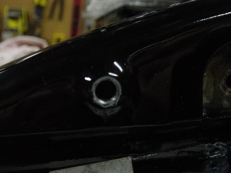

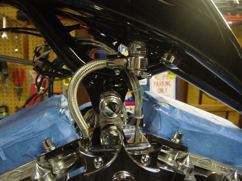

Well I flushed out the gas tank with some gas. Then installed the plugs and fittings.
The non-used vent hole
Dope and plug

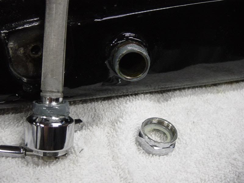

Dope nipple, install coupler and petcock. Understand that one side of the coupler is right handed threads for the tank nipple, the other side is left handed threads as well as the petcock.
BAM
Put the gas tank back on the bike for safe keeping. And checked clearance for the speedo stem. WAY more than before!
Also hooked up the gas line which will have to come off later to finish up wiring for the headlight and speedo/tach.

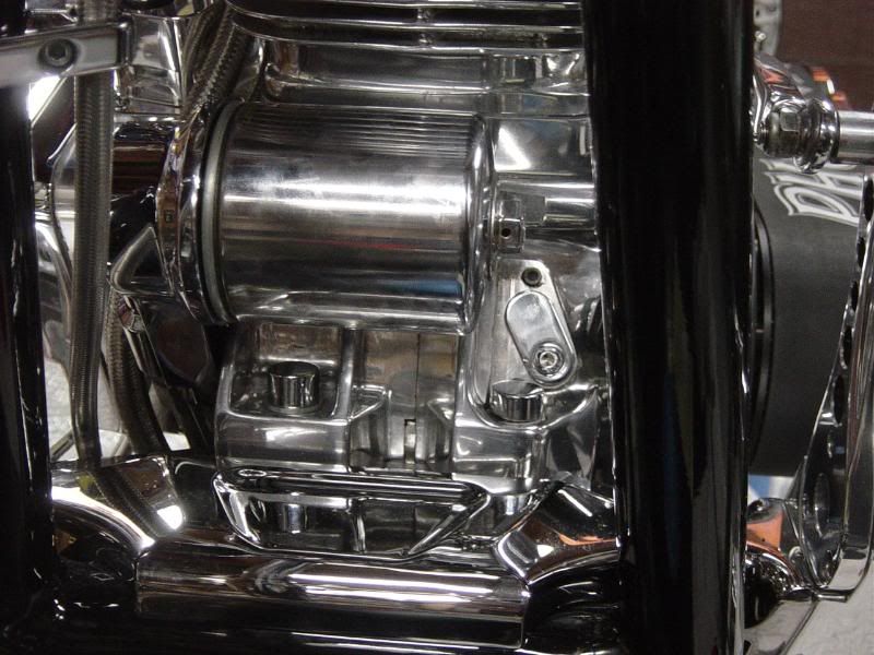

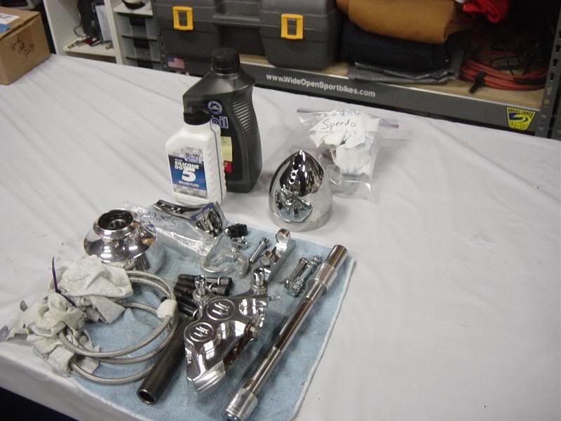

Then to get the bike ready to start... lets change/add oils.
In goes some Mobil 1 motor oil

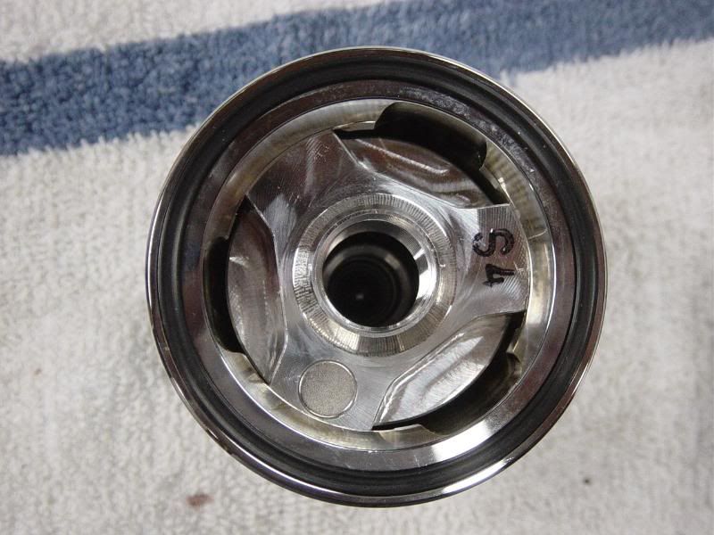

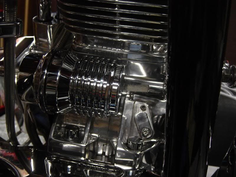

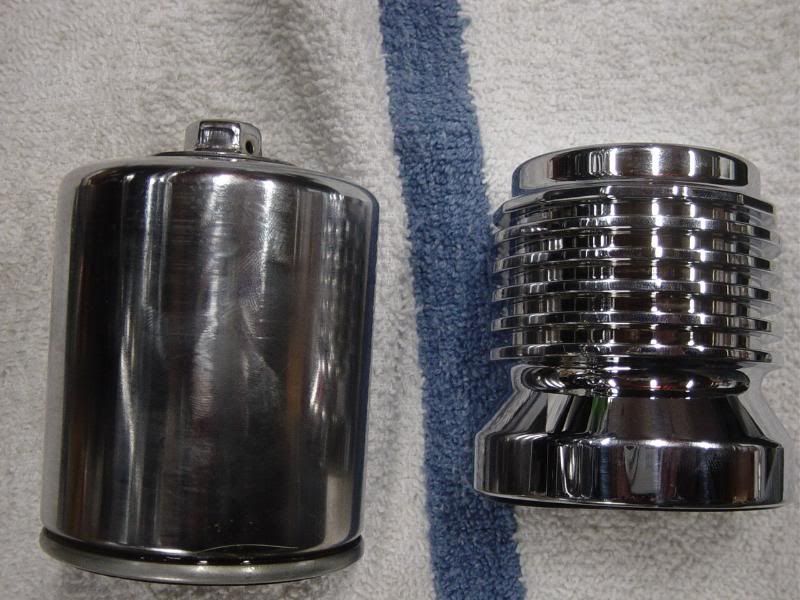

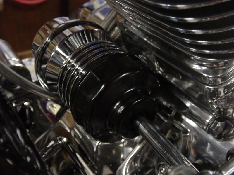

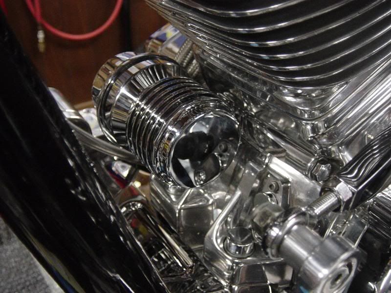

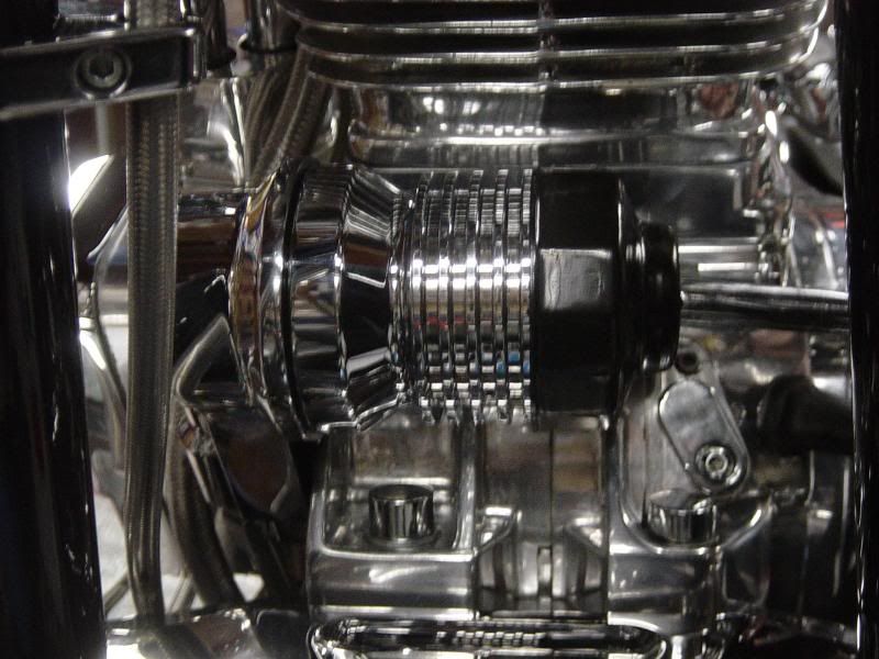

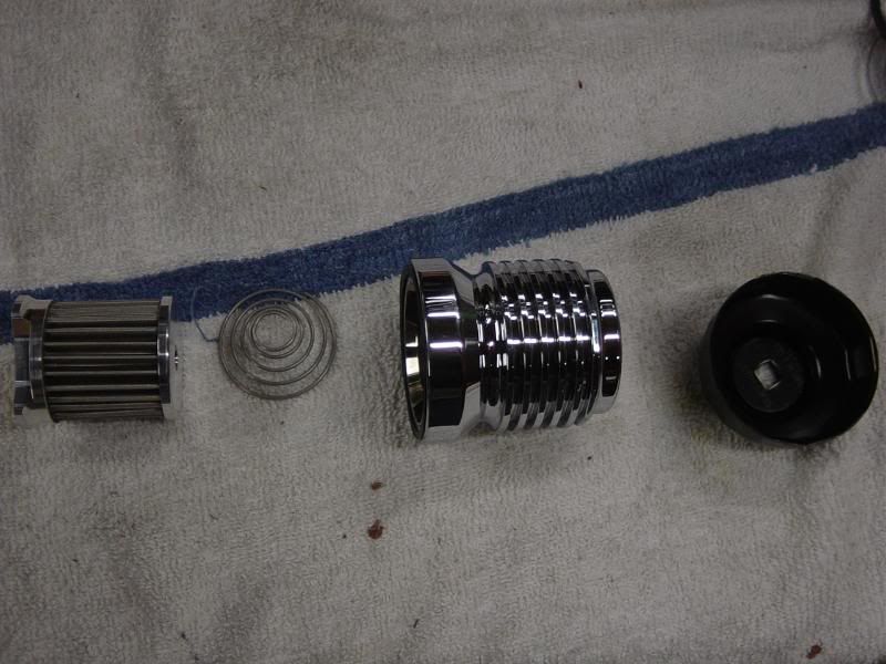

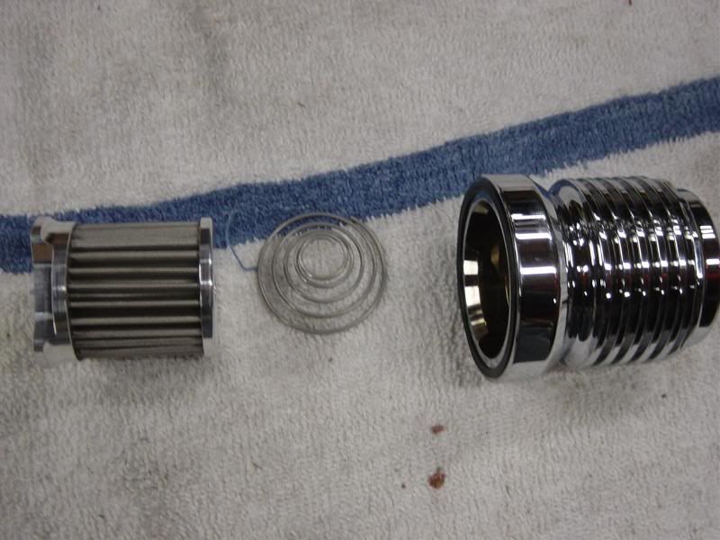

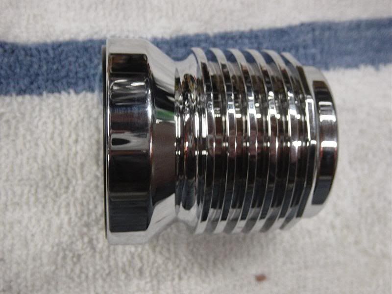

Assemble the sweet chrome K&P oil filter
The old K&N oil filter... YUK
never thought much of the oil filters till you do this..

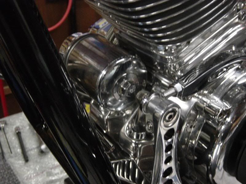

Wet the oring and install

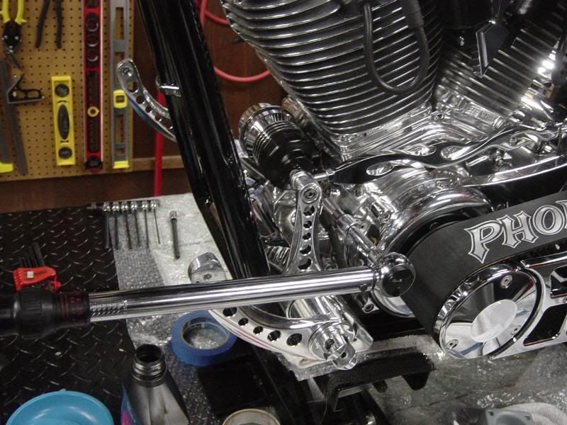

Torque to 22ft lbs
I never thought a oil filter could look soooo good!

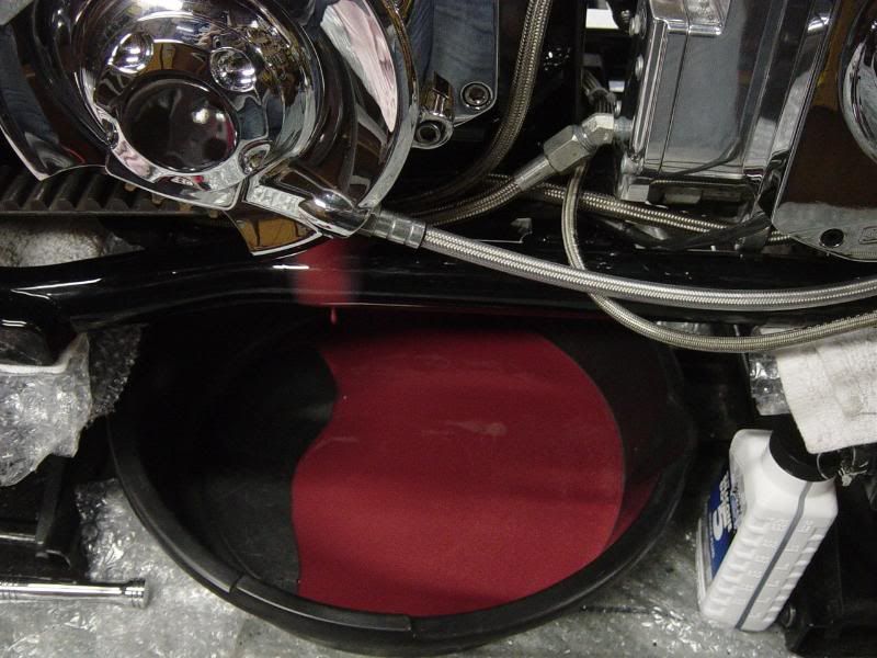

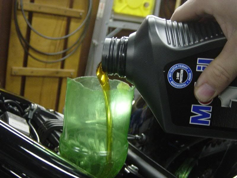

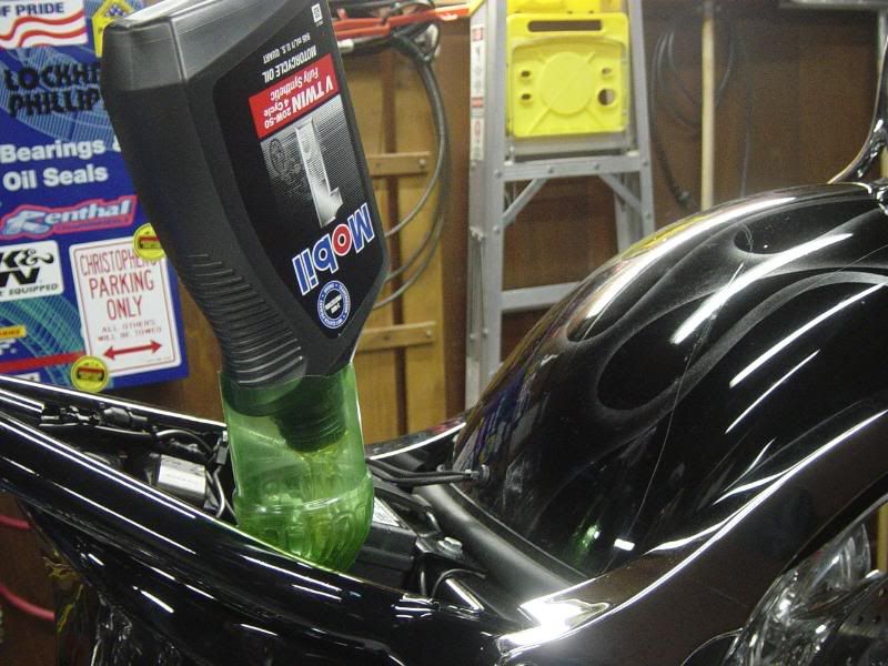

Drain the tranny oil

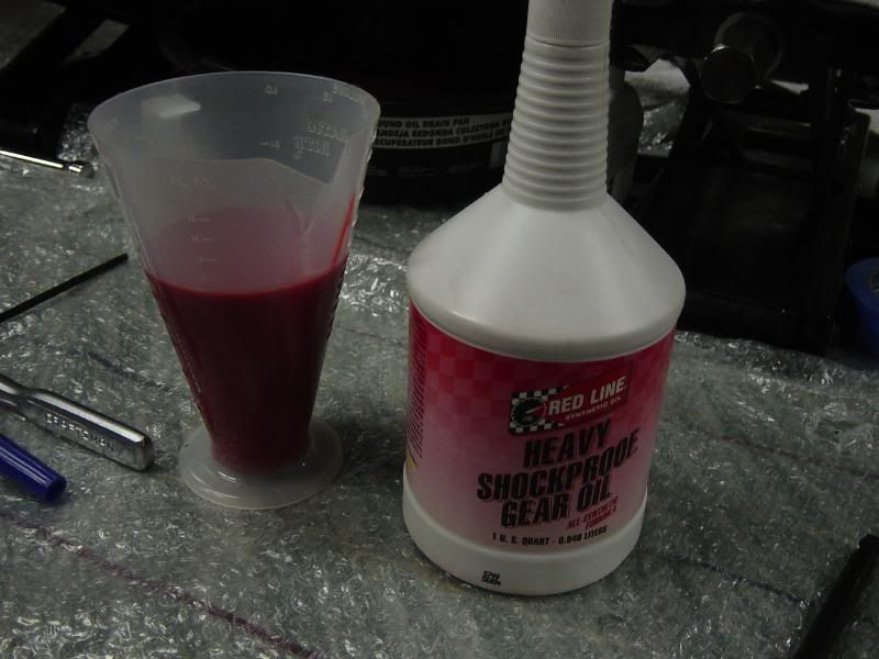

Refill with this 10oz..TWICE for 20oz

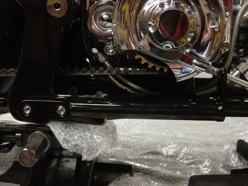

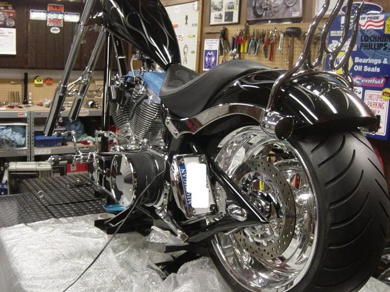

After cleaning up... only about an hour and half... but that's all I had time for...
Still need to bleed the rear brakes this week... while I wait on my front hub to return. And then I need to prime the oil pump, add gas, and start. But don't want to start till I get the front wheel together... don't want to chance it vibratig off the jacks..

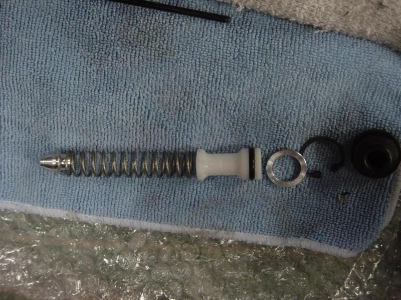

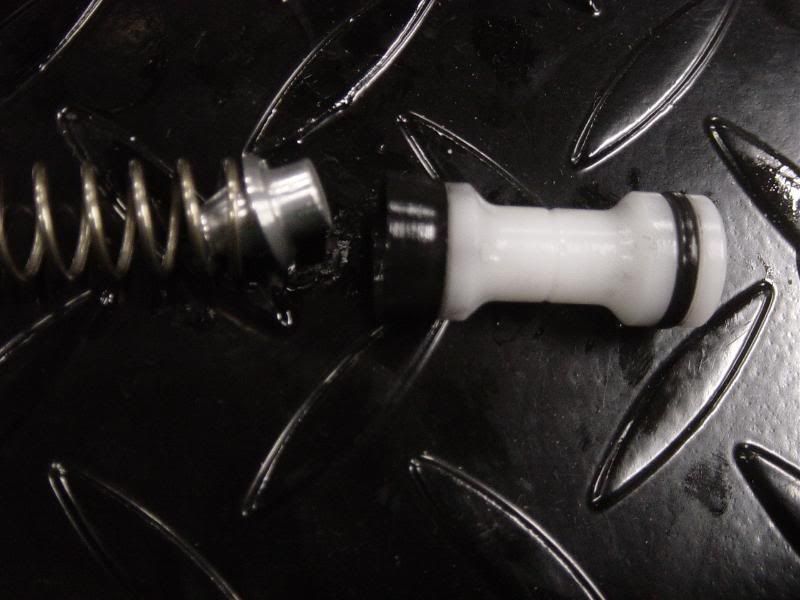

Finally figured out the rear brakes. I originally posted on page 7 about rebuilding. ( I have sense corrected so I don't give the wrong info)
The rebuild kit came with everything to do both front & rear. Further neither of the BDM directions in the kit or the service manual have a layout of how it all goes together. So I was using my used ebay one that I took apart as a model. That is where I got this layout...
However, after pulling apart my old wasted from the concrete rear master cylinder. The one I knew worked.
Guess what I found... the ebay one was fucked up, in the wrong order and missing a rubber cup.
So here's how its suppose to be...
With it like that, it actually pumped brake fluid... who would have thunk!!

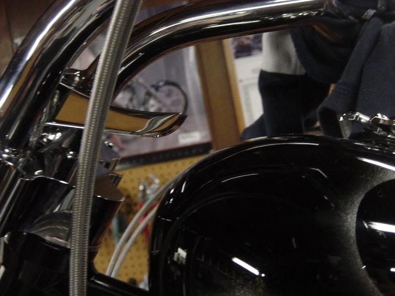

Then I mounted the mirrors...

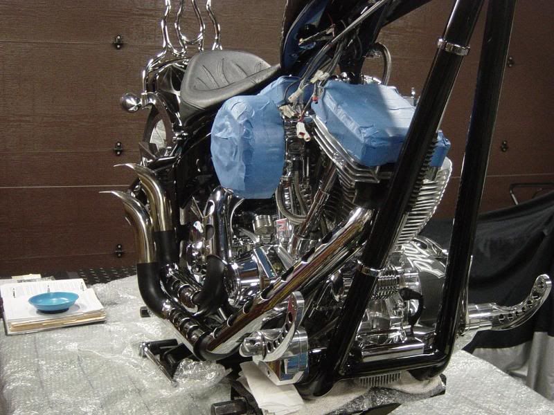

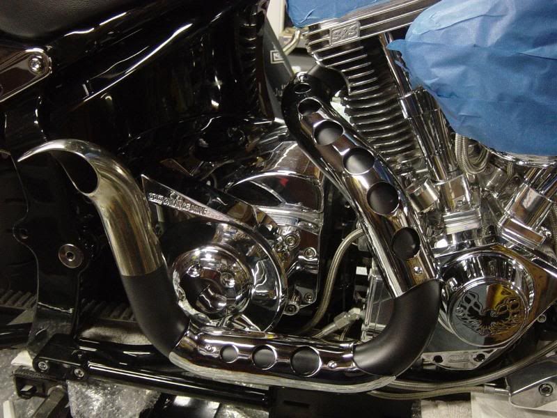

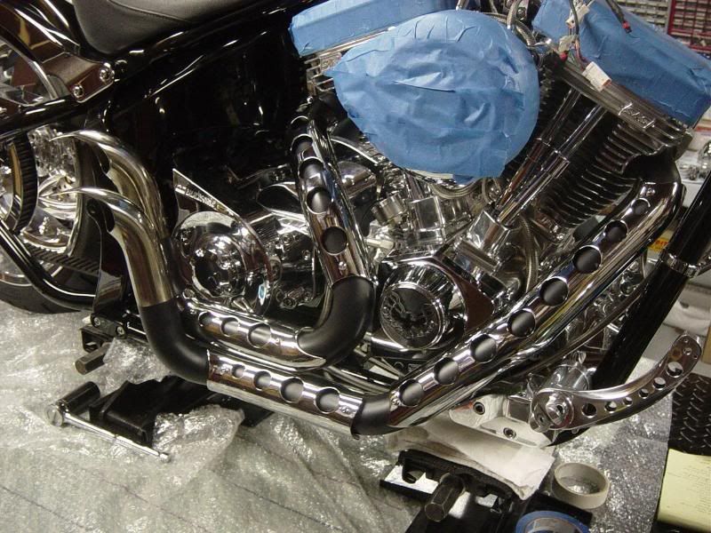

Now lets get to some good stuff... custom exhaust!!!

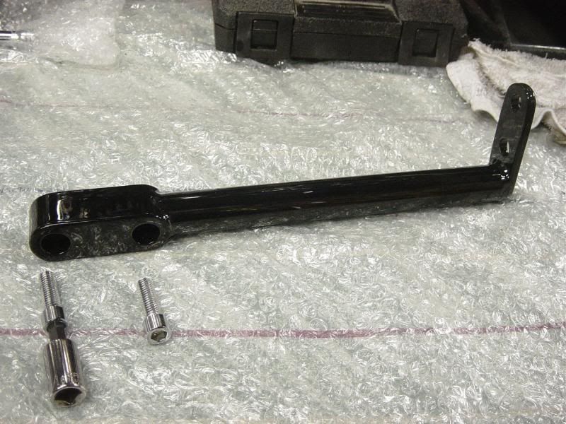

Install the exhaust mount
I love how well the mount blends in with the bike and you will barely see it once its done.

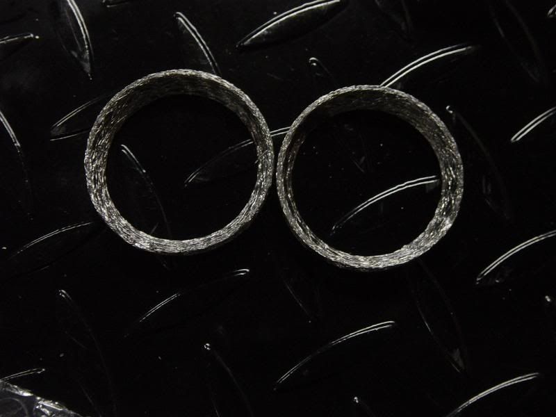

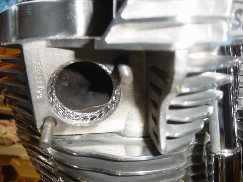

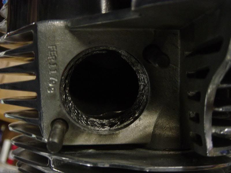

2 new exhaust gaskets
With my pipes you have to mount the rear first. Do this by loosely bolting at the head and the lower mount. Then torque at the head per BDM instructions. ((20in lbs at the bottom, 70in lbs top, 70in lbs bottom))
Then install the front... oh boy...

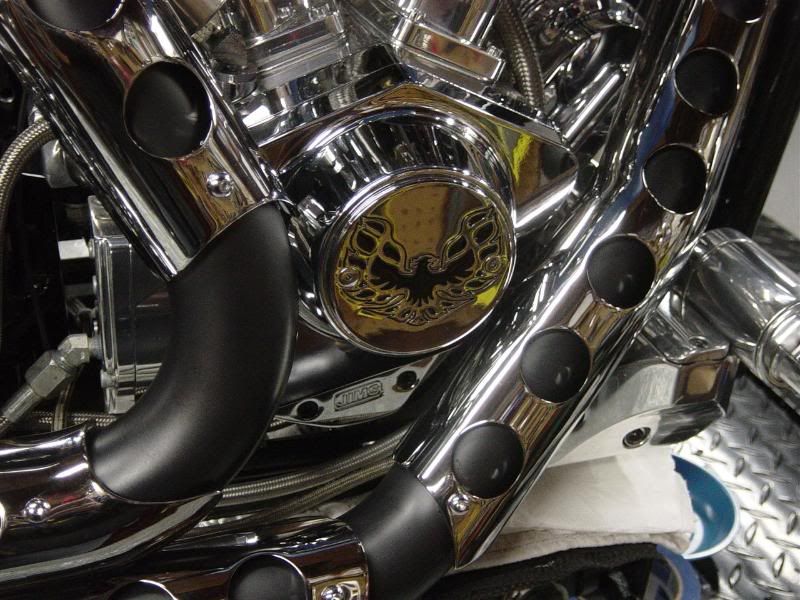

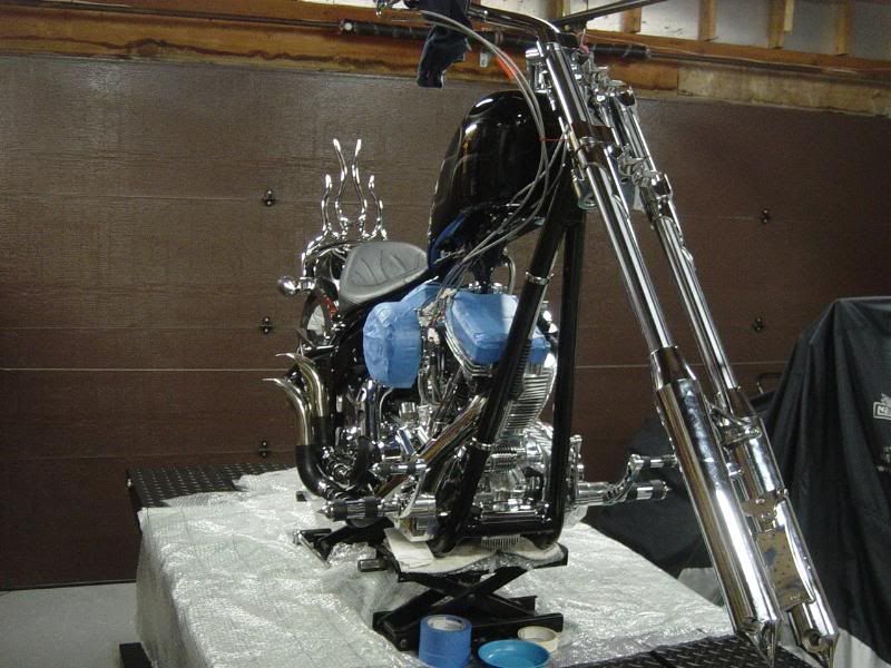

Here's a shot of the Phoenix covered cam cover with the exhaust installed

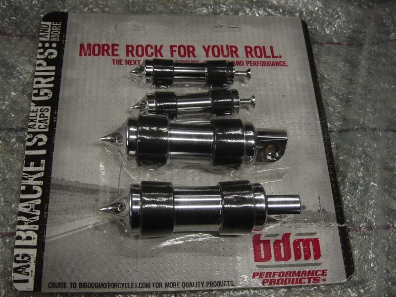

Now mount some pegs
Left side looks nice..
But the right side with the speed holed exhaust and controls... just work well together.

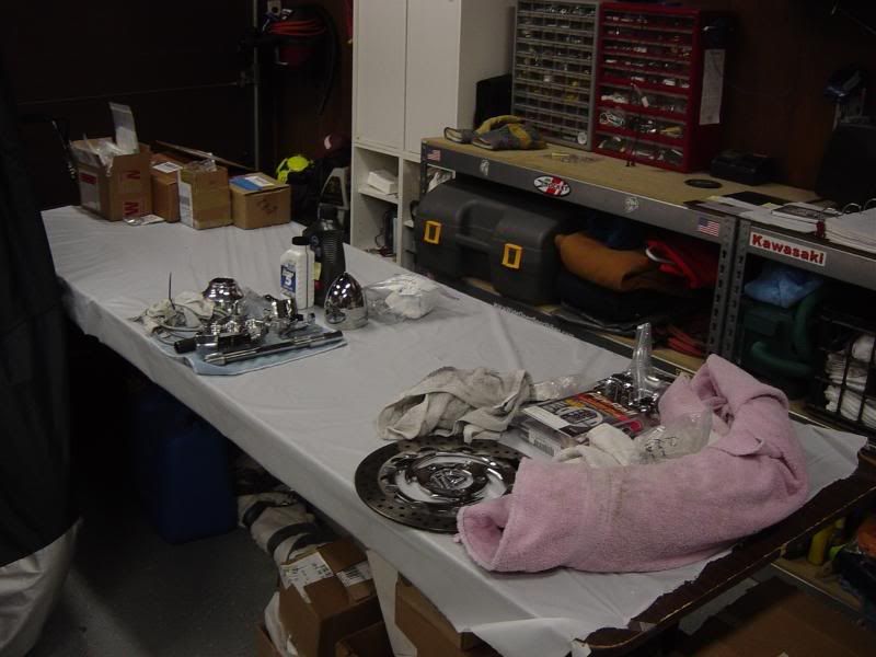

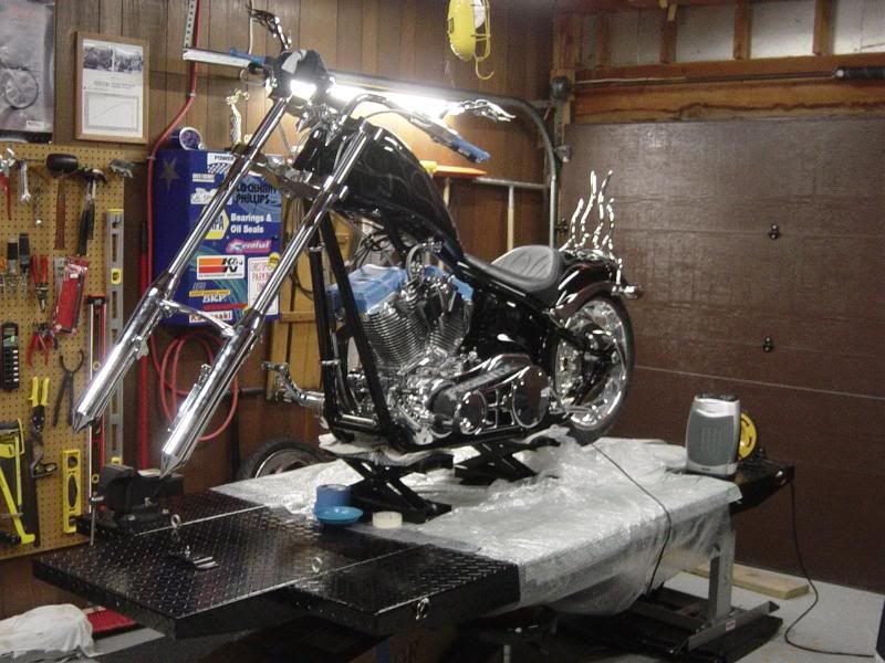

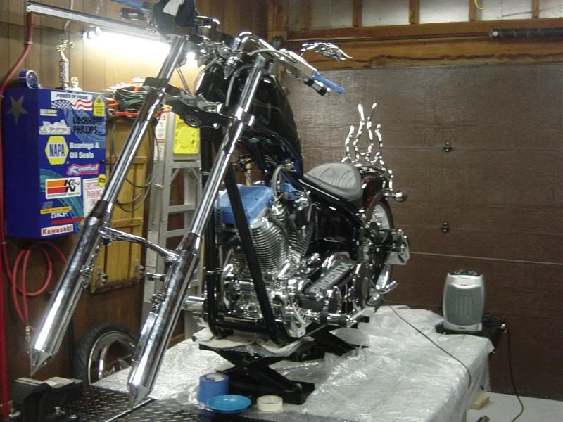

Then organized some things in the garage and got things in order. Man it has come so far. You can really tell by looking at the table.
The stuff closer to the door is either junk or spare parts. But there isn't much left to do or install
Here's the bike after today. Obviously the best part done is the exhaust!!!
