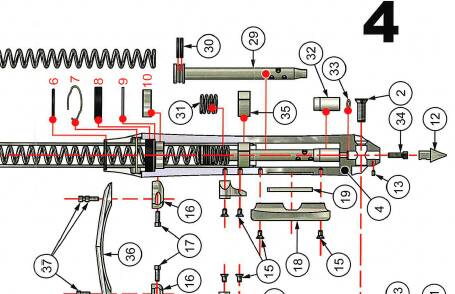

The bushing on the left in your upper picture - the one that "slides on the tube, but is seated in the lower leg" - that bushing had to be pressed into the lower leg during assembly. It presses into the leg when you pound the seal in. Actually, I used my PVC tool to press that bushing and large washer in first, then I came back and used it again to tap the seal in.
I'm wondering if the bushing OD was too large for the lower leg, and that why its seized into the lower leg. The press fit bushing isn't coming out. Now that I think about it, I did have to tap them in pretty good when I changed them last year.
