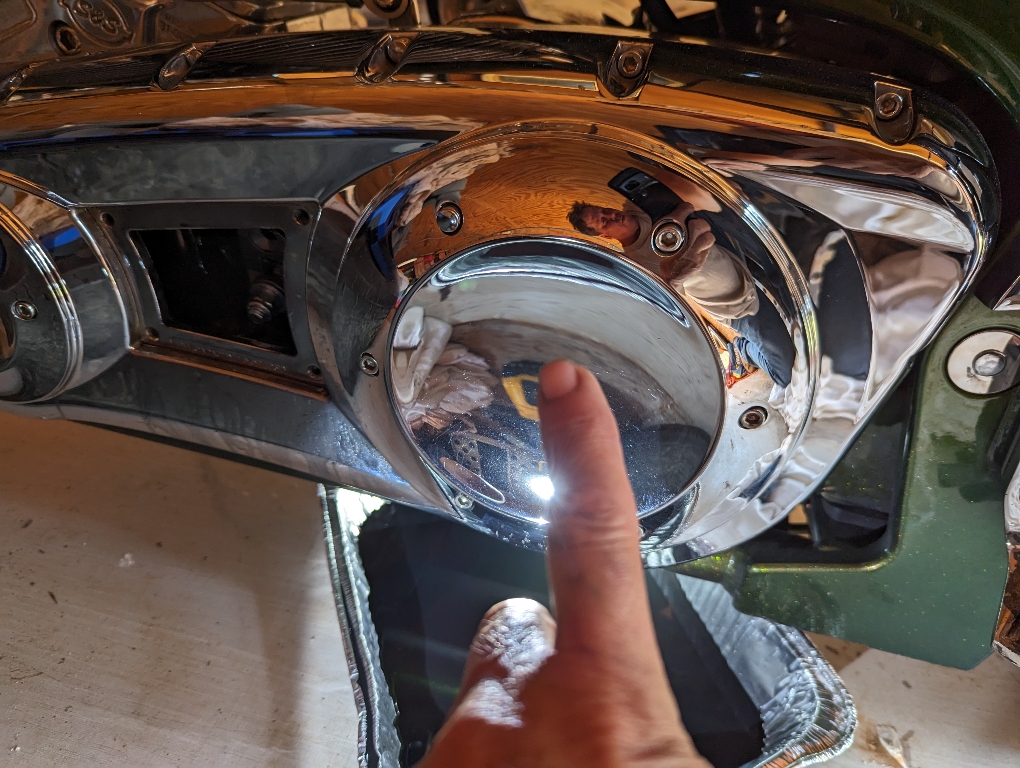

Screw size in primary
I did not see any but I will but I will look. I did over tighten the bolt that holds the adjuster. Thought somebody told me 25 ft lb and I was doing it doing it and snap so I have to go get that tomorrow before I finish and then started up and hope everything sounds right

Just to follow up, put the bike back together today. Tightened everything up to specs. Adjusted my chain before I put the primary cover back on. Put in the fluid cranked it up. Took it for a little spin. Everything road and went perfect. Just want to say thanks everyone for all your help. I always greatly appreciate it. Hope everybody stays cool this week cuz it is a damn hot one for sure

The only thing that i would have done different is i would have pulled the engine sprocket off and the flywheel to make sure a piece of that bolt or shaving didnt get up in the flywheel area between it and the stator....flywheel is a magnet so that the reason i would have done that...not saying anything made it up there in that area but i would have wanted to have a look while i was there because that can mess some shit up quick
