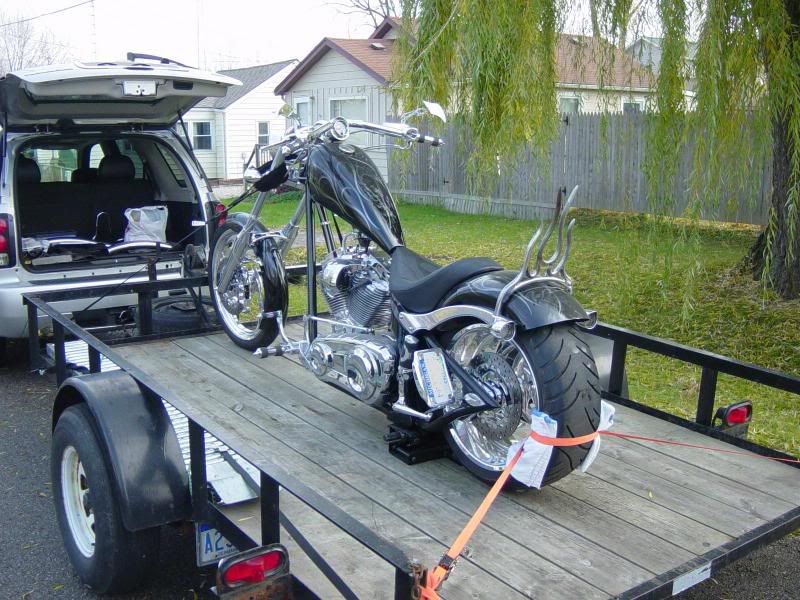

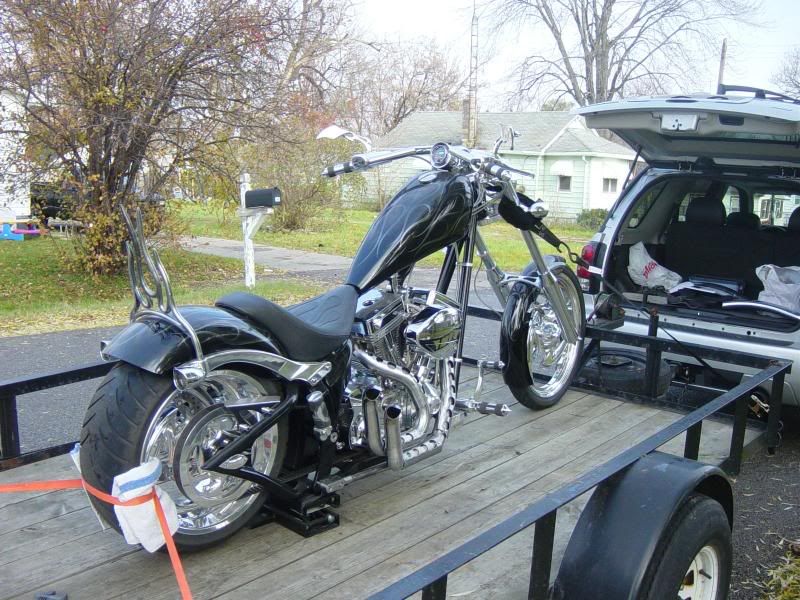

Ok-got a stupid question. Why the jack under the frame? It looks like I'll be hauling my from Okla to NC. in a couple of weeks, and it's the first time I've hauled it that far.

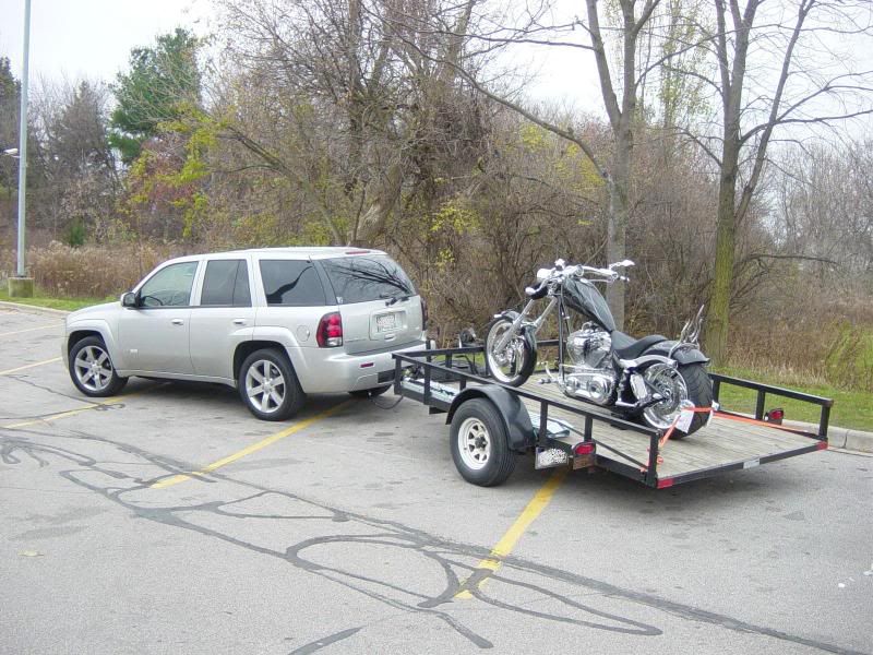

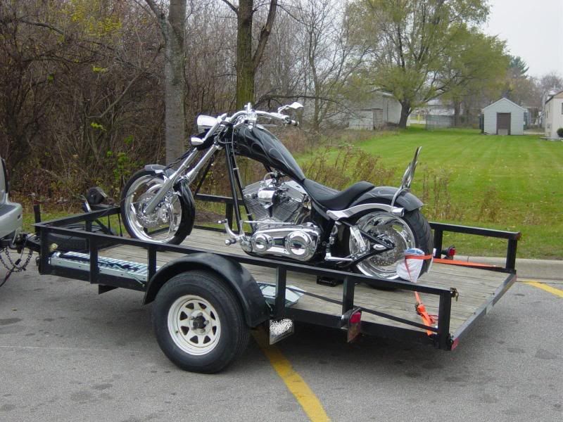

The jack was under there cause I was loading by myself. It held the bike upright.
The other week I saw 2 d-bags trying to load a bike on a trailer. Some jap cruiser. I stopped and told them they were doing it all wrong. They had it on the kickstand and some stupid array of straps. Gave thema few pointers and kept on my way. I'm sure they thought I was just some jackass... I sure hope it made it home ok.
Anyway, what they weren't doing makes me think of this now. Make sure your front straps are going forward and out. The idea is compress the forks. Don't get too crazy or you'll have to get to my service your forks thread sooner rather than later.
Then for the rear all you want is something to keep it form bouncing around. The 2 centers are just cause it was my first time with the dog and I was nervous. As you can see from my other pics... I didn't run the centers.

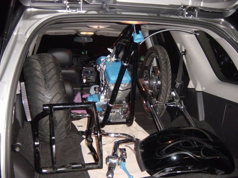

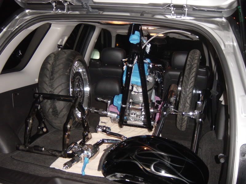

Also did this once... :lol:
