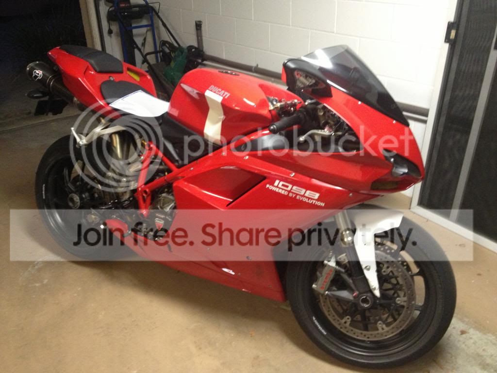

Here is a pic of my other bike:
I am sorry to announce that as far as acceleration and speed is concerned it will smoke any Big Dog, any day of the week. My sister races the 848, and again I am sorry to announce the same result. As far as fun to ride on the street - not even comparable, the Dog wins flat out. Even with the 212HP S&S motor in it will it ever have a chance against a Ducati when it comes to speed.
As for the shock problem, I sure hope you find the solution and will get the Dog back to riding like it should.
I knowI am getting off subject here, but is that thing comfortable to ride.
