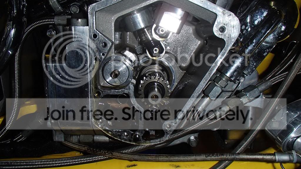

Thats from anothet tread but it did spark something in my mind..... while rotation the rear wheel I did notice THE pushrod from that rear exhaust lifter jumping out out of place on the lifter .... Could it be the cause??? yes, I kept rotation the wheel and it jumped back into placePushrod tube keeper = the upper portion that clips in, and keeps the tubes from collapsing.
Never, unless they're leaking.
Never, unless they're noisy. You have hydraulic lifters. Set them once PROPERLY and forget them.
Tinkeritis will ruin sh*t all the time. :bang:

I can turn the rods after just 10 minutesWhen you originally did the 4 turns the lifters are pumped, after sitting they bleed down so that you can turn with your fingers, if it is still tight after 20 minutes then it needs to be backed off cause its solid. The 4 turns is supposed to put you in the middle of the pushrod adjustment and then the hydralic lifters take over from there when you fire it up, they self adjust with the oil.
Thats fine, some don't take as longI can turn the rods after just 10 minutes![]()
Not too sure they were pumped... I was draining the oil at the same time!When you originally did the 4 turns the lifters are pumped, after sitting they bleed down so that you can turn with your fingers, if it is still tight after 20 minutes then it needs to be backed off cause its solid. The 4 turns is supposed to put you in the middle of the pushrod adjustment and then the hydralic lifters take over from there when you fire it up, they self adjust with the oil.

So..Franco what you took away from John's post was your lifter jumping out of place? I hope you will take away once you got your pushrods set....you dont need to touch themThats from anothet tread but it did spark something in my mind..... while rotation the rear wheel I did notice THE pushrod from that rear exhaust lifter jumping out out of place on the lifter .... Could it be the cause??? yes, I kept rotation the wheel and it jumped back into place
What setting them PROPERLY means? I thought those can only stay in one position!
If you could turn them with your fingers after setting a little while, they were pumped. If they can't be turned after sitting you are bottomed (solid) and bending will prolly happen. Listen to AndrewNot too sure they were pumped... I was draining the oil at the same time!

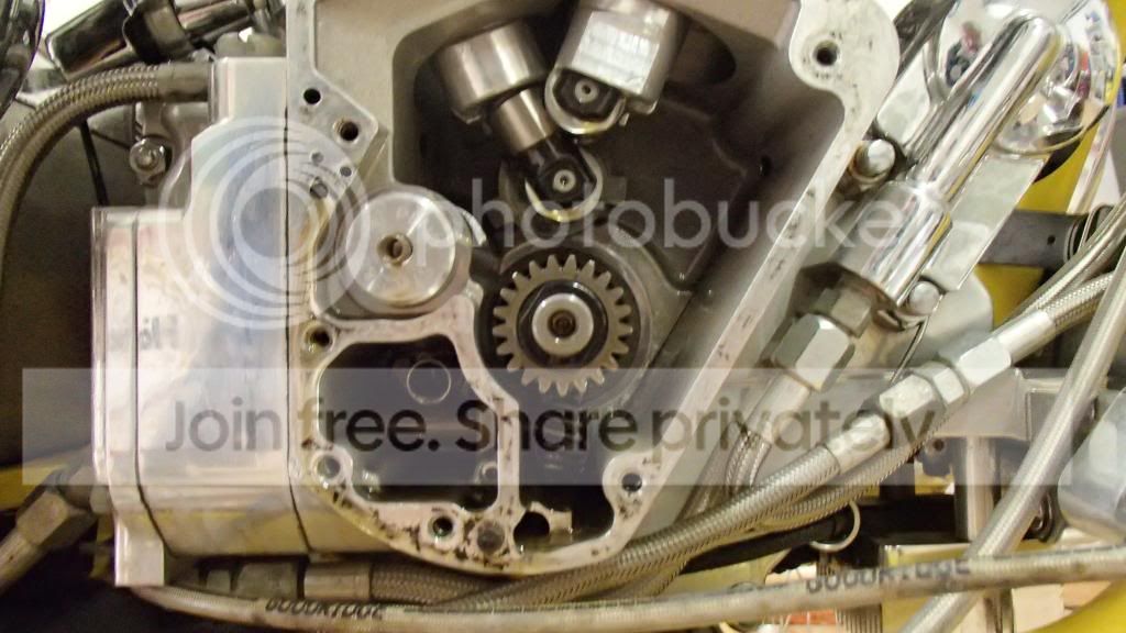

Awwww Andrew.... I wish I had the necessary tools... I am doing my best with my fingers LOL opppps after re-reading this it sounded weirdYes you need to align marks on cam with mark on pinion gear. You have 2 marks on cam, one will not be used because you have a reed type breather, but the one mark on cam will point towards the breather and the other will align exactly with pinion gear. DON"T MESS THIS UP!!
As far as the lifters go, you really need to take them out of the tappet block and check for any play on the wheels. They should have some side to side play, but no up and down. Know what I mean?
You might be able to check with that cam cover off, but really at this point should take at least the rear out because that's the side giving you problems.
Do you have the alignment tool for the tappet blocks to install them correctly?
He he Eric... :lol: just noticed your post now.... I am stressed out :bang:So..Franco what you took away from John's post was your lifter jumping out of place? I hope you will take away once you got your pushrods set....you dont need to touch them:roll::lol::loony:
