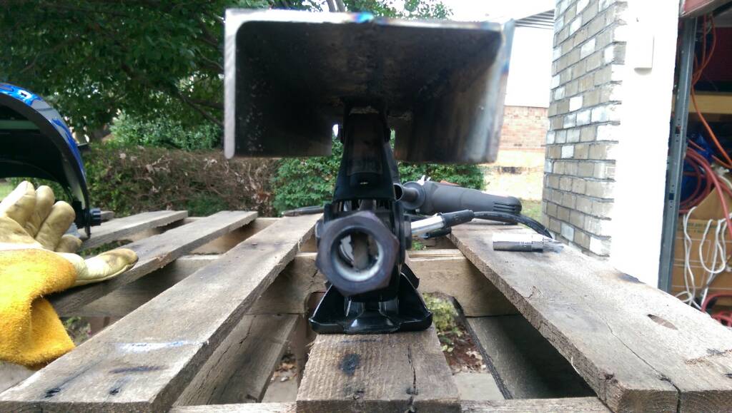

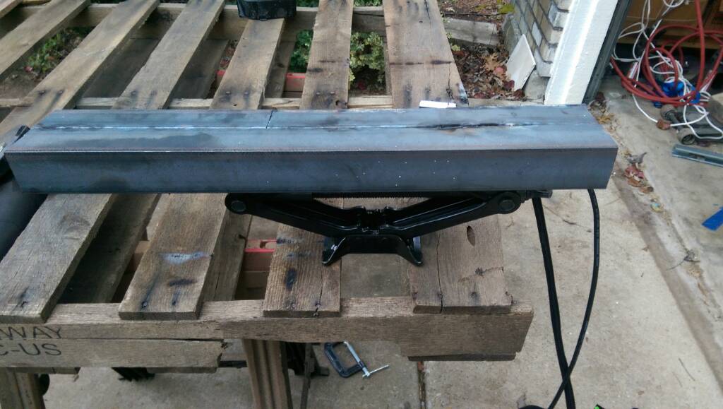

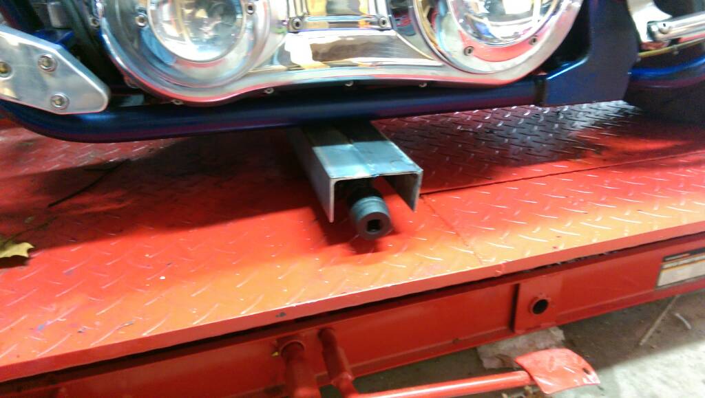

Was playing with my new Welder today, it's a cheap welder from Harbor Freight but I bought it to weld up the exhaust on my CJ and figured what else can I do?

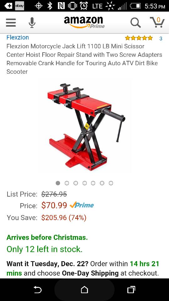

I've been needing a Jack for the table lift so I can do oil changes and rear tire changes on the table lift. I looked online and they wanted like $80-$100 for one of these

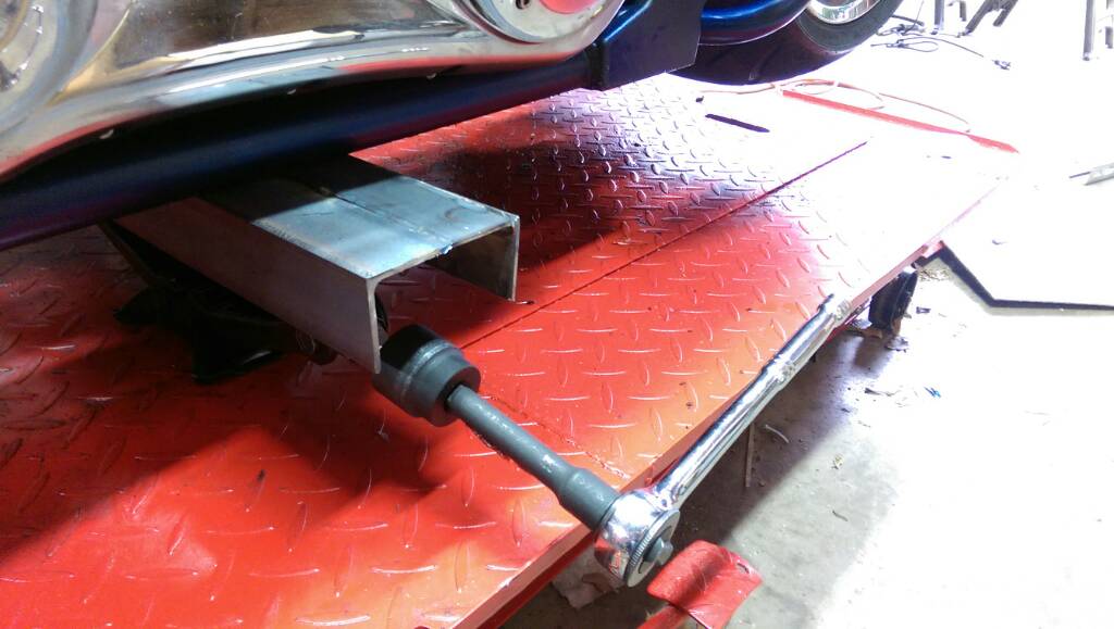

Came out okay but works great!! Had a car lift and I also used the old baker clutch hub nut and welded that on so I can use the impact to raise the bike ! Might make another one so I can distribute the weight better.

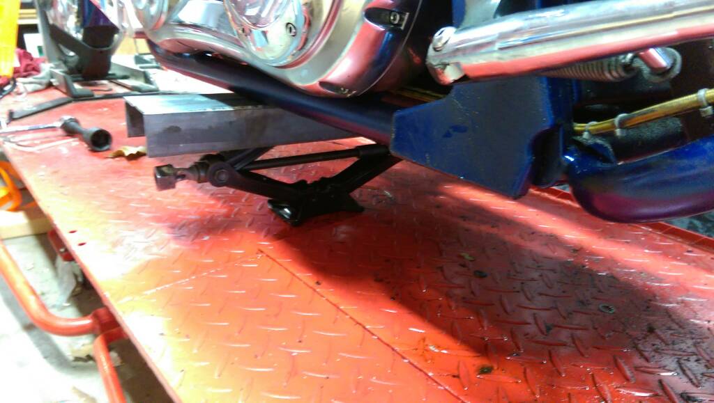

I also got a PM from a member regarding lateral movement and I agree with lift along with lateral movement hence why I mentioned I need to build another one. Anyways, this is why I've lifted it only 5-6" for that purpose and what you can't see in the pics is the bike is strapped down and its also sitting in a Condor Wheel Chock. 5-6" is just enough to get an oil pan out and plenty of room for the wheel.
I wouldn't advise using just one of these without the other pieces straps and a high quality wheel chock. This is Another reason I want to build a second one to better distribute the weight. However when it was lifted I rocked the bike and the only movement was the actual lift flexing and not the bike moving.

Also here's an image of the tool if you are to purchase one. The lift I'm using is for a car so the lift itself is plenty strong.
I may weld a large footing on the bottom when I do both to secure the footing.
Anyways just throwing ideas out for people. All this stuff I had and it was junk.

I like the idea of having a second one and weld both on the same Large steel plate. I think I'll do that. Just need to find a second Jack.

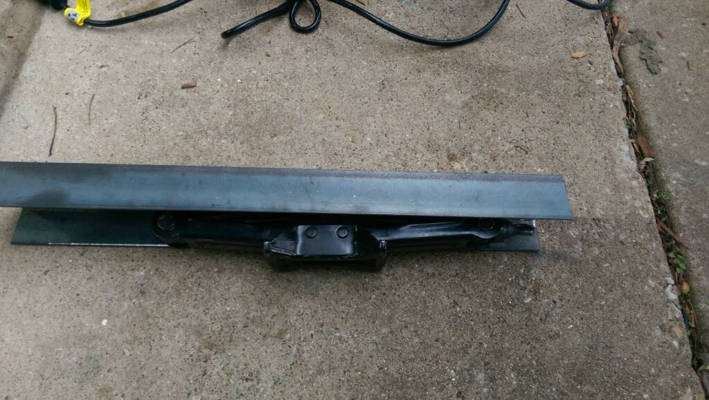

I had two pieces of angle iron that I welded together. Everything I had was on hand just looked around for scrap

The hardest part of finding a lift is one that actually will slide under the bike these big dogs are not very tall!
I've got some ideas to make this much better just need to pick up some more material. I'll keep y'all posted I'll have it done this weekend.
