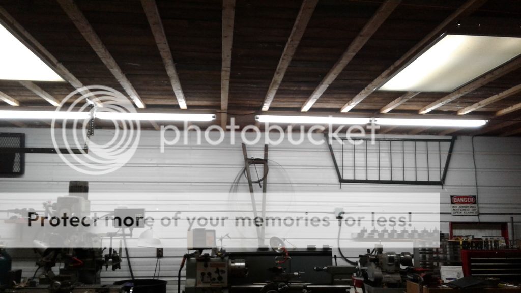

How do you like the LED? I have not done that yet.
Did ya just remove the ballast or change the whole fixture?
I only put new flouresants in a little over 3 years ago in the garage at that time LED was still pricey just in the last year they have come down a lot. I've almost got all the bulbs in the house changed over at this point.

I have four high bay fixture each with six bulbs. I had to completely disassemble the fixtures remove ballast, unwire, remove and disassemble the bulb holder on one side. I cut the little copper connector in half and drilled a little hole for the wire to go in the other side of the connector for the stab lock where it was supposed to be but wasn't. Took me about an hour per fixture after the first one. The light is very different and instantaneous and hopefully I won't have to repair the fixtures every year like I was doing with the florescence. The light will take a little getting used to but I like them and I have no problem seeing my big mess in the garage. I think later today I'm going to go clean on the garage a little bit and get a suntan at the same time.

I put some of the LED's above my machines. These work with the ballast. Super bright, but they mess up my radio.

I think the LED 4' bulbs need to come down a lot more in price before it makes it cost effective to change them out.:yesnod:
I bought 2 from Lowe's and changed one out as a test. I now have light in the dungeon. I bought 4 for the bar that I built for my bus and it is ample light for the barn. They are bright but just a tad pricey
