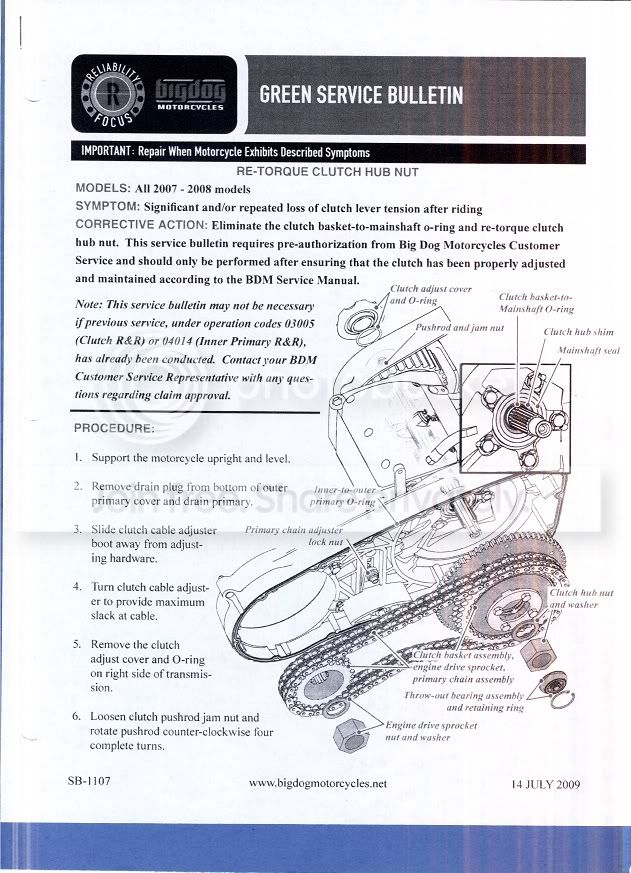

is it possible to leak along the clutch push rod?? thanks to waykool.. for the pict...this might be it... part # 66
Banned
thats what I'm thinking.. there must be 1 on the clutch side.. other wise the clutch push rod would stay lubed...just my thoughts...

May also want to look at the washer behind the clutch hub nut When I pulled the outer primary and clutch basket off to replace the trans main shaft seal, I noticed not only was the little o-ring installed on the shaft damaged but the clutch hub washer was crushed pretty good. Looks like when that o-ring tore it also loosened the clutch assy taking pressure off the trans main shaft seal and allowed trans oil to leak into the primary. There was a TSB a while back that called for the o-ring seal to be removed and looks like it finally caught up to me. I've always had problems with clutch adjustment, getting the bike in neutral at a light, and creeping when stopped. Have to say it's never shifted better, no longer slams into 1st when cold, and getting into neutral is a breeze!!
PHATASS
Yes sir...removed the little o-ring and installed new washer. I'm pretty sure this is what caused the main seal to leak. 2K miles later and stilll no leak and cold shifting and neutral have never been easier!
