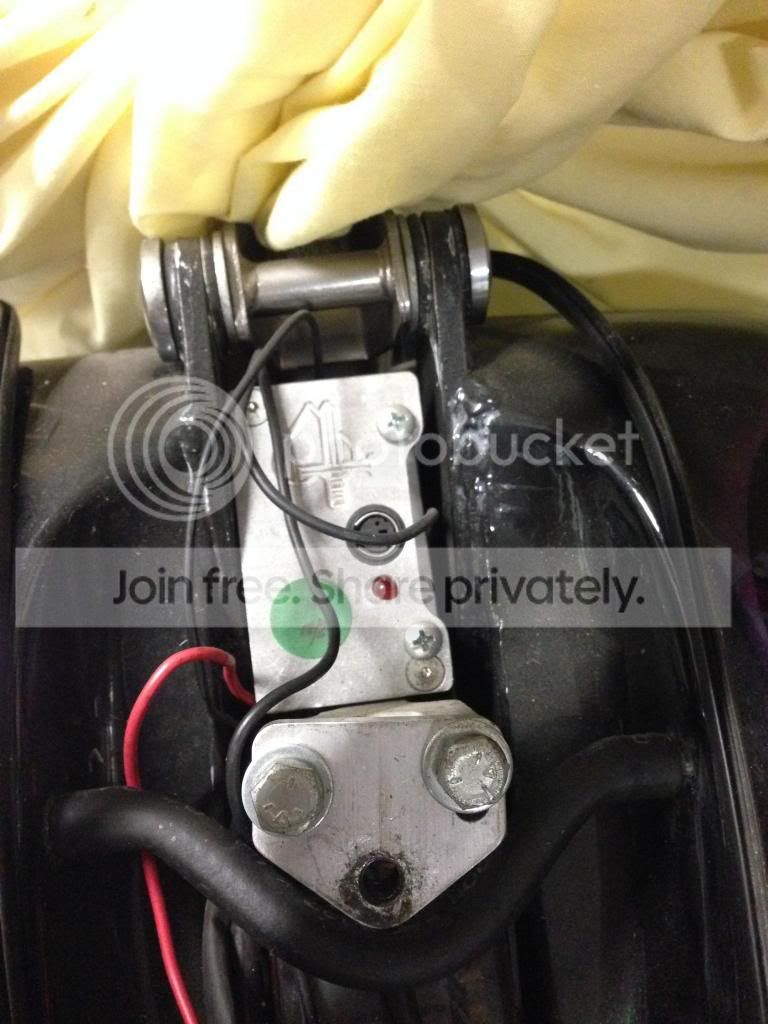

Took the console off for the first time and forgive me since most of the work was done by the dealer before, but I see the ignition control module and the ECH. I am not 100% how the ECH works but I need to know how to test these parts.
Oh, I do here a click from the ECH when I press the start button.
I do NOT have a red light lit up on the ignition module though.
Does the ECH light up or have any indicators?
