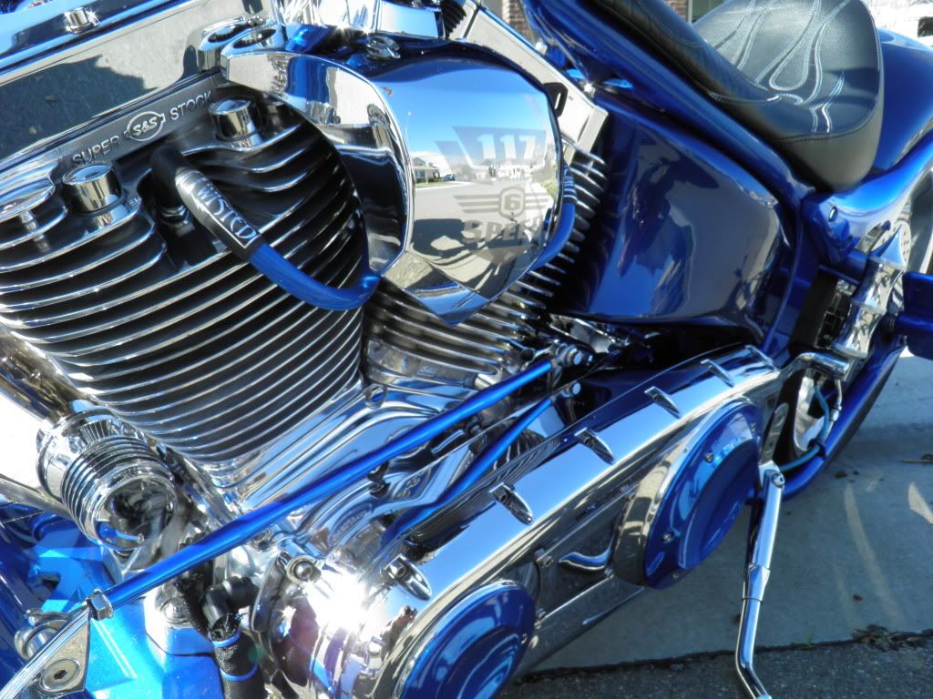

I end up to put my spark wire on but because the ex-wedge engine they are kind of too short. I couldn't run the back cylinder wire from underneath the coil cover because the cover would smash the wire against the engine fin.
Here a picture of what I needed to do to make it fit:
http://www.bigdogbiker.com/photo/data/500/medium/photo-1.jpg
I don't think I liked it though. Maybe I'm gonna sell them or I gonna try to see if I can send them back or see if they can make me some longer ones.
