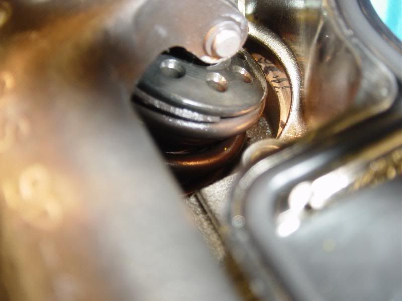

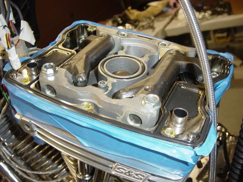

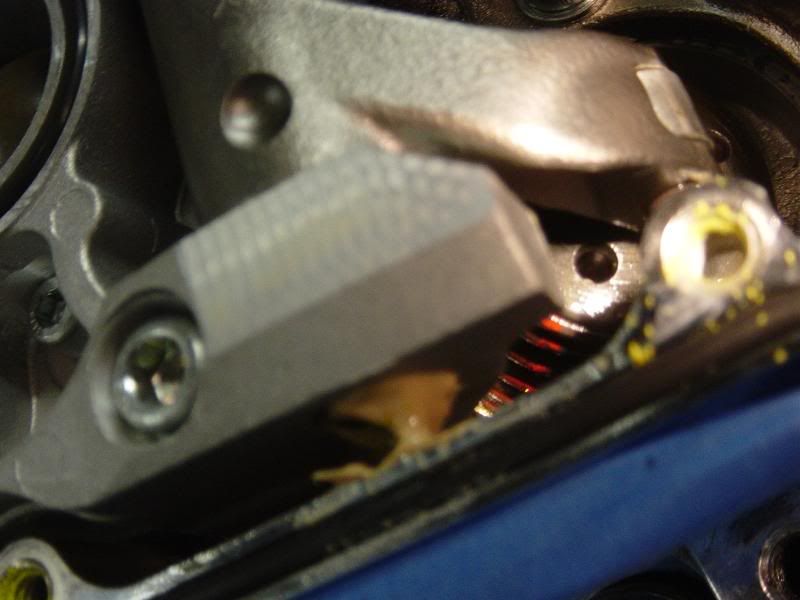

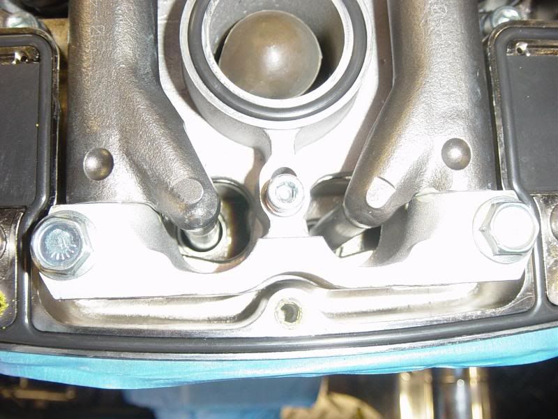

Request out to someone with a new scoot.
Pull one of your rocker boxes off and tell us what type of rockers and springs do you have. In fact, snap a few pics while you are in there in case something else has changed. Inquiring minds want to know. Could make a big difference in a cam upgrade total price.
Thanx....
Neil
Also S&S is using color coded paint marker stripes on the springs to identify the lift capacity. Sorry I don't know what the codes mean but I could possibly find out through a S&S rep. I also think that since S&S is doing all the motor building that it should be better controlled. Another question I would ask is what is the overall cylinder length and what size gaskets are used.
Just pull your rocker box cover and inspect the springs, mine shows 640 springs
