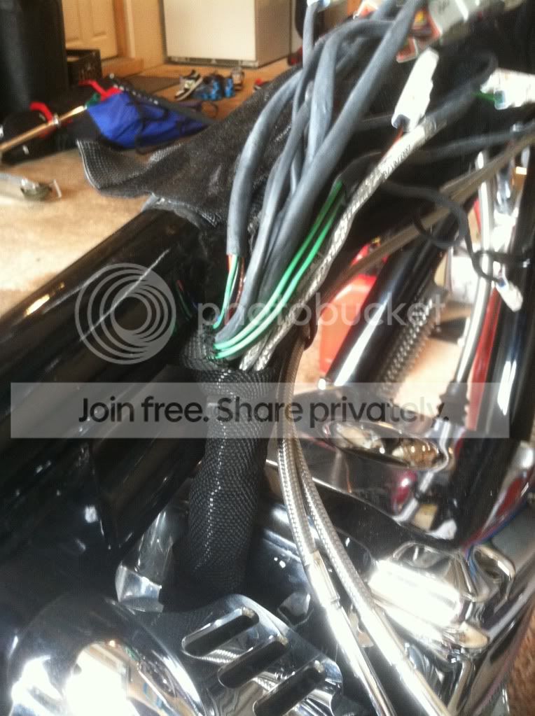

Last week Alphadog and I set out for a 300 mile ride. I had my scoot all cleaned up and ready to go. I then decided to start it up the day before so I could get fuel for our trip. As soon as I turned the ignition key the starter automatically engaged turning the motor over. At the same time the horn started honking and every light on the motorcycle started flashing/blinking. I turned the ignition off immediately and everything stopped. I did this two more times with the same results. I disconnected the battery....connected it and the same problem continued. Just like many others with similar poblems I dreaded thinking about potentially installing a wireplus, pdm, new ehc, etc. The following morning I woke up early because I couldn't sleep and got to work on it chasing grounds or exposed wires.

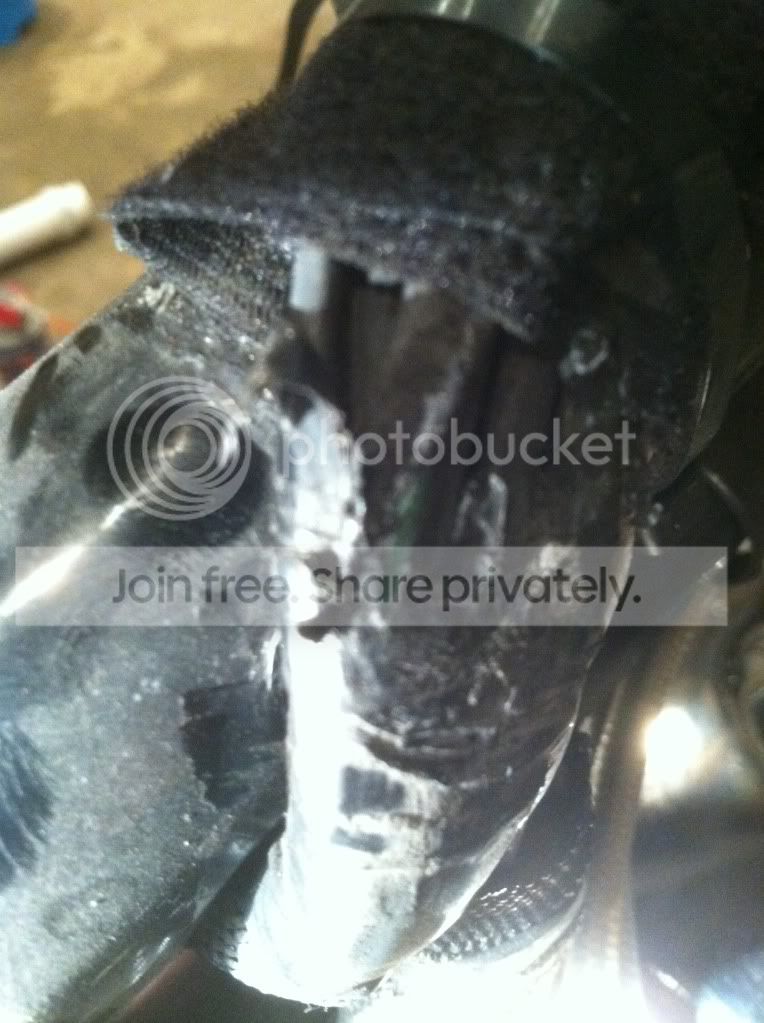

I removed the speedometer and ignition coil but did not see anything that was broken, exposed, or disconnected. I then proceeded to remove the gas tank and right away I noticed an exposed ground wire that was comin off the backbone and down towards the ehc. When I say exposed I mean all the rubber or electrical tape used to wrap the wires together was worn away. Most likely due to the vibration from rubbing against the tank. The ground wire was fully in tact with no signs of wear on it. Just the protective insulation that holds the wires together was gone. I put the ignition coil back on turned the key and the motorcycle was performing its normal routine and appeared to be fine. I didn't bother messing with the ehc by cleaning the pins and putting dielectric grease on because I did it the previous year when I had some down time. I also check wires to the starter and other places.
Here's my big question. Is it possible that the wire was pressed against the tank so hard that it was somehow causing it to ground out, causing this problem. I don't see how it would be possible but I was hoping someone more smarter than me, with an electrical backround could answer this. Or is it possible that this was all coincidence and that I could potentially have further issues to come with the ehc gremlins.
BTW I wrapped the harness wires with industrial grade rubber electrical tape for added protection. Bikes been put back together and I was able to run it for the 300 mile trip. Man I love that bike. Looks, sounds, and runs like an angry beast.
