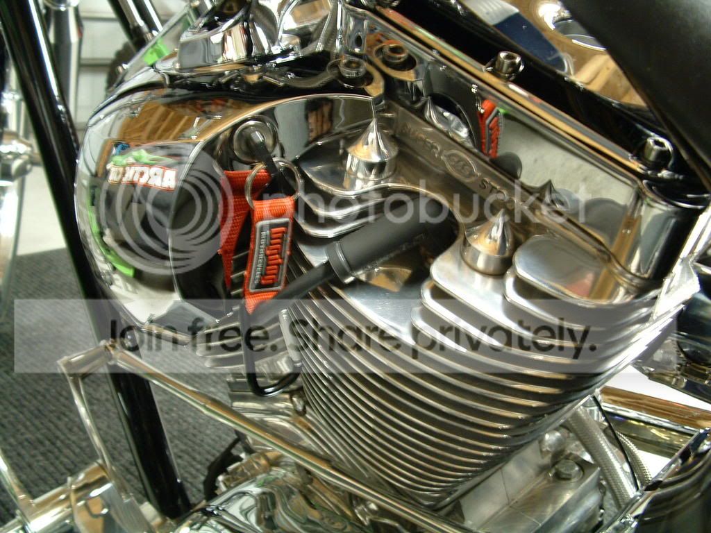

Most of us have the key on a carabiner which we hook onto the plug wire for this reason. Mine has been screwed up for months, but I don't loose the key this way.
Yep... I even do that with my new non bdm key switch
yep.....chacha is talking about this.......this is how I run mine also!:up:

The simplest fix I use is to attach a short loop of cord, black leather strip, etc. to the key, then simply run the loop around the plug wire and the key through the loop. With this, the key can't be lost if it falls out and you simply unloop the key from the plug wire when you get off. Best not to add any weight or metal attachments to the key that will vibrate around.
