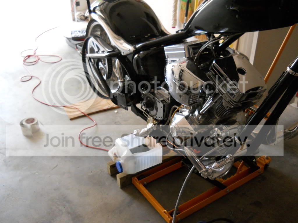

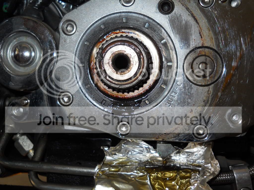

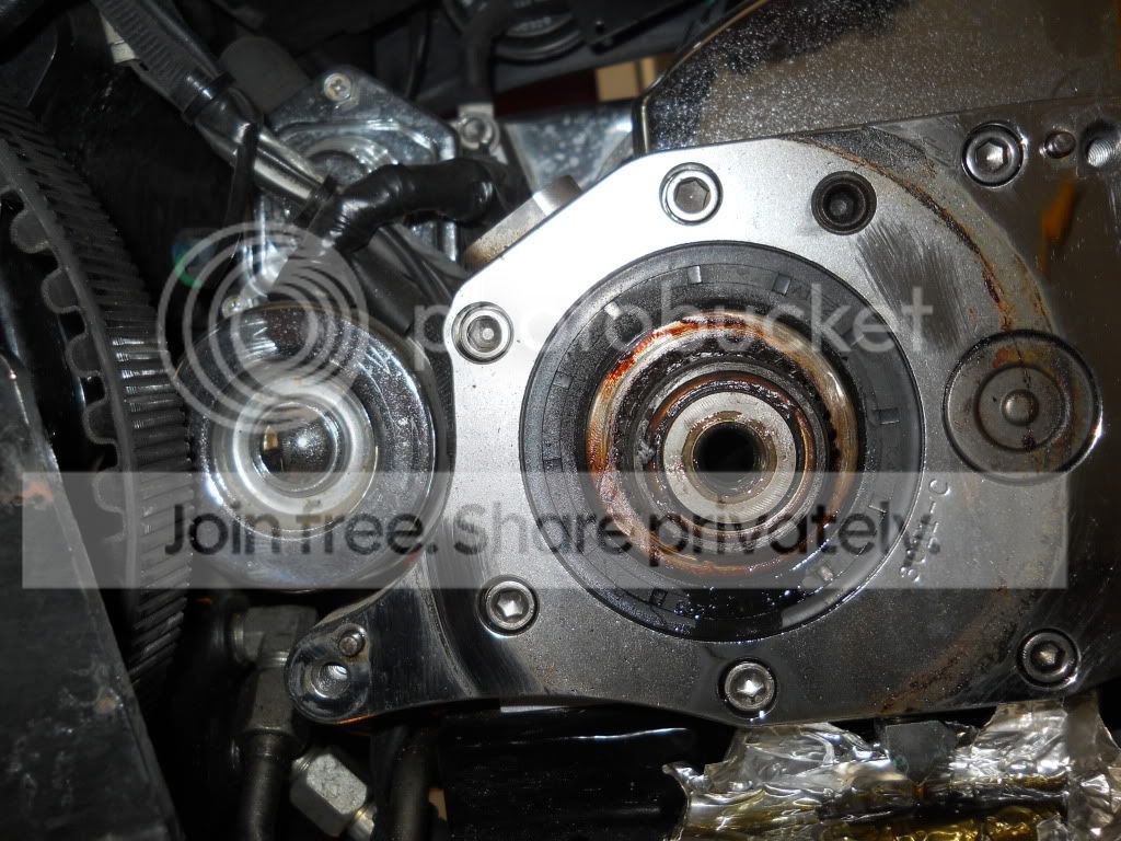

tore down and replaced the drive belt side tranny seal. sure hope it dont leak.......

Yep having my seal and bearings replace for the same thing. Bigdogtech1 is doing mine. Did you have any play in the pulley. My seal was leaking but when I took off the belt and checked my pulley I had play in it.:bang:

the seal i used was Timken 412920....it is a metal seal so i used a little permatex sealer on the edge...
