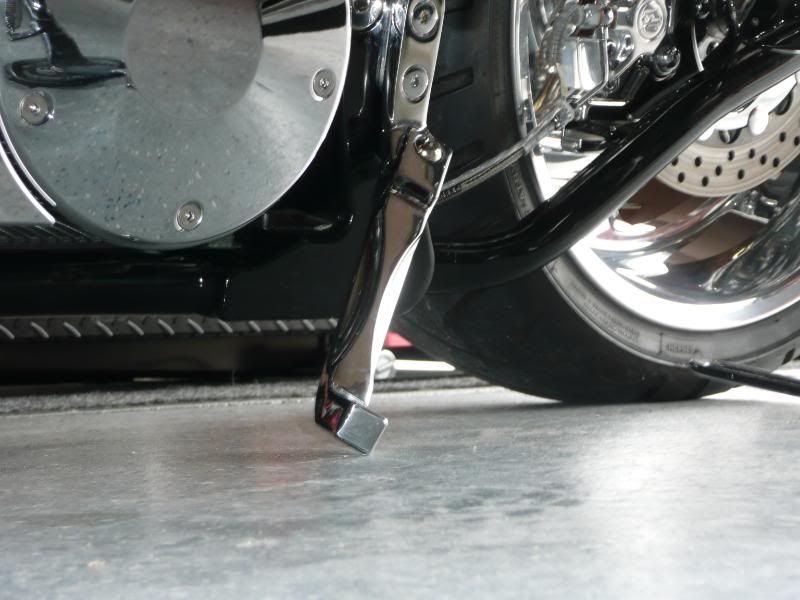

As you can see here i dont have the rad-2 from arlen ness.I cut down the leg apox 1 1/2 in from stock to end up with the lean that i wanted.I used a 3/4x20 thread die.or you can 20x20 metic die they are only a half degree off on thread pitch.I ended up with 7 1/2 from center of pivot bolt to the center of the end of kick stand.I like it.Plus i can go up or down with the leg. 05CHOP

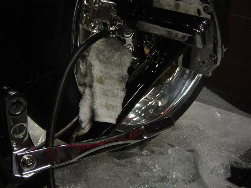

Well I don't have anything but the RadII in the package to show. But its the correct 8" length from bottom of the foot to the center of the pivit bolt.

Gas if you look at the bdm kickstand it tilts up.the arlen ness doesnt.this is why i had to cut the leg down so much.Now im wondering if i should of got the rad 2! i had fun with it after all the bud lite and cigars i had.05chop

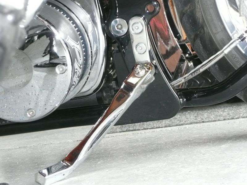

Got the Rad II kickstand on and leaned over... It doesn't sit flat but neither did the BDM one... so that's fine I think

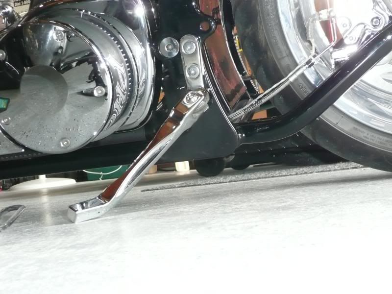

Got a pic of the kickstand on the ground... doesn't sit flat but I think it will be ok. Could shave it flat but for now its fine. Who cares if it leaves some marks... its SOLID as hell. None of that BDM wobble crap. Plus the BDM one never sat flat either!

You can see I re-used the spacer that BDM had... it makes the bike not lean over as much... could remove it and the bike would lean over some increased amount that I won't figure out cause I hate geometry...
