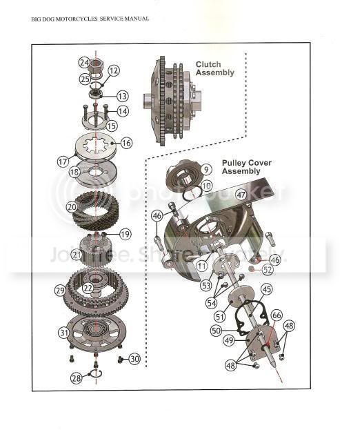

OK here's what I found out Saturday, when I took some new stuff (chrome wheels,chrome belt pulley,chrome speedo housing,pipes) to the shop to be put on my bike.
#1- The bearing in the Carrier(#31) was shot, couldn't order just the bearing so ordered new one.
#2- Part # 21 (don't know name of) the teeth on the inside where the shaft goes thru were shot too. Teeth on the shaft were good tho They said was prolly from where the hub nut came loose. Ordered new one of them too.
Hopefully this should be it and be ready this week :whoop: But who knows :bang:

More bad news. Went over their today to pick up. Had everything put on wheels,pipes.. Rode down the road about 3 miles at around 65 ran fine. Turned around and fired it up and smoked the clutch again:angry: and to beat that when i got back was leaking primary fluid in the same place as before:bang: guess we are going to order the Bandit Cluch (Bandit Machine Works: Clutches and Belt Drives and Related Parts, Tools, and Accessories for Harley Davidson Motorcycles) Don't really know what else to do. 2 clutches 2 rides down the rode:confused: Everything was new in thier too, the Barnett Plates,New Carrier,Inner Clutch Hub from Baker. :cursin: As far as the leaking who the fuck knows....

On the primary oil leak: Mainshaft was warped from Hub nut coming loose(Bakers says if Hub Nut comes loose replace because it could be warped) allowing p.oil to come though the shaft when heavily accelerated
The Inner Hub's(one originally on their plus 1 new one.) were messing up due to the shaft being warped and screwing up the teeth.
