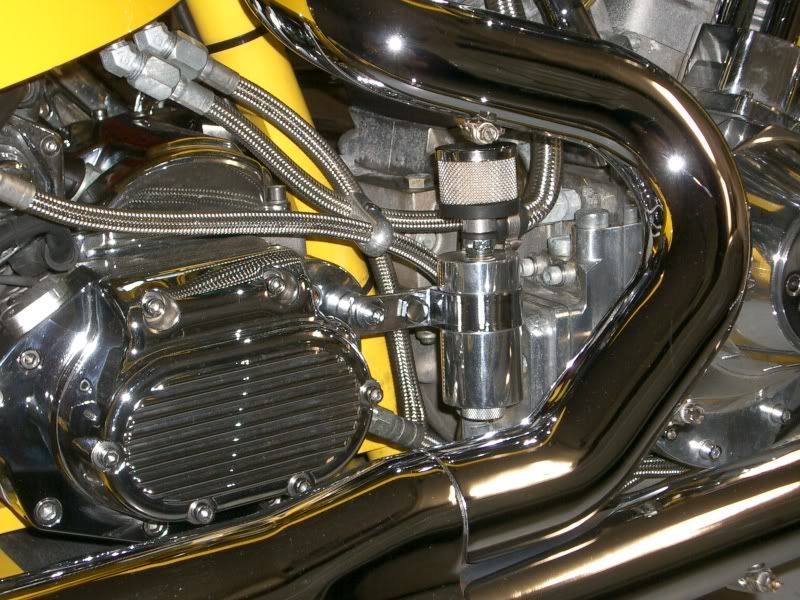

Ok I give .... what is a puke can? I seen a buddy of mine use one but I don't think that's what you guys are talking about. thanks :confused:
lee
it collects oil coming through the engine breather hose (blow by??) - keeps everything clean and tidy and when it gets full you empty it
Here is the one I had on my 03. I got it from Jirah's.
