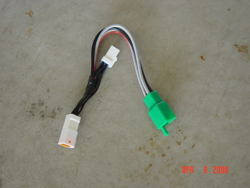

The BDM harness that you showed pluged in the unit above

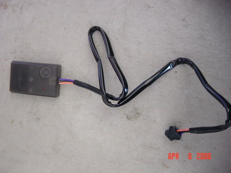

perimeter
ignition/starter kill (really just a relay controled by the alarm unit)

For the bdm harness all you have to do is pull this harness that connects to your tail lights.
Open it and basically the new added harness goes inline

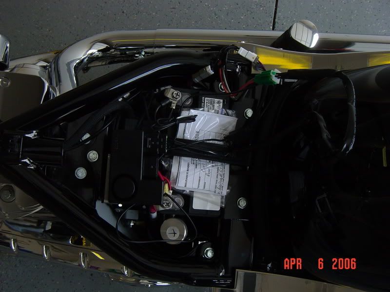

Now you have this ball of wiring and mess hanging outside the side of the bike.

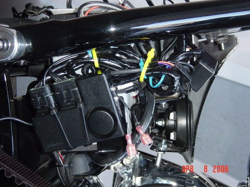

Zip tie the wires together to help organize the rat's nest.
I relocated the horn to the front and zip tied the alarm to the horns bracket. Now granted later I moved the alarm to a new bracket under the cowl area.
Now button everything up.
