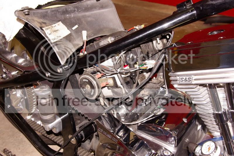

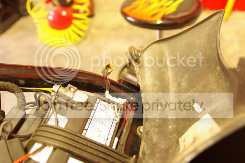

In this picture you see the new bracket on the headlight shell. The triple tree post shows two bolts on each side of it. One of these broke off on mine. You see the small portion of threads that I removed from the post and I believe this is what cause the bracket to break. The replacement bolts are stainless steel and should be stronger.

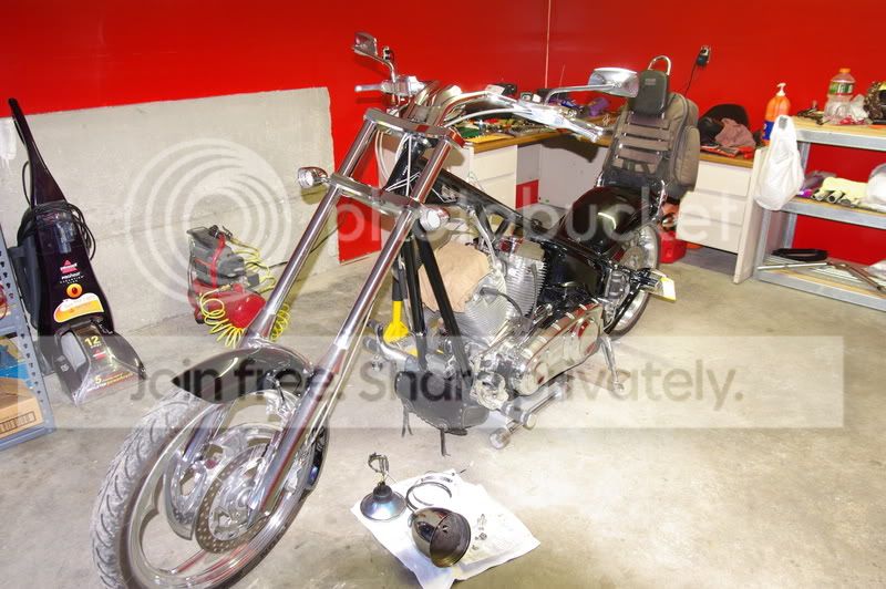

Here is a picture of the bikes upper end stripped down. I'm going through all the connectors re-filling them with die-electric grease and re-routing lines.

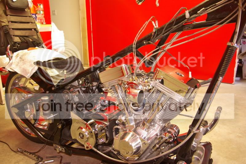

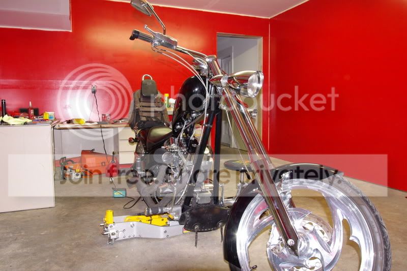

Couldn't have asked for any better. After dis-assembling a lot of components and putting everything back together especially all the wiring it just fired up on the first stroke. Didn't even have to prime the carb!
