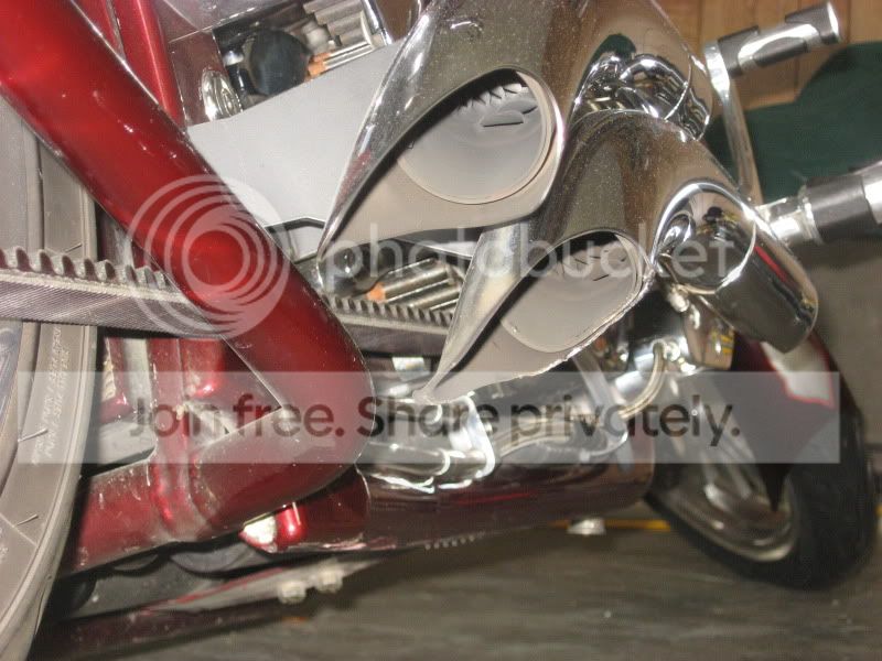

K-9 Scratches Very Bad
I have only had my 07 K-9 for a couple of weeks and was a little shocked when I saw the frame damage from scrapeing. I believe some of it was caused by some speed bumps near my place of work. I don't have the painting tools to sand the frame down and do the job right. My goal here was to just try something to keep the chipped paint from chipping even more and of course to stop the corrosion of the bare metal.
1) First I used automotive touch up paint on the bare areas and let dry
2) Cut strips of grip tape and rounded the edges
3) Wiped frame down with degreaser and applied the grip tape
4) Hopefully the tape will stay on as its made for Truck running boards etc.
My goal here is to lessen the damage of future scrapes in hopes that the very rough tape will take some of the beating and save some of the paint. If I scrape again, I can just replace the tape. I thought this might be an easier approach than trying to paint it with undercoating etc. The tape is not noticeable when walking around the bike. Anyway we will see it this works out....
